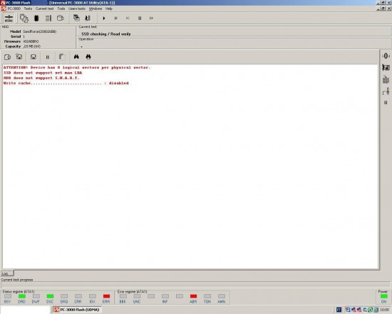

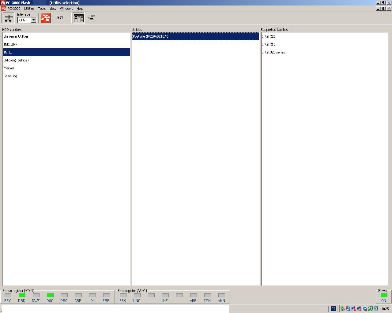

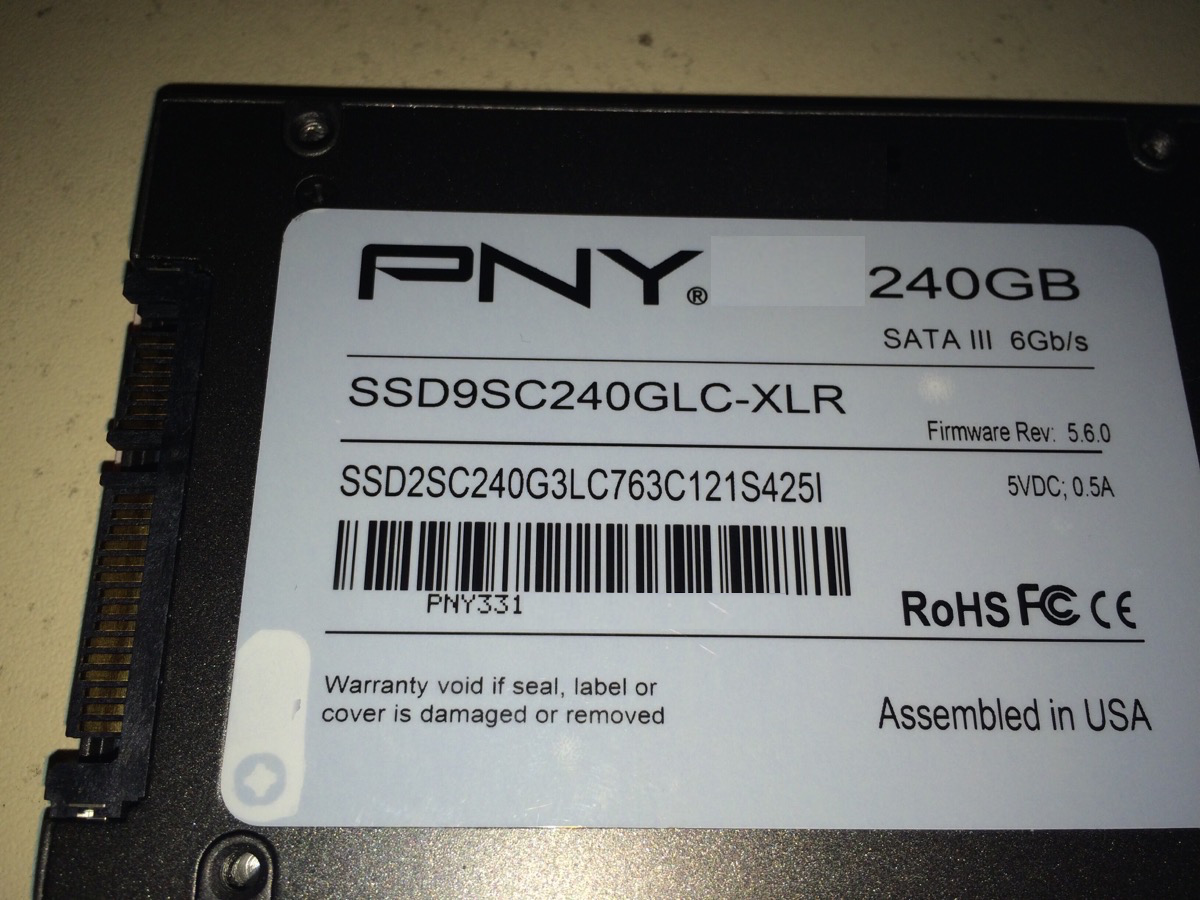

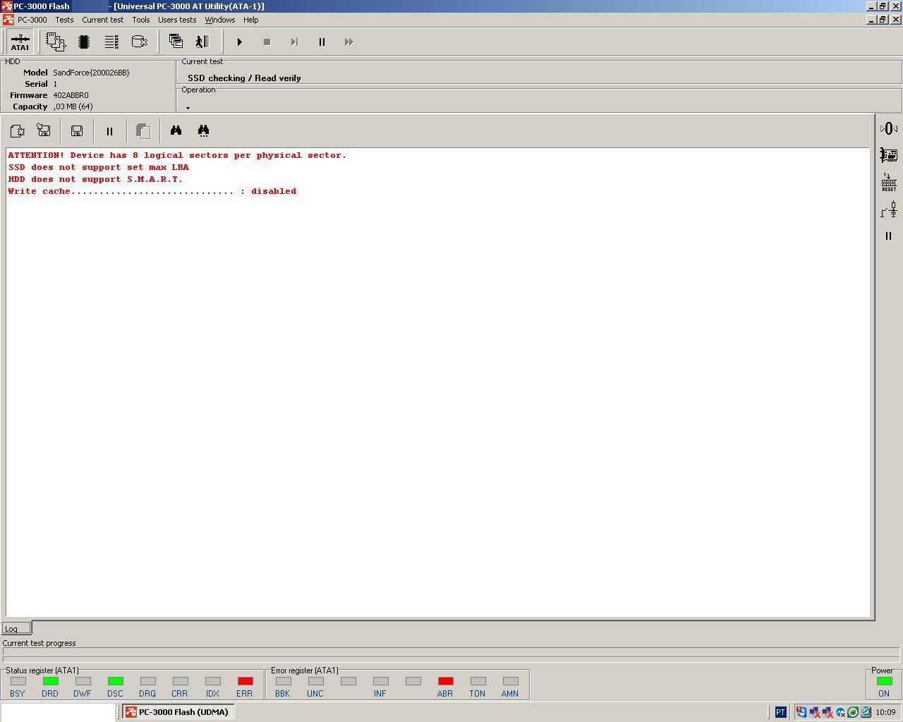

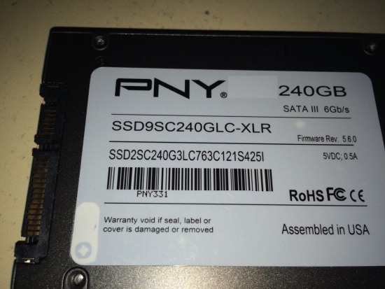

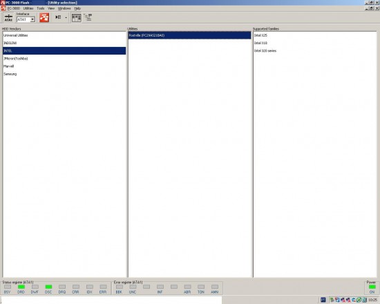

Hello!! :mrgreen:
Is problem ! :shock:
Please look photos!
HELP-ME? :idea:
Wait reply!
Thanks!!!

 Post subject: Re: SSD PNY 240GB SSD9SC240GLC-XLR
PostPosted: September 10th, 2015, 12:09
Posts: 922
It is Sandforce, probably no solution :(
PostPosted: September 11th, 2015, 8:15
Posts: 456
If this SSD is actually Sandforce-based, then problem is properly implemented strong encryption with long random key, which is lost due to controller failure.
PostPosted: September 11th, 2015, 12:26
Posts: 4011
It is why everyone that I know that knows even the slightest thing about DR, or for that matter Tech in general, will advise against going anywhere near a Sandforce based SSD.
Sure the features may be fine when it is working, but when that puppy decides to have a coronary, game over.
