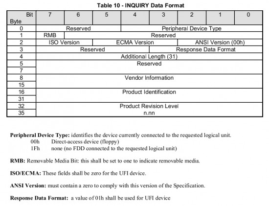

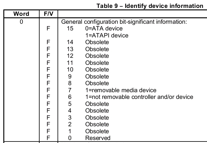

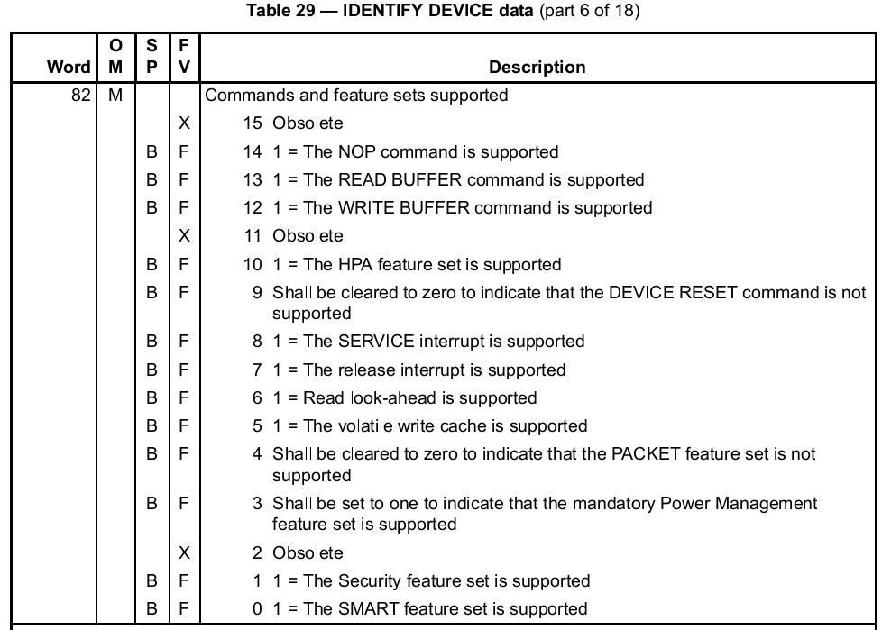

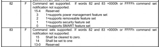

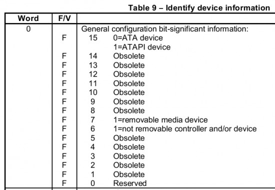

ISTM that the term "removable" is ambiguous in that it can describe numerous dissimilar storage devices. A removable CF card is not the same thing as a removable USB mass storage device.
The ATA/ATAPI standard describes two types of devices, ATA and ATAPI. ATA devices are things such as HDDs and SSDs whereas ATAPI devices are optical drives, magnetic tapes and the like. ATA devices use ATA commands whereas ATAPI devices use SCSI commands which are encapsulated within an ATA PACKET command.
In the case of ATAPI devices, the "removable bit" is bit #15 (and #14) of word #0 of the Identify Device information block. An ATA device clears this bit whereas an ATAPI device sets it. AFAICT, the problem is that a CF card uses ATA commands (with CFA extensions), but identifies itself as an ATAPI device.
IIUC SanDisk's ATCFWCHG tool attempts to modify this Identify Device bit in the card's firmware. ISTM that this tool should be run in a real DOS environment, not from a Windows DOS box. Even then, it may be that this tool is not universal, ie it may be restricted to "Athens" flash controllers ???

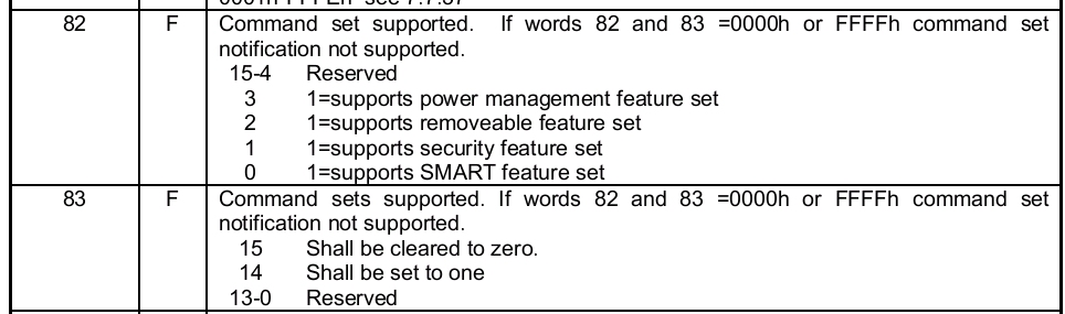

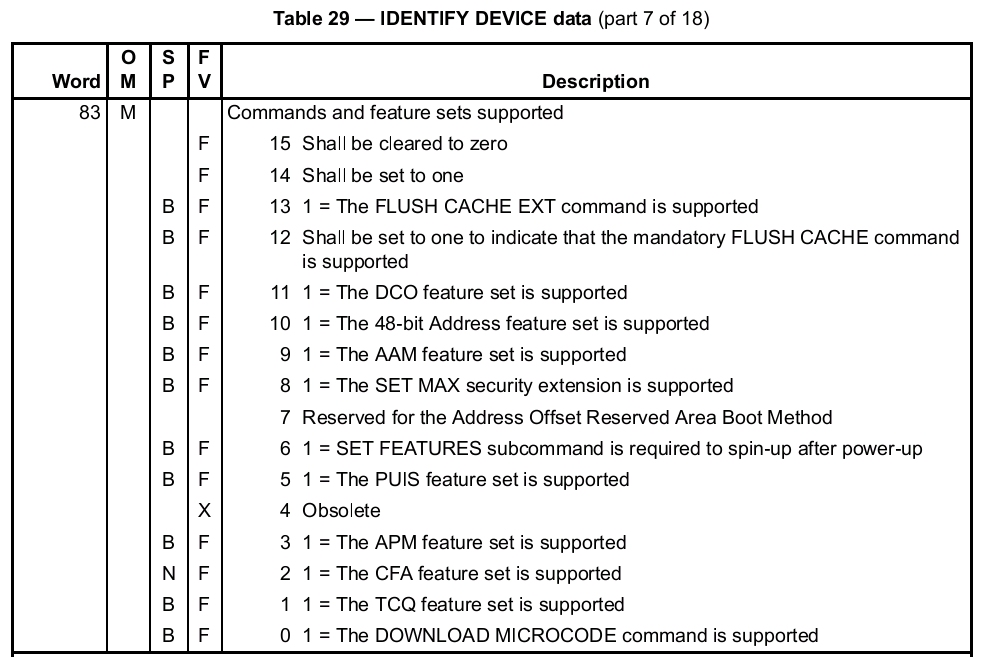

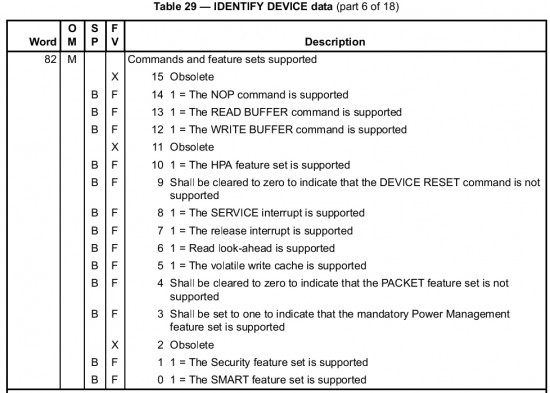

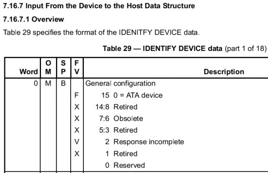

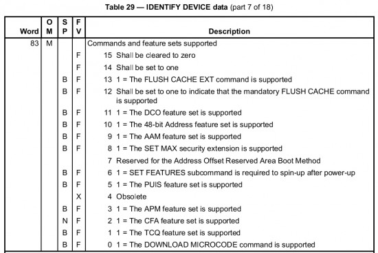

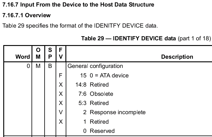

I expect that SanDisk's CF card would behave exactly as the ATA/ATAPI standard mandates.
Here are excerpts from the standard:
7.16.7.2 Word 0 [of Identify Device data]: General configuration
If the device is an ATA device, then bit 15 shall be cleared to zero.
Devices supporting the CFA [CompactFlash Association] feature set shall place the value 848Ah in word 0.
7.17.6.2 Word 0 [of Identify Packet Device data]: General configuration
Bits (15:14) of word 0 indicate the type of device. Bit 15 shall be set to one and bit 14 shall be cleared to zero to indicate the device is an ATAPI device.
Bits (12:8) of word 0 indicate the command set used by the device. This value follows the peripheral device type as defined in SPC-4 (e.g., 05h indicates a CD/DVD device)

The data are little-endian, so word 0 is 427Ah for the HDD (an ATA device) and 85C0h for the DVD (an ATAPI device).

I'm finding the term, "removable", to be very confusing, but I think I understand the problem a little better now.
Version 3 of the ATA/ATAPI standard provided a "removable media device" indicator in bit 7 of word 0 of the Identify Device data, but this was rendered obsolete in more recent standards. CF cards now identify themselves with a value of 848Ah in word 0. This means that older software will see them as ATAPI devices (bit 0 = 1) with removable media (bit 7 = 1). I can't see how that makes any sense.
Bit 2 of word 82 in ATA-3 enabled a device to report that it supported the removable feature set (eg DOOR LOCK, DOOR UNLOCK, MEDIA EJECT), but by ATA-8 this bit was obsolete.
Bit 2 of word 83 in ATA-8 indicates whether the device supports the CFA feature set, but the same bit was reserved in ATA-3.

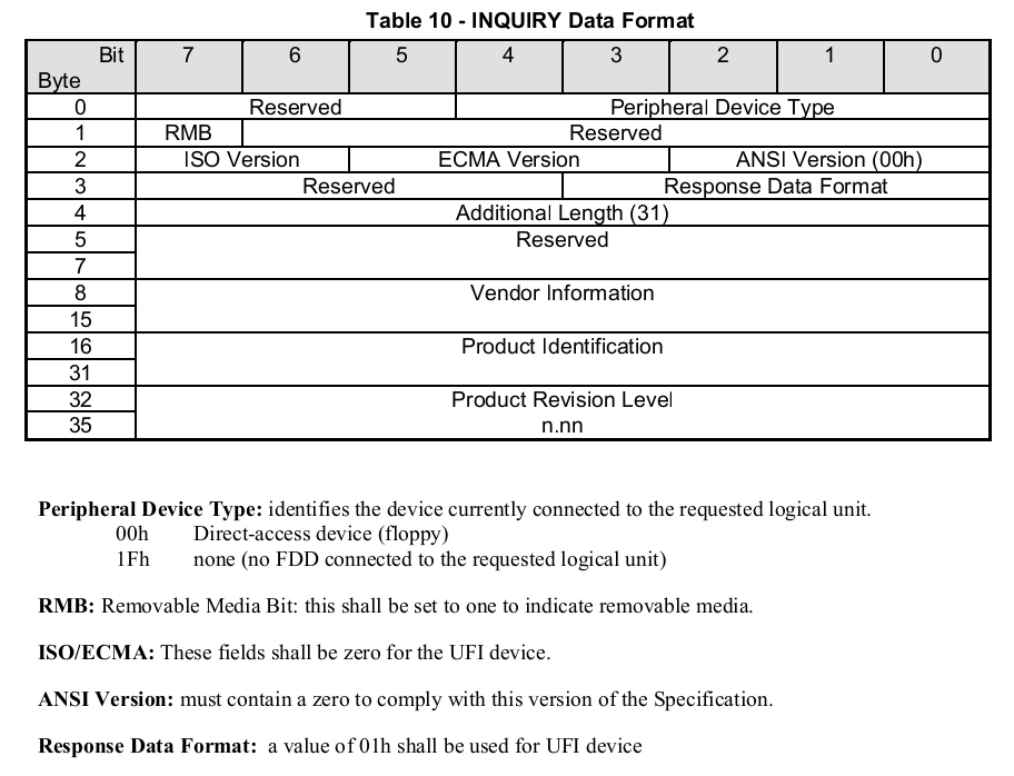

I'm not sure what Partition Guru does to convert a USB drive to "HDD mode", but I suspect it may use the SCSI MODE SELECT command to flip the Removable Media Bit (RMB), assuming that is possible. USB mass storage devices use a SCSI command set and identify themselves via the INQUIRY command. Bit 7 of byte 1 is the RMB.

What does look interesting is the Firmware HDX9.03 line. Time to ask SanDisk, if the provide updates on their firmware, because that would give us the flash tool for flashing it... :)
I see how that make sense. It is necessary to change the identify value of the device. Replacing the 848Ah value at word 0 with that, witch set (even being obsolete) bit to 0 in firmware could be the end of all the hassles and problems and headaches for thousads of users around the world.
This is clearly for CDROM/DVDROMs.
No idea either. But in the HDAT2 I noticed option, that change the values set on the CF card (ATA device) back to default on device reset. What if that will be disabled and the bit is flipped? Should not that made a permament change...?

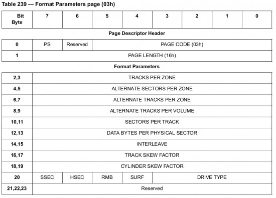

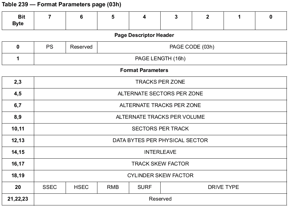

@trodas, I suspect that you will not find a firmware solution to your problem, but at least now you can avoid wasting your efforts on inappropriate solutions such as the USB tools.
Anyway, I think I know how Partition Guru converts a USB drive from removable to fixed.
Here is the structure of the Format Parameters page (03h):
Bit 5 of byte 20 is the RMB. Seagate's SCSI reference states that this bit is not changeable for their HDDs. I wonder if this is universally true for USB flash drives, or perhaps there are some that allow modification. AIUI, this would be done via the MODE SELECT command, and the FORMAT UNIT command would then apply the changes. That could explain why the documentation for the Lexar tool and Partition Guru both state that the procedure is data destructive.

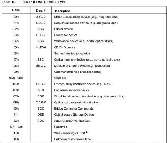

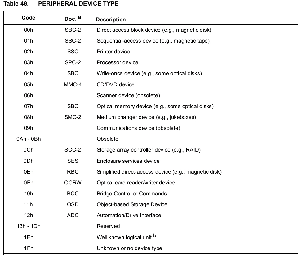

I notice that the peripheral device type reported by Identify Device is 04h. The SCSI standard assigns this code to "Write-once device (eg some optical disks)". So we have an ATA device with fixed media that identifies itself as a write-once ATAPI device with removable media. Can someone make any sense of that?
SCSI Commands Reference Manual:
http://www.seagate.com/files/staticfile ... 93068h.pdf
