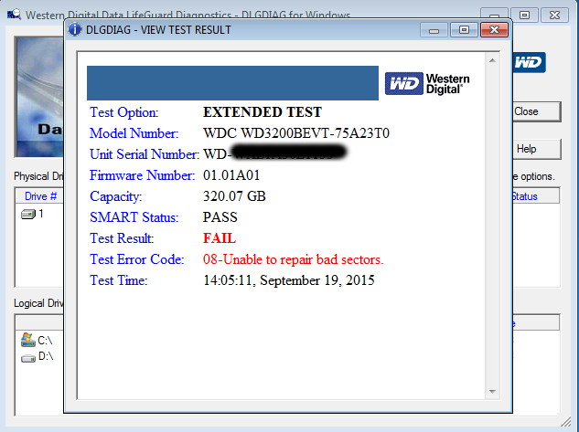

Hello.
I have a Dell Notebook with WD 320 GB HDD but my HDD have bad Sectors and can't repaired. any idea? I use WD tool for test and repair but it told me that can't fixed. I Attached a picture.
Any idea?
Thank you.

Copy the data onto another hard drive before it fails...

Hey there hack3rcon,
The WD Data Lifeguard Diagnostic tool indicates that your drive has too many bad sectors and is prone to failure. it is strongly recommended that you back up your data from that drive as soon as possible and consider replacing it. If the drive is under warranty you can apply for our RMA procedure and get the drive replaced: http://products.wdc.com/support/kb.ashx?id=mOeH89
Feel free to ask if you happen to have questions :)
