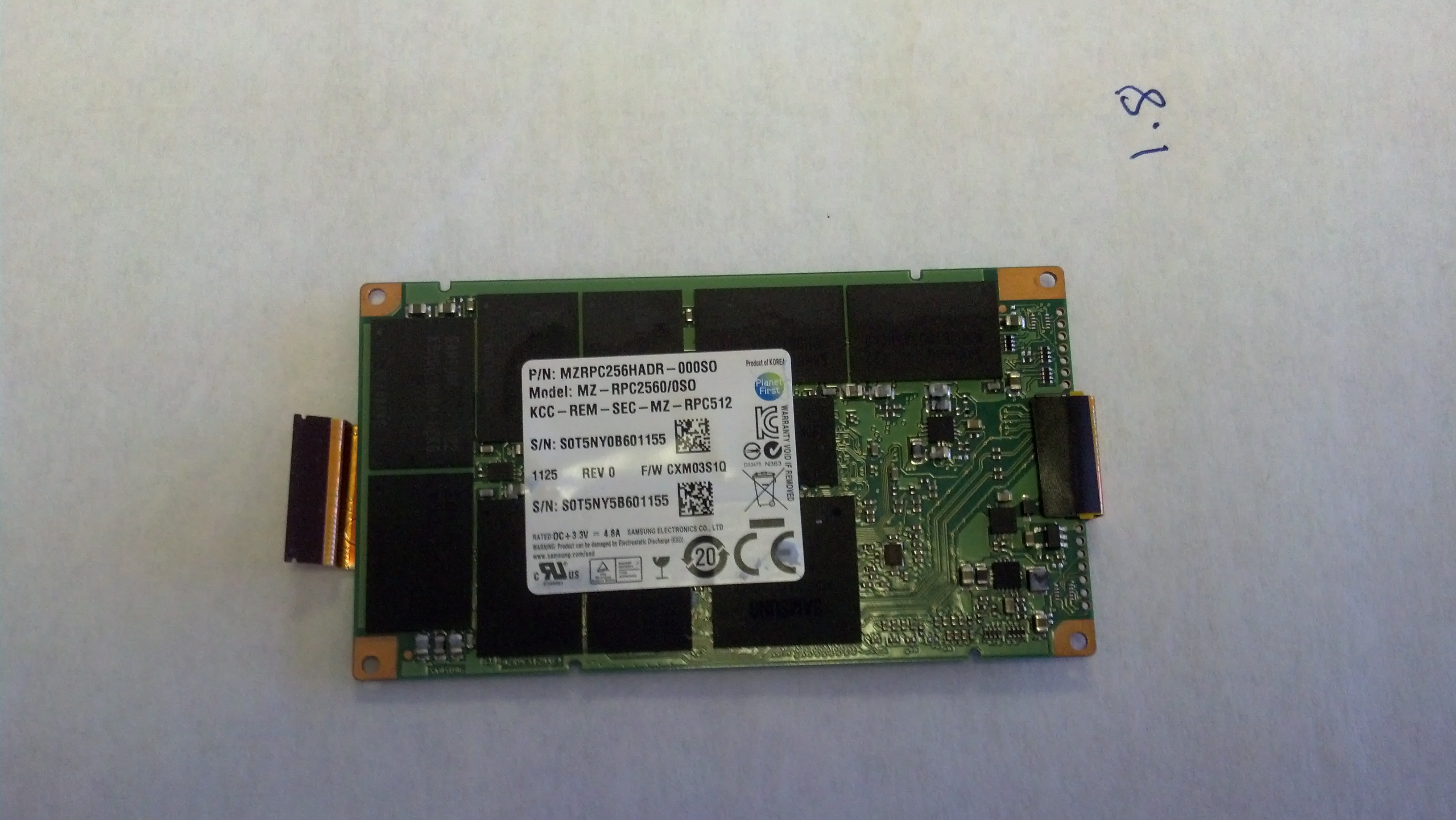

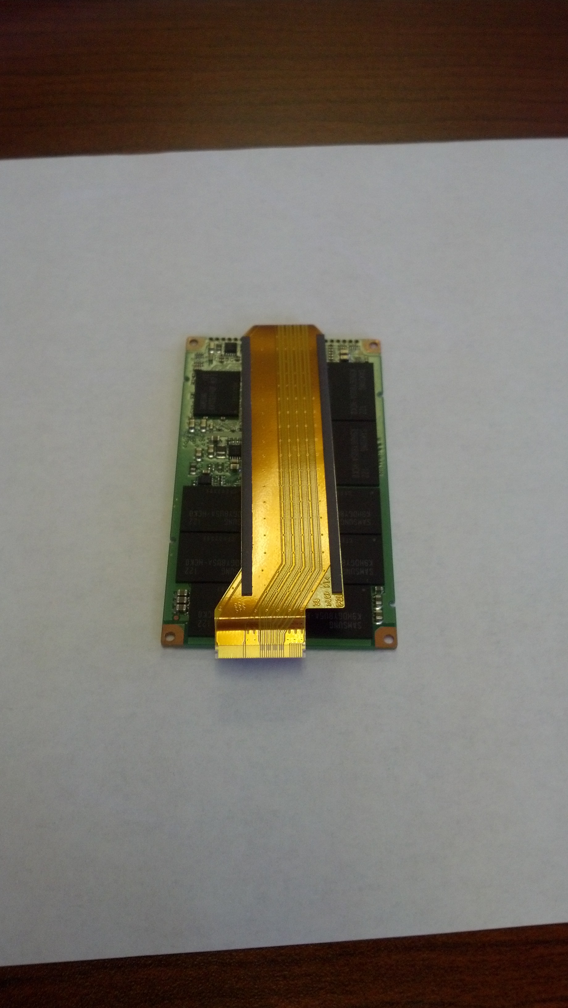

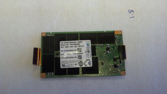

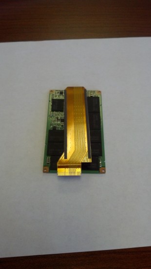

I dropped my Sony laptop with a 512 gb Solid State Drive and am having a hard time finding an enclosure or some type of work around that will allow me to recovery my data. My last backup was probably three months ago and really need some of the more recent data. I attached two photos. One shows the connector which appears to me to have a 20 pin connector. I have spent the last week looking for something, but have not been successful. The part number is mzrpc256hadr-000so
Any help will be great appreciated.

I'm pretty sure that this is a lot more complex than you think. I haven't researched it and am not 100% sure, but am 98% sure that this is two 256GB SSDs in RAID 0 on the same backplane, using the single cable. As such, I don't believe that you are going to have any luck finding an adapter.
Option 1 - Buy another laptop of the same model, switch the drives and hope it works.
Option 2 - Get your laptop fixed
Option 3 - Pay someone to recover the data, knowing that they likely will have to do Option 1 for you at a price higher than the cost of the necessary laptop needed to do the job

Yes, it looks similar. Probably drive work as RAID0 2x256MB.

I have recovered quite a few of these...
You guys are right it is an SSD raid 0 ... 2 SSDs per PCB(1 each side)
some Z series come fitted with 2 units making a 4 disk Raid 0
I have made up an interface jig..
Basically if the laptop is dead or can not be used for the process, (ie lots of bad sectors)
then the jig must be used.. I image them 1 at a time and then rebuild the raid accordingly from disk images.
If the SSD is really bad then connect the jig to your DE or credible Disk imager.
