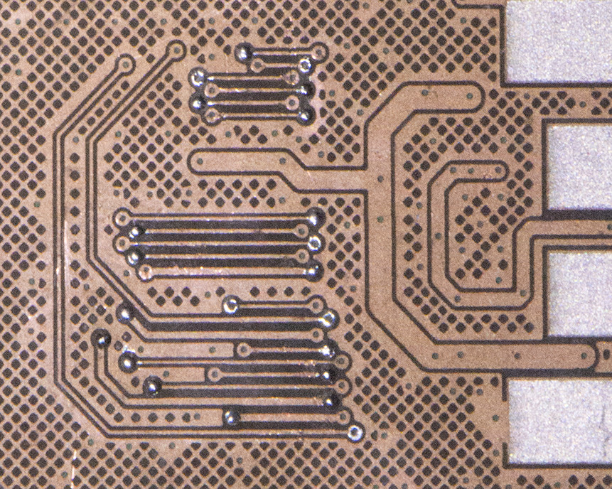

Since others think soldering monolithic's by hand is a better approach (I still like my way better) I decided to give it a try and got a microscope. Arvika says it takes him 15 minutes, it takes me a little longer but I guess that's practice.. Does this look okay? Any suggestions? Ruffing up the via a little with a scalpel helps the solder adhere better. Working w/ the thin wire is still a PITA. Need to figure out a better way to strip the coating and tin the wire. Otherwise it seems to work.

still takes me longer than 15 mins, but I don't rush and usually have other things going on. Looks fine. I have found the single most painful part is getting the solder to stick to the end of the wire. Seems to not want to stick if it has been messed with heating up for too long. I think this boils down to the type of wire.

Jeremy, I do not see flux on your photo. It is one of the key. Without flux you will have problem with shorts.
Here you have Ace video: https://www.youtube.com/watch?v=tIU6cxIj1XM
IMHO almost everything is done wrong on this film ;) so just try other way. 3-4 pad/15 minutes. It is huge pads, not small one or traces.

Looks like they're using sparkle paste, I'm not a huge fan of that stuff, soldering pads that big doesn't require much skill.
Lol, I used flux remover to clean the monolithic for the picture. I find using flux degrades the quality of the PCB making it easier to lift traces off the board (severity differs depending of type of flux). I use small amounts, either the flux inside the core of my solder or applying some to the tip of my wire before soldering it. I don't drench my PCB in it.
I don't generally have issues w/ shorts but if I do flux is the solution. Eg: The picture was after wires were attached and removed, no shorts, very little flux was used..

New personal best, 1.7min per pin (20 total). Which includes everything, stripping the wire then soldering it to the monolith and breakout PCB.
All soldering was done to the Vias, no contact with the thin traces or copper fill, no flux (besides in solder core) was used. With more practice I think I can get that number down to ~1.2. Using a stereo microscope really helps, great idea. :-)
I still like sockets but soldering is interesting..
