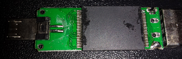

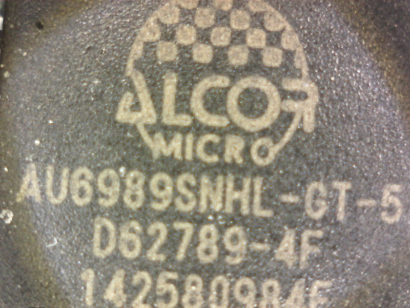

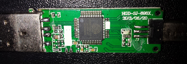

I make foto of USB flash from bouth side... and good foto of chip with all marks

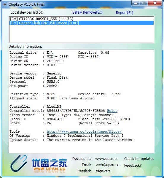

Chipeasy gives some information (hope so)

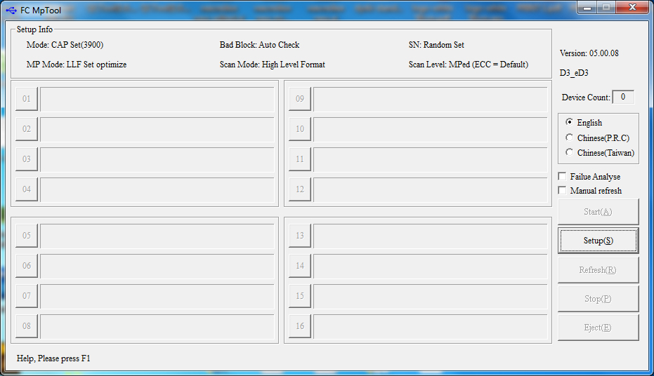

MP tool gives nothing...

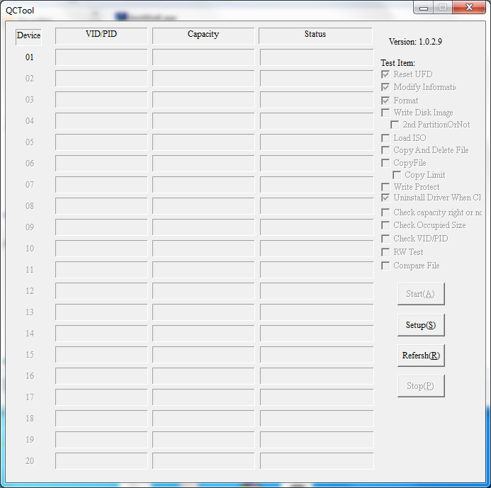

In QC Tool (bouth version 1.0.2.8 and 1.0.2.9) u can see that there is firs divce seems active. If i press that 1 there apears menu with not activ buttons Start Stop Refresh.

the chip certainly appears to be 16GB

agree, a NAND chip with no branding is like a built in dodgy alert, and a flash device with no branding is the same usually.
Another thing - those wider TSOP48's. I'm not sure what the deal is with them, I haven't seen them in anything but flash drives that commonly always have wildly different components - usually refurbished. Out of my 400 -500 research flash devices that are TSOPs, I have 5 of these wide ones. None of them have a manufacturer name, but all have part numbers.. the part numbers are fairly strange. not really sure what these are and why they made them a touch bigger than a regular TSOP.
