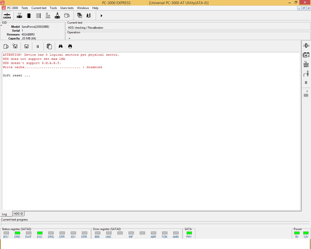

Hello!! :mrgreen:
Please help me!
look log and print screen!
Thanks!!
CONFIGURATION GENERAL INFORMATION:

http://forum.hddguru.com/viewtopic.php?f=10&t=31929#p221571

Dmitri probably meant to say viewtopic.php?f=10&t=31929&p=221571#p221571
Dmitri wrote:
If this SSD is actually Sandforce-based, then problem is properly implemented strong encryption with long random key, which is lost due to controller failure.
