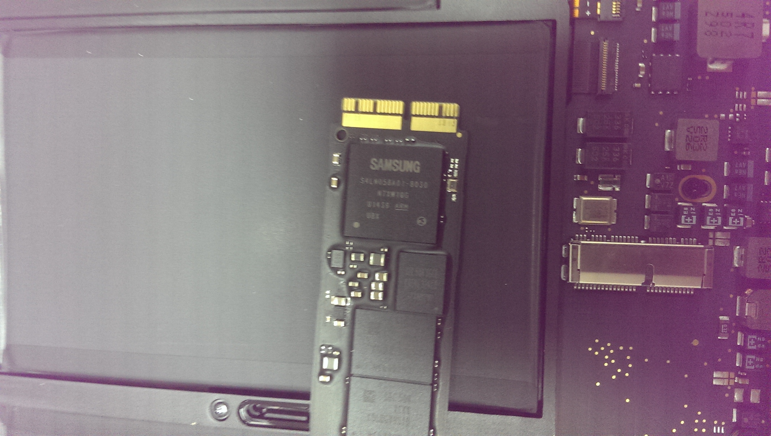

Hi
I'm looking for a caddy or enclosure to connect my SSD drive externally or even internally for my desktop maybe PCI-e expansion card? I've had a look around the internet but can't see anything to fit. I would prefer to get parts from the UK, time is a factor. The SSD is Model MZ-jpv128r/0a2. Any help or information on this would be much appreciated. Ive attached an image of the interface.
Rob
 Post subject: Re: SSD Caddy/Enclosure
PostPosted: October 28th, 2015, 9:23
I believe this is what you're looking for: http://www.pc-adapter.net/products/747.html
I don't think you'll find any in the UK, as I'm pretty sure this is the only place that makes an adapter for it.
Besides the SSD model, could you also mention the notebook model (LNNNN or LLNNN)?

Posts: 6
Model number A1466

Posts: 456
Rob1977 wrote:
Is it just that one card from China?
For this model choice is very limited at the moment.
I would also love to find a SATA adapter for our internal recovery experiments with these SSDs. With PCIe one system hangs too frequently.

Posts: 3977
This is the one I bought, works well, used extensively for 2 weeks straight and no issues.

Location: Austria / Europe
These SSD are out of / for Apple MacBooks from mid 2013 up to now.
I have digged in the internet the last weeks and this is the result:
- the adapter shown by PCIMAGE,
- then there is a USB 3.0 case from OWC = OWCMAU3ENPRPCI
. (be carefull only to check for this type) costs around $ 150,-
- and the optional adapter from Atola for the Atola Insight Forensic

Posts: 6
Hi, this card worked for me, didn't have a PCI-4x slot but it fits in a 16x fine. Thanks for help.
