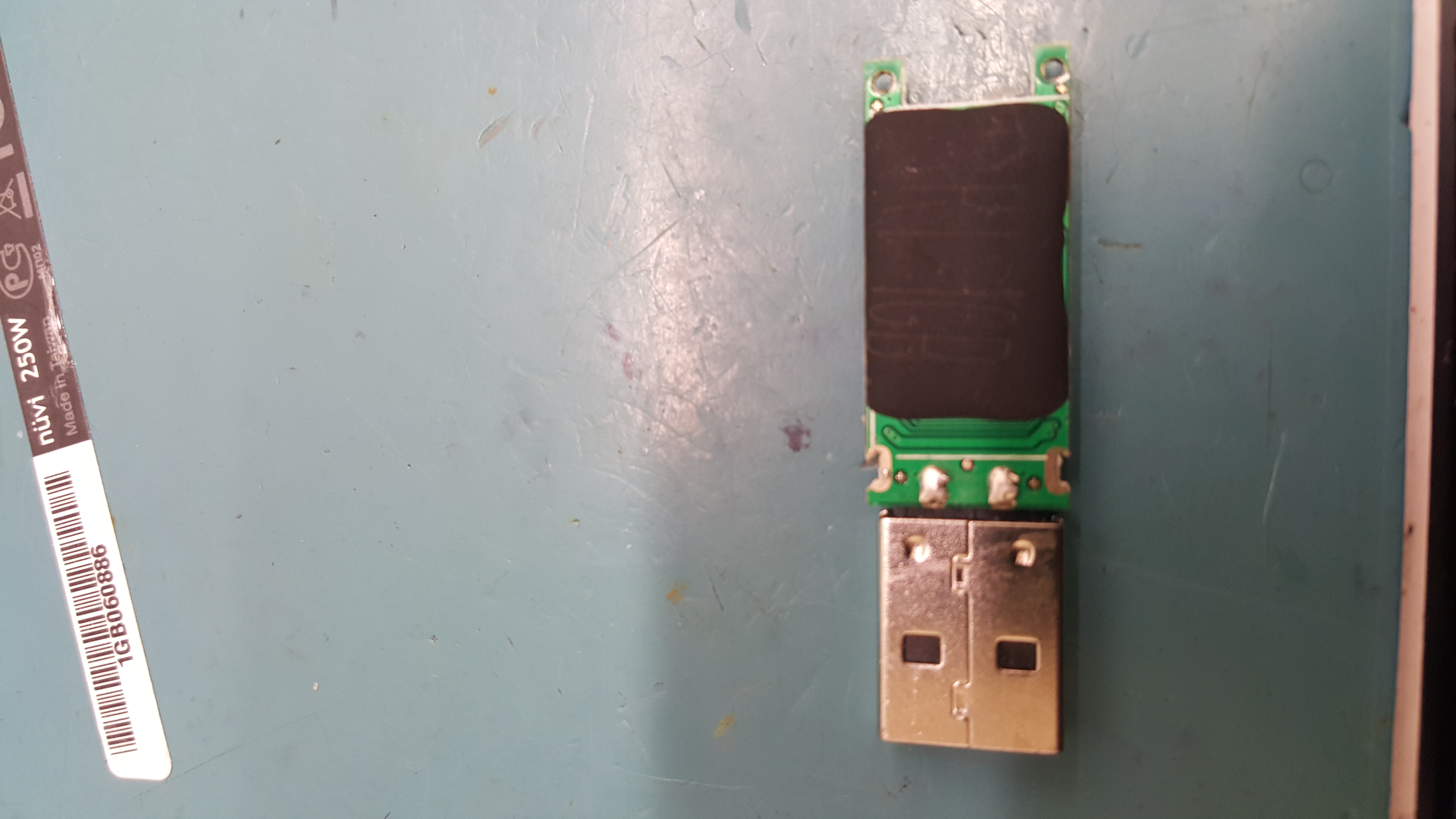

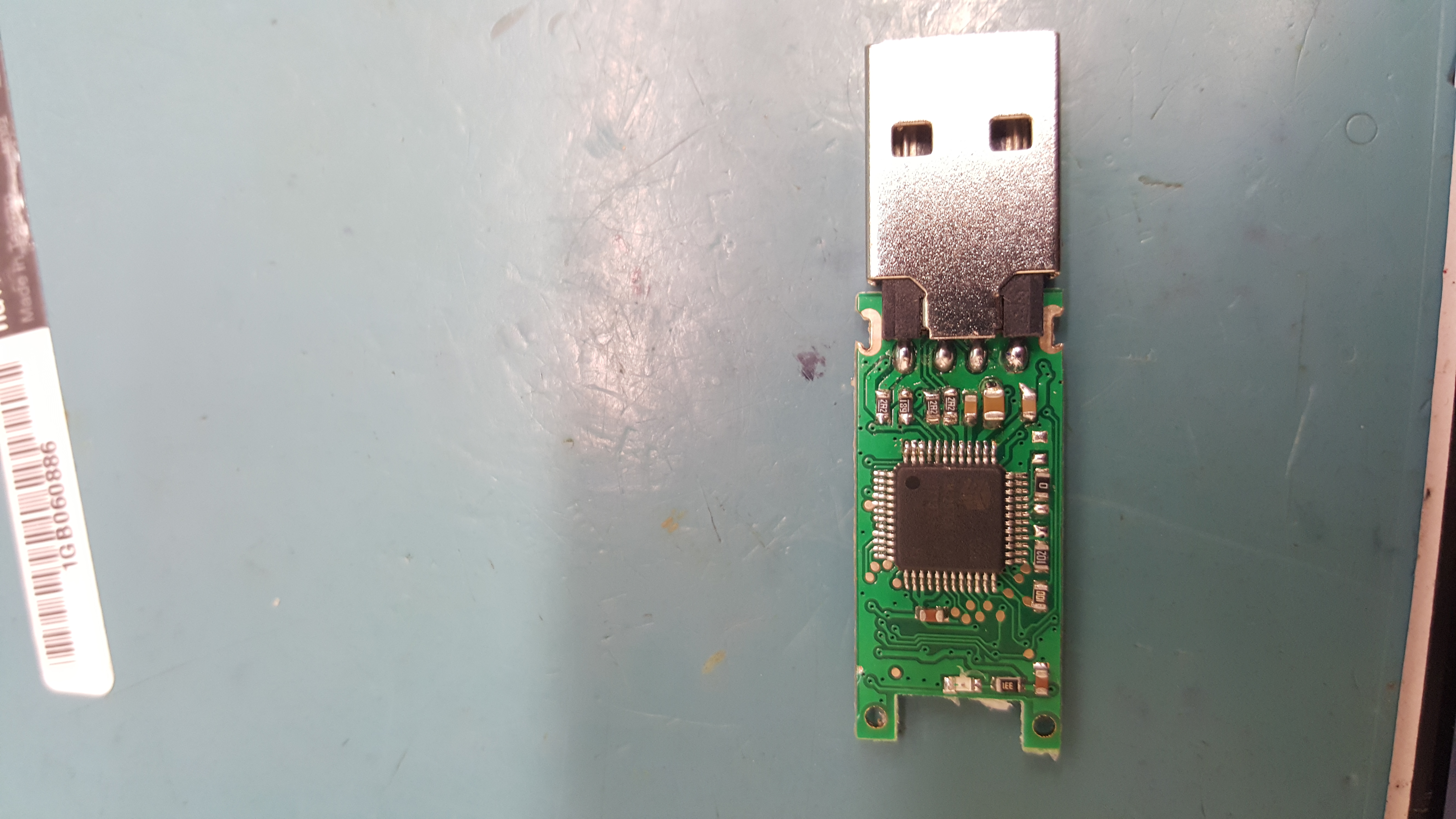

i must recover files from usb key not recognized at all.
i show you some pictures.
thank you

A data recovery pro in your area should be able to read the nand memory by using another device with a regular tsop48 nand chip as a reference and discovering the signals at the controller. Willing to take it on if you want to send it to AU at a forum discount, or maybe someone closer wants to offer?

I'm not doubting your expertise HaQue, I don't even do flash recoveries myself and I know you're good at them, but how can you even tell it's a TSOP48 under that blob of black goo?

what else can it be ?

I know it isn't a tsop... the raw nand underneath still must have the same signals connecting to controller. The controller has standard pins for each model, look on one device where D0-D7 go to controller and ALE,CE etc, and it will be the same on this device. we use the controller to reference the signals, not the chip in this case.
As Jeremy is suggesting, underneath the "clothes" they are all the same

It is not TSOP48, it is just blob :) You can connect to nand from controller side as HaQue suggest.

It's silicon motion so finding the datasheet/pin-out for the controller to locate the signals should be easy.. be gentle soldering, those chinese PCB's are shit.
Has anyone tried removing that goo? It's not ceramic like with monolithics, it's some type of glue, it gets tacky when I heat it up.

I think there are a few different types as I had one looking similar to this and hitting it with SMD Rework hot air did nothing except smell bad. I think it would be too easy to damage the raw NAND and tiny wire bonds anyway. laser and probe may be an option but time/cost/reward ratio sucks....

i think that the glue is epoxy resin...

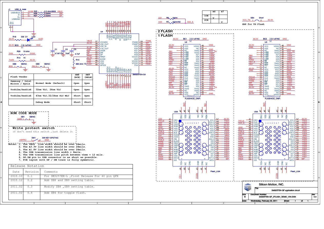

What is the part number of the controller?

sm3257en
s1k137.1
 Post subject: Re: usb key not recognized
PostPosted: November 24th, 2015, 8:56
Posts: 4000
Probably full number is SM3257EN Q AA which means maybe a WL chip, and bad cols, in software, makes it even harder for DIY.

Here is an application circuit:

1. you need a reader.
2. you need to identify signals at the controller
3. you should remove controller, solder thin wires from controller pads to reader
4. if you can ID the NAND, read it.
5. If chip is WL, you need to deal with bad columns
6. remove whitening and mix and whatever else needs to be done to fix and create image
7. recover files using DR software
IMHO, steps 1 4,5,6 are not going to be a cakewalk. If you don't have flash experience then you probably won't even get the chip read properly.
this case should be outsourced.
