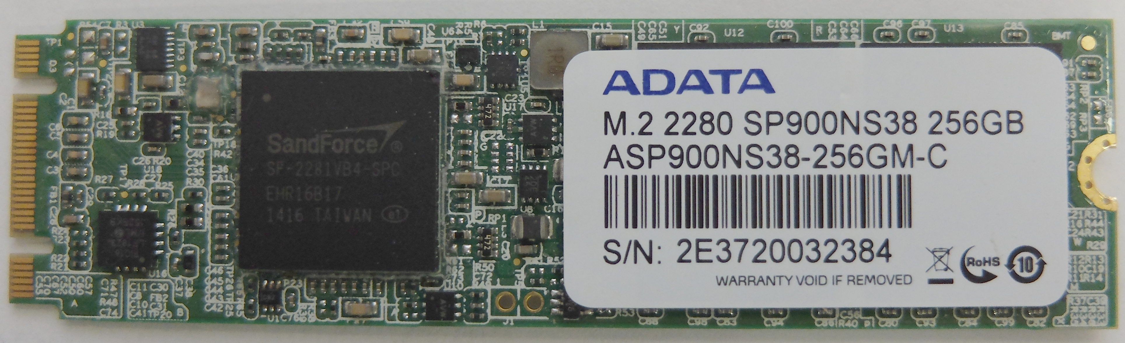

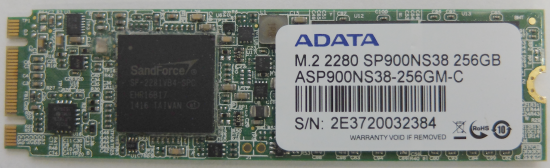

Thanks, very interesting! And makes you feel uncomfortable as well... So I hope that if confirmation could not be obtained, the papers were not signed. This sort of crime is happening a lot, though more commonly over email. Someone hacks company and watches email for a while until they learn the way the management talks, and what kinds of requests are normal. Then they send their own requests posing as management, and telling the staff they must not disclose this deal as it is secret. happed with Ubiquiti Networks for a large sum of $$ and various others.
But your SSD issue could be hard to solve.. I take it you need DATA? being a SandForce chip, this is going to be difficult. There are companies claiming to have solutions but so far I have seen 0 confirmation of this. They generally want an up-front "attempt fee". Which IMHO is Money for nothing.

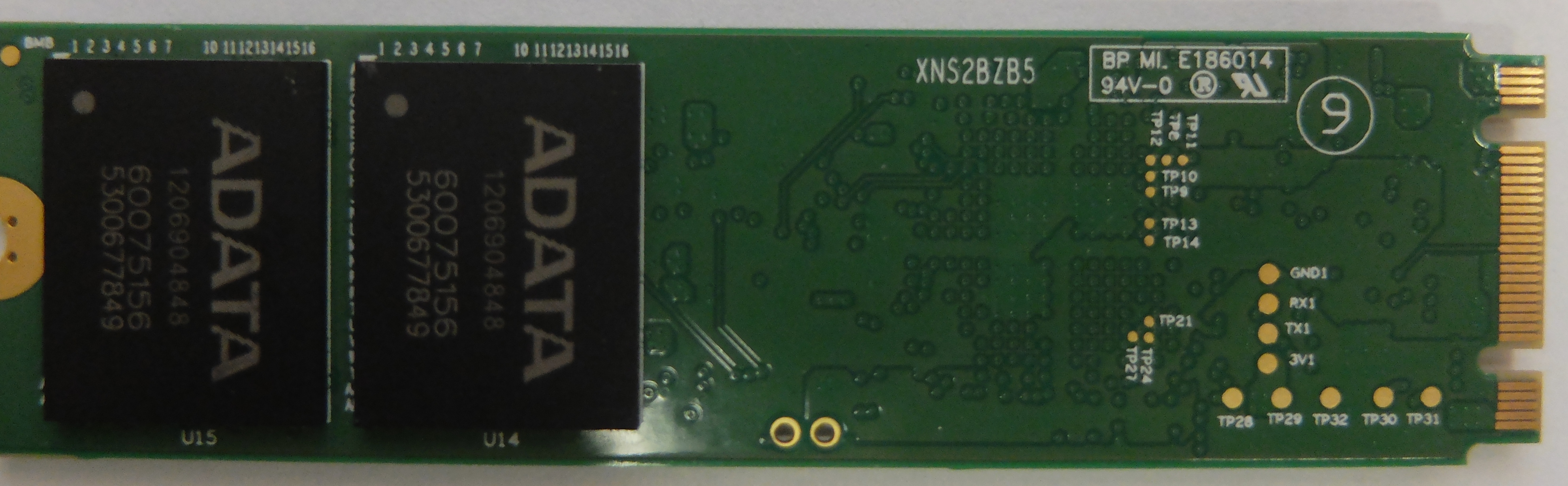

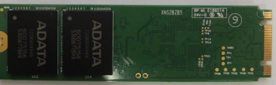

FWIW, I can help you measure the voltage test points. I would need hires photos or scans of both sides.
m.2 SSD is initialized on boot up and Windows would be happy to format it again.
The data on drive is mostly backed up and it is believed that there was not any really business critical files lost AFAIK today.
But stuff which restoration takes several hours to restore from papers, which still is worth some efforts to recover and some documents which occasionally may be needed later and therefore good to have :-)
How much meaning is in this MHDD error:
Init drive: Recal
An internal stack overflow has caused this session to be halted.
Change the stack settings in your config.sys file ...
Does it indicates a physical defect or may be just messed up partitioning?

you could also connect to serial terminal that's clearly marked and see what it says, though I don't think it will help
Device is under warranty and I'm not sure if it's worth to solder wires to PCB.
Or are there any suitable contact pads available in Ebay?
What application to use to talk/listen through serial port?
 Post subject: Re: How likely radio waves may corrupt SSD device?
PostPosted: November 25th, 2015, 21:01
Posts: 4000
you would use Putty (free) or hyperterminal if you like crappyness and a serial to usb device such as:
http://www.ebay.co.uk/itm/Hobby-Components-UK-USB-to-serial-port-adapter-FTDI-with-3-3V-and-5V-outputs-/130923180691?hash=item1e7ba13293:g:A~oAAOxyi-ZTXiu2
connect RX of serial adapter to TX of SSD and TX of adapter to RX of SSD and connect GND of adapter to GND of SSD.
eg:
TX-RX
RX-TX
GND-GND
then look in device manager which com port your adapter is, usually COM3 or COM6, start putty and select "Serial". then power on your SSD. watch the output on putty. also setup a log file and turn logging on in putty for perusing later.

HaQue wrote:
What I don't have is 3-4 pin test probe with 1.25 mm between pins.
Any suggestion is there any industrial reasonably priced multi pin 1.25mm clamp?
Anything on Ebay perhaps?
On Ebay I found "10pcs New P50-B1 Dia 0.68mm Length 16mm 75g Spring Pressure Test Probe Pogo Pin"
http://www.ebay.com/itm/10pcs-New-P50-B1-Dia-0-68mm-Length-16mm-75g-Spring-Pressure-Test-Probe-Pogo-Pin/390545147874
Probe tips with crimper tool to wires would be more comfortable perhaps.
And thanks for refreshing my memory - I already have this USB-> serial converter.
And I bought 5 days ago from Ebay and is still on it's way a m.2->SATA converter, because direct on motherboard it's difficult to access and test device properly.
Likely it's also suitable to mount some test pins to contact PCB bottom side.

It's Sandforce! I'm sure it failed by itself as it's only a matter of time with these... lucky it lasted this long. Unfortunately no known fix for data recovery yet.
PostPosted: November 26th, 2015, 10:29
Posts: 4000
well half a dozen companies on the interwebs say they can recover from SandForce, but no evidence of it yet...
