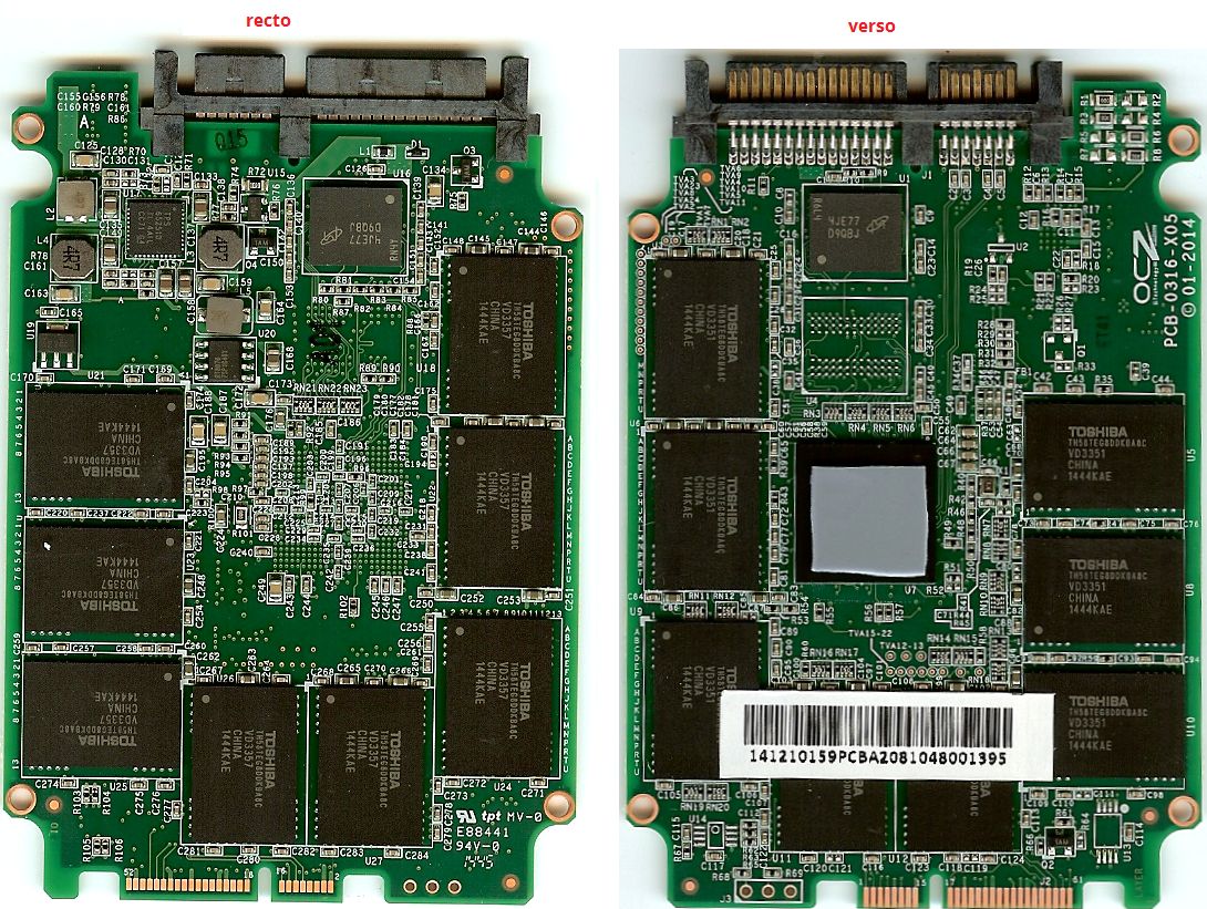

Here attached, the picture of the OCZ 480GB ARC 100 printed circuit board, recto and verso.
Click on the picture to see it in full size.
File comment: Recto and verso of the PCB of an OCZ ARC 100 480GB SSD.

In my last message, I forgott to tell about what is written on the main controller, under the squared grey silicone piece:
INDILINX
IDX500M10-BC
PMU014.00
ILA0G4300A
3243 KR

Arc 100 drives also using hardware encryption, so there is no chip-off data recovery solution, as i know.
There is kind of eeprom 8-pin chip on the recto of the PCB (see left picture above).
I assume it could store some settings for the firmware.
Concerning encryption, do you know if some password is stored in it or in the main INDILINX controller?
I do have a working same SSD, which could serve as donor.
I would be tempted by first trying a hot air reflow on the patient SSD, especially on the main controller, but I'm not sure if it is a good idea. I would prefer diagnosing more if possible, but don't have the PC3000 SSD however.

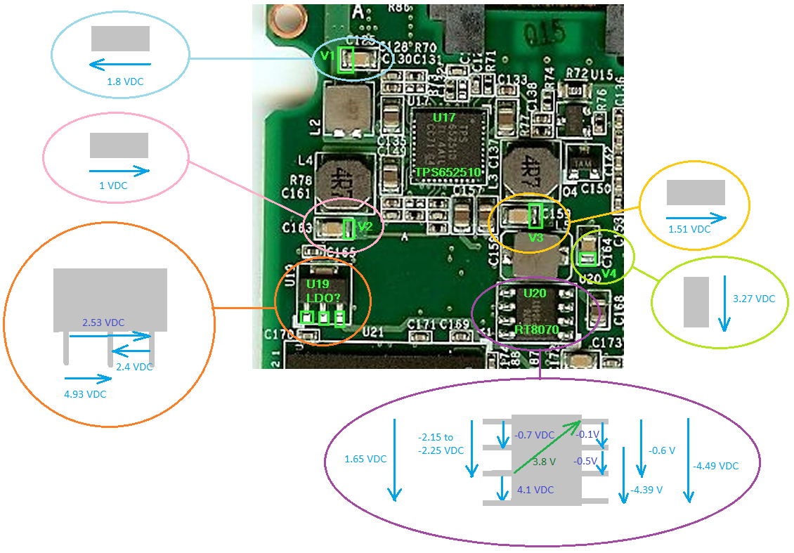

AFAICT there is no discrete "ROM" on either side of the PCB. However, there is a vacant location at the bottom RHS of the "verso" photo which could be reserved for such a ROM.
The 8-pin chip on the "recto" side is a DC-DC converter. I have identified it as an RT8070 in my previous post, but your photos are unclear.
Can you measure the voltages at U19 (LDO regulator?) and V1 - V4 at U17 and U20? Can you tell me the part number of U19?
Can you also measure the Vx and Vy voltages? These will be the NAND supplies. I believe the zero-ohm resistors are the programming jumpers for the VDD and VDDQ rails.

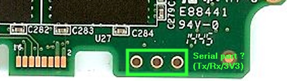

There is a vacant 3-pin header which could be a serial port, but I'm not certain. The pins could be Tx/Rx/3.3V or Tx/Rx/Ground.
These points are for launching SSD safe mode (technological mode). The mode when drive is working controlled by Kernel microprogram stroring in internal CPU ROM.

 Post subject: Re: OCZ Arc 100 480 GB : typical failure?
PostPosted: December 5th, 2015, 12:50
Joined: July 7th, 2014, 6:44
Posts: 225
Location: Switzerland
Sorry for the late reply, but the analog multimeter I was using had loose connections, so that I had to purchase a new one (a Fluke 70 Series II).
For the U20 chip, the voltages between two successive pins were (very) difficult do measure because the multimeter has quite large tips and I was not very good at this.
Click on the picture to see it full size.
On the recto, I also measured voltages at C134 : 1.51V (with the positive down)
and at C249: 1.795V (with the positive up).
On the part at U19 is written:
J B-
1E70Q
I confim that the 8-pin chip on the recto is an RT8070.
PostPosted: December 6th, 2015, 0:41
Posts: 17314
Your measurements are a little strange, but all the voltages appear to be present (1.0V, 1.5V, 1.8V, 2.5V, 3.3V). Assuming that the drive identifies as a BAREFOOT3-FACTORY-ROM (as per bubaleh's advice), then you could try adjusting the 3.3V supply.
If you would like to try this trick, then power off the drive, short the ends of capacitor C164 (V4 test point) with metal tweezers, and measure the resistance between ground and pin #7 (FB) of the RT8070. C164 must remain shorted during the resistance measurement.
BTW, when you measure a voltage, you should use a ground reference. That is, place your COM-mon probe (black) on a screw hole (0V) and then use your Volt/Ohm probe (red) to measure the voltage test points.
U19 is a 2.5V LDO linear regulator.
RT9166-25PXL, Richtek, Ultra-Fast Transient Response LDO Regulator, 2.5V, 300/600mA, marking JB-, SOT-89:
http://www.farnell.com/datasheets/1720529.pdf
