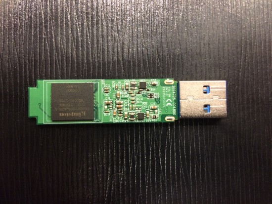

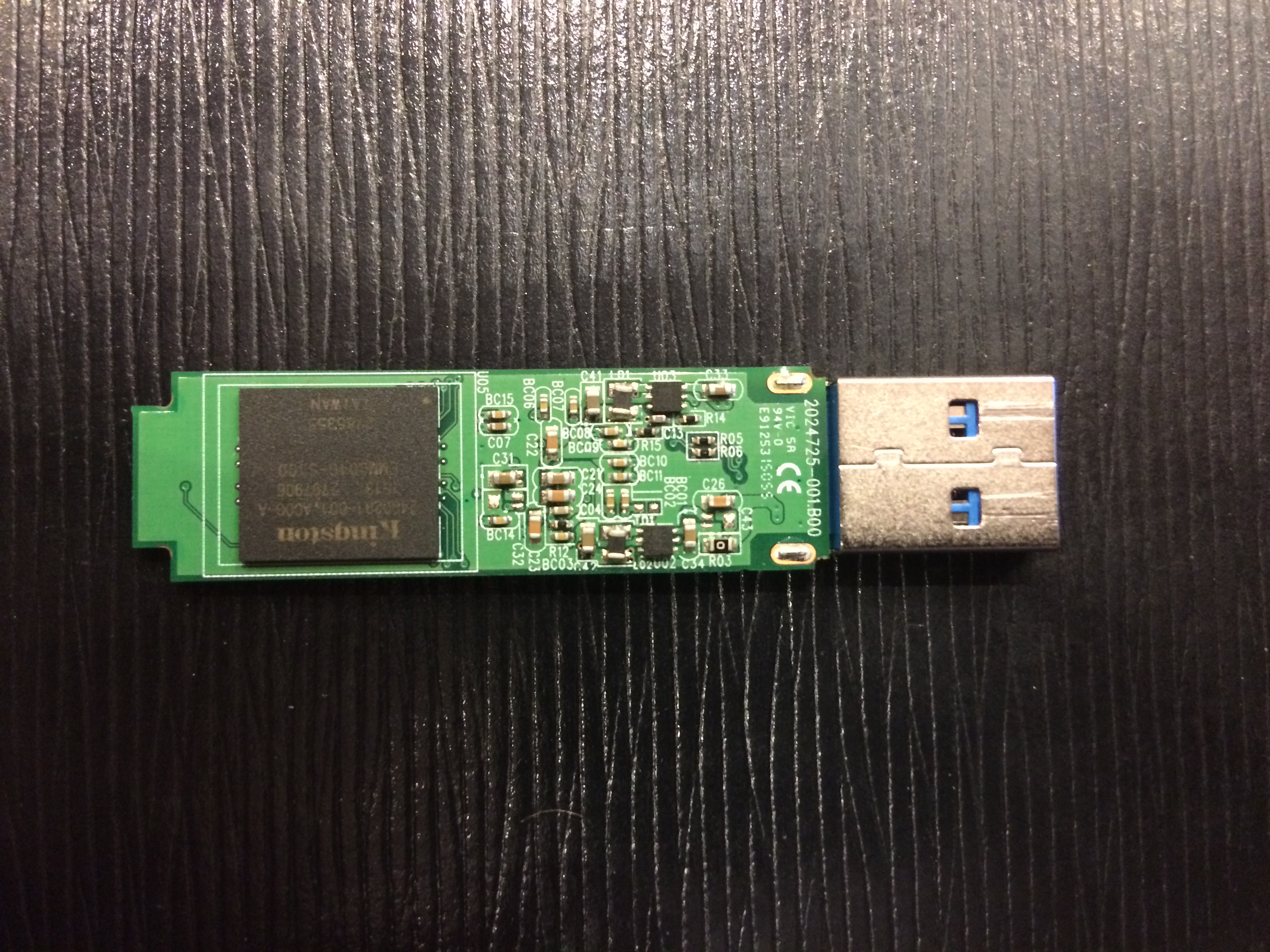

I took some pictures of the PCB in question.
I was wondering if C01 and/or C02 could be acting as fuses...

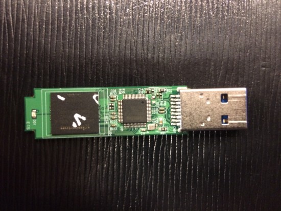

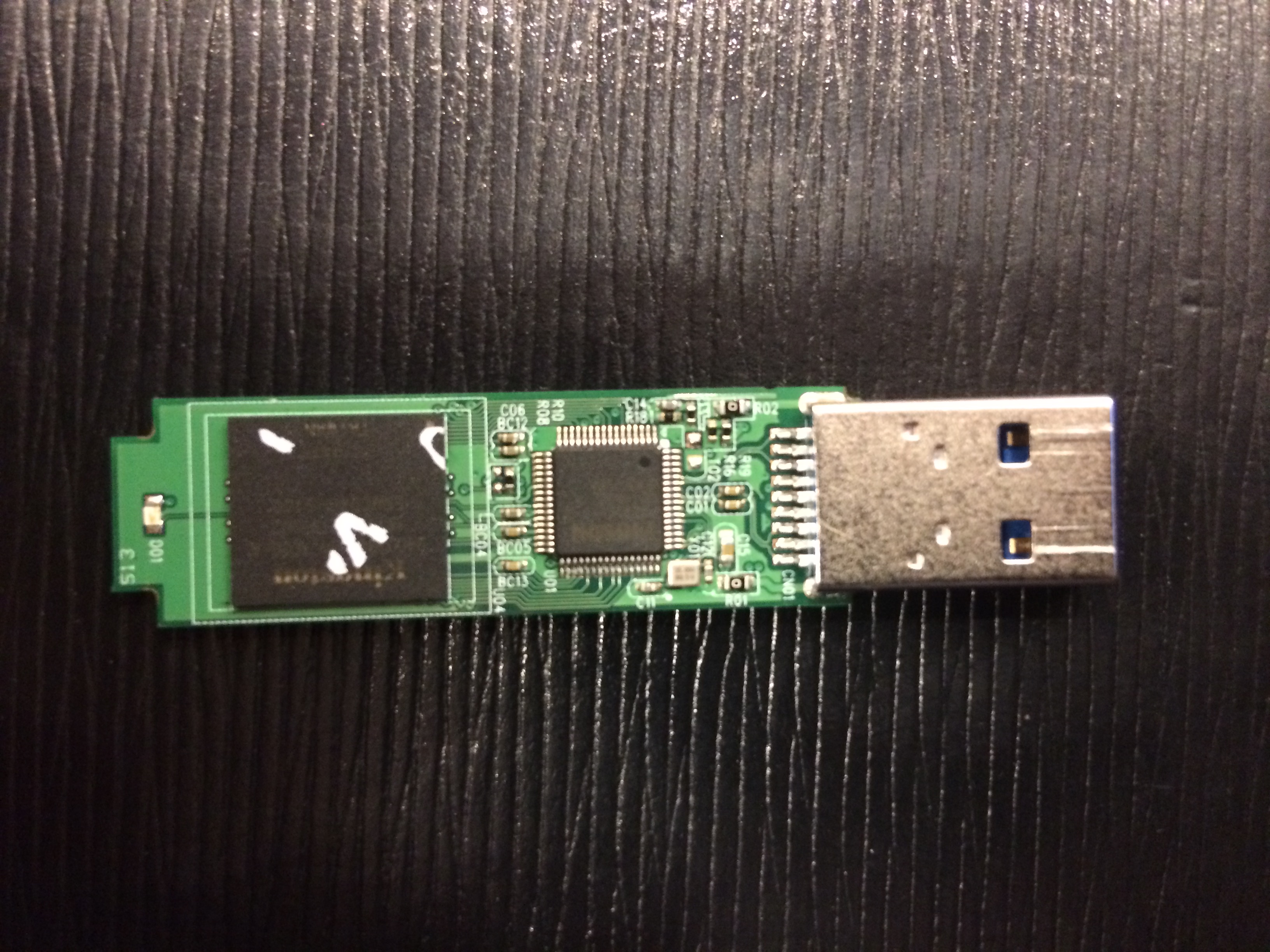

Flip side of the USB key:
Any ideas?

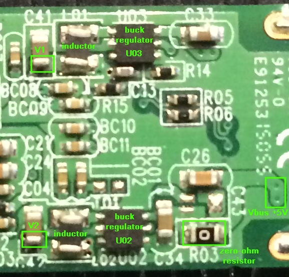

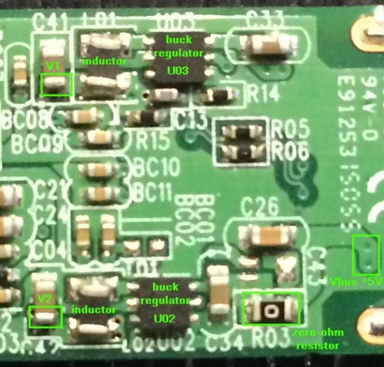

Instead I would test zero-ohm resistor R03. I would also confirm that the two switchmode DC-DC converters are working, and that the controller and flash ICs are not overheating. The output voltages of the two converters would appear across C41 and C42.

Could you tell us the markings on U02 and U03?

About using USB 2.0 instead of USB 3.0, I did and it did not help.
I tested the 3 zero-ohm resistors on the PCB (R01, R02, R03) and all test at 0 Ohm.
It's not very scientific, but the controller and flash ICs are not hot when I touch them.
About the output voltages at C41 and C42, I get 1.8V at C41 and 3.5V at C42 (with COM probe at USB ground pin).
Markings on U02 and U03: ET0 or ETC (I don't have a microscope right now, but it looks a lot like ET0).

I would have thought that typical NAND VDD/VDDQ voltages would be 1.8V and 3.3V, so yours would appear to be of the right order. Perhaps Kingston has tweaked the 3.3V supply?
I would also measure the voltages across the remaining capacitors. This would help to identify any other voltages such as the internal (?) Vcore and Vio supplies for the flash controller. I would avoid probing C13/R14/R15 and C14 or either of its associated resistors (whose circuit references I cannot identify). I believe that these capacitors and resistors form the feedback networks of each of the buck regulators. Typically these resistors have high values, so your multimeter may disturb the output voltage.
You might try to locate a datasheet or reference circuit for the flash controller (is it a Phison?). There would normally be a reset pin, and this pin is often connected to an RC combination. I suspect that the junction of R12 and C04 could be the reset test point. It should go high in order for the controller to start up.

The controller is indeed a PHISON. I am not able to read the part number though.
I'll see tomorrow if I can get my hands on a decent microscope.

So, turns out the flsh controller is a PHISON PS2251-13-Q. I'm having trouble finding datasheets for this chip.

The capacitor which I suspected was the reset cap (C04) is sitting at +3.5V, so this means that the controller should have woken up. However, the 0V readings at C01 and C02 (USB 3.0 pins) would suggest that the controller may be brain dead. My next step would be to confirm whether Y01 is oscillating. Other than that, I wouldn't be able to do anything.
