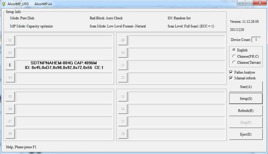

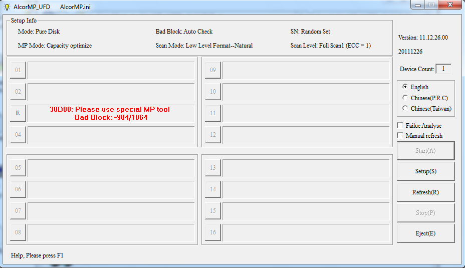

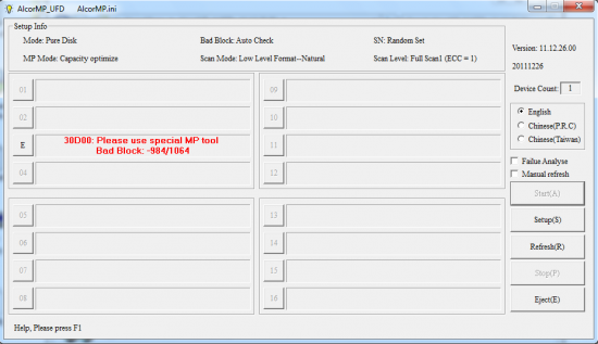

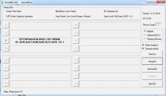

The number on my Flash is "618316 8421 JF300".
I wanted to use MP Tool but got an error. I attached some photos.
What is your idea?

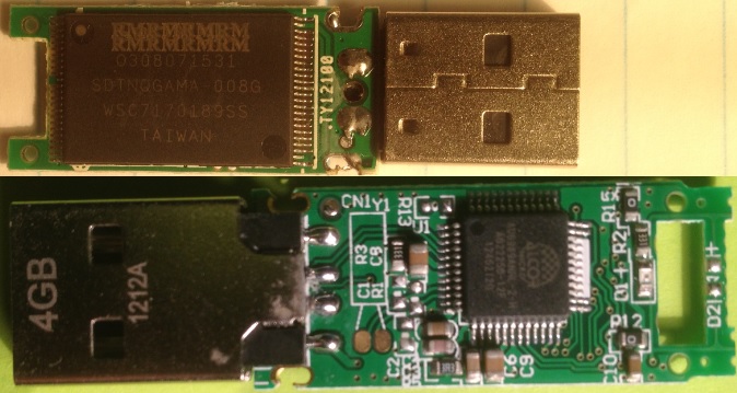

is there RMRMRM over the top of the SanDisk name on the Flash chip?
I fear the flash is faulty and is a refurbished chip

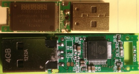

unless you have another way to read what's written on the chip
 Post subject: Re: Is my Pendrive Dead ?
PostPosted: January 18th, 2016, 11:59
Posts: 3977
HaQue wrote:
You pull the drive apart and look on the controller chip. The number would be AU6989 or something like that
You need the MP tools, along with burner and firmware files, and also must figure out how to use them. Other info you need is the NAND chip numbers and ID's.
Unless the pendrive is something pretty expensive or something, effort spent on this is, I fear, futile.
There are 2 chips.. a controller chip and a NAND chip. The controller chip is the Alcor, and named as I said. The NAND flash is the SDTNxxxx chip. I am guessing the NAND will look like this:
you must know the exact number of the controller and the chip, the chips geometry etc to be able to pick the correct MP Tools (Mass Production Tools)
So it looks like it is a 4GB drive. A much better drive than that one retails here for AU$5.97 is there a reason you are trying to fix the drive to a possibly working, but never trustworthy state?

because a) it is Alcor, which tend to be in some of the crappiest drives in existence (I know I have at least 700 flash drives) and b) that chip number SDTNxxx.. is a common number for a refurbished chip. SanDisk check the chip, if the errors or bad blocks are over a certain amount, they sell it as refurbished. The chip is retested, errors are added to error tables and RMRMRM is lazered over the SanDisk name. if it was a real SanDisk, it usually is coupled with a SanDisk controller. The above makes me suspicious of its condition, and the fact that it isn't working....
so to continue, open it up and post some photos, or I suggest get a new drive.
