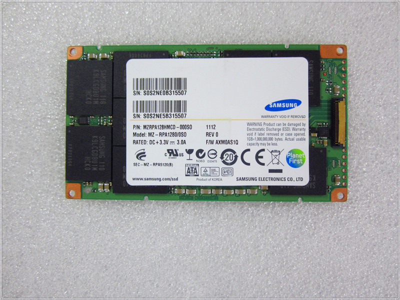

Asking for assistance to connect one of the Samsungs MZRPA SSD out of a Vaio laptop
- its a single SSD with one flat cable connected to the mobo - its NOT LIF - its a proprietory
connector.
I have checked all posts regarding such type of SSD - its not a RAID part - its a single
SSD in this laptop - plus none of the shown SSD are similar to the one I have here -
it might be a newer pcb layout.
the ssd model: MZ-RPA1280/0SO - out of a VAIO VPCZ21M9E
I would need a ready to use adapter to SATA - I doubt that I am able to solder these tiny pins....
thank you

This is the picture of the SSD
Re: samsung MZRPA SSD to sata
February 10th, 2016, 17:11
Sure looks like a RAID ...
Peel off the sticker and show us the other side.

no raid - its a single pcb - (as told in my post - there is no 2nd module
connected to the cable and/or the mobo) - and the connector shown on
that picture is the only one.
but to be clear - on both sides of that SSD one finds memory chips
- peeling off the label only shows the memory chips of one side of that
module.
You might be right - if this single pcb is internally a combination of 2 ssd
into a raid and the pinout of that connector contains the rx/tx for 2 ssd ?
Thank you

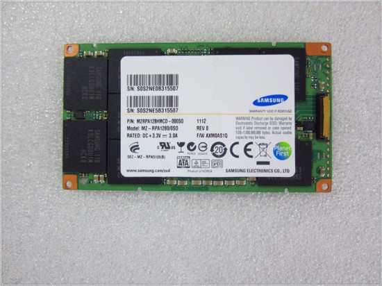

All Google results for "MZRPA128HMCD" point to RAID. :?
This looks like it might have a second controller and SDRAM under the sticker:
http://g04.a.alicdn.com/kf/HTB1g9tcKFXX ... 2-Z215.jpg
February 10th, 2016, 17:59
yes, the one you referr to is most probably the "twin pack" of 2 ssd
used in a different type of Vaio laptop.

Can you show us the PCB without the sticker?
February 10th, 2016, 18:22
It has two serial numbers on the sticker... looks like it's an SSD RAID all built onto a single PCB to me. Very interesting, I've never seen this before.
February 10th, 2016, 19:23
The difference in the serial numbers is consistent with the difference in the example that I found. Moreover, there is discolouration under the sticker of the OP's drive which appears to be consistent with a second controller. That is why I am interested in seeing what caused it.

sorry, I should have had a closer look to your link - i.e. the pictures
yes, you are right this is the type of ssd - your picture shows both
sides of the same ssd.

As Franc says, it's a RAID SSD module with a proprietary interface.
No adaptor exists as far as I know. If someone has made one, I want one! :-)
February 11th, 2016, 18:34
I have done one of these, it's not that hard to find the 2 pair of SATA channels and solder wires. In my case one of the drives had a few bad sectors.
