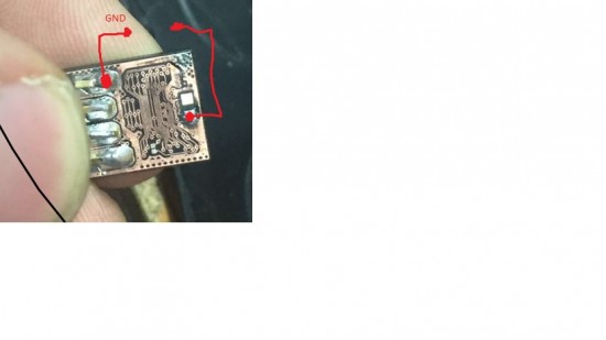

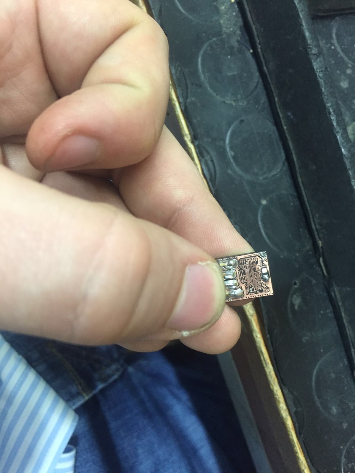

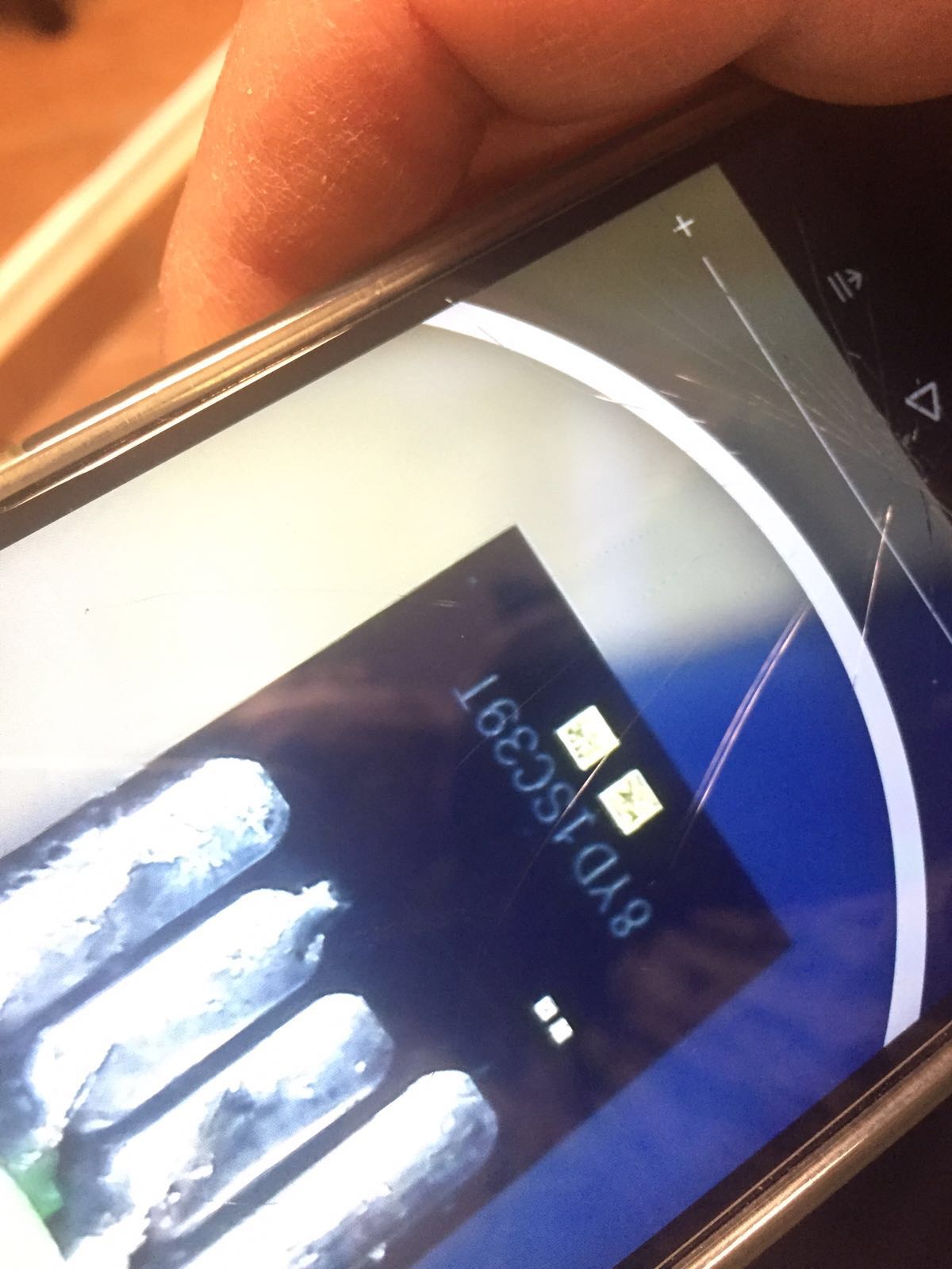

I have a pen drive :
TDK TF10 8GB
Inside there's a monolitich chip
When I connect this pen drive the usb recognized the pen drive as mass memory and after few second disconnect it.
It possible to wrap the circuit and intercept other pin for read the chip ???

 Post subject: Re: Help me !!! Please TDK TF10 8gb pin out
PostPosted: February 19th, 2016, 14:15
Given that this is your fist post here, I'm doubting that you have the equipment or expertise to handle a monolith recovery. There's really only a handful of people worldwide who've even started to work on these. I'd recommend you send it in for recovery and brace yourself for a hefty price tag.
 Post subject: Re: Help me!!! Please TDK TF10 8gb monolithic flash pin out
PostPosted: February 19th, 2016, 15:32
Posts: 456
mercurialiluca wrote:
I have a pen drive: TDK TF10 8GB
If I got your description and your question right, then the approach you suggest is hardly probable. Working controller is required for it to work, while in your case it's likely to be dead. And you won't be able to get just a stream of user data therefore.
The only way here is to solder to proper pins and create raw memory dump, then reassemble it.
And that isn't something possible to do without proper skills and equipment.
If necessary, we should be able to help with this monolithic pen drive.
PostPosted: February 19th, 2016, 16:12
Posts: 922
If you can see traces under layer - compare it with this one:
http://odzyskiwanie-danych.com.pl/image ... arvika.jpg
PostPosted: February 22nd, 2016, 13:50
Joined: September 6th, 2015, 10:06
Posts: 13
Location: Cesena

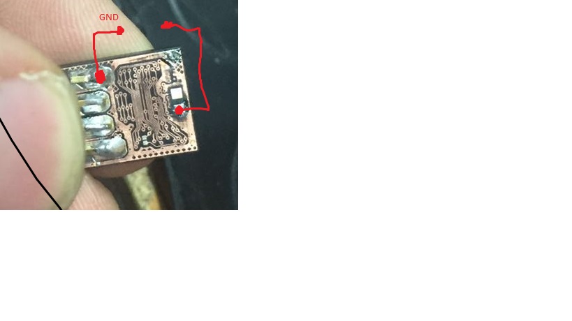

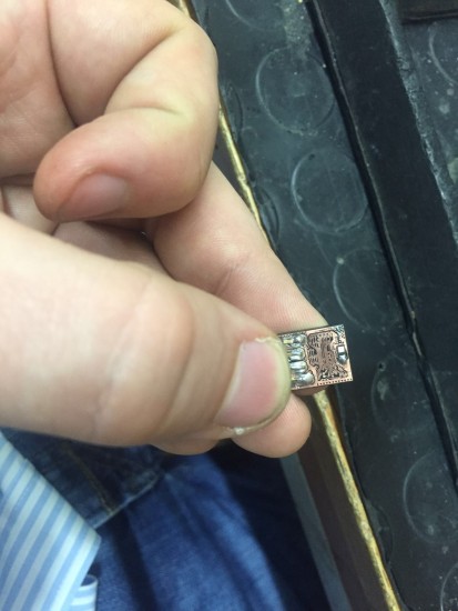

Ok , I lap up the monolitich , and I look the naked pcb but I don't know the schematics , and I haven't anothe pen drive to compare it with oscilloscope .
I' ve read from the two point that I indicate a tension ( from 1 to 2 volts ) that chenge continuosly
When I put a capacitor from the two point ( 1 microfarad ) the system recognize it ... see pdf
PostPosted: February 22nd, 2016, 14:09
I don't see this one in Arvika's database of monoliths: http://www.odzyskiwanie-danych.com.pl/m ... abase.html
Perhaps someone else has the pinout.
PostPosted: February 23rd, 2016, 5:32
Posts: 3977
if system recognises it, try imaging the whole disk with DMDE. else you need the tools and pinout as you already know. Or outsource it. some monoliths do not have traces on top layer and you have to drill into the pcb to get at them.
I have flash doctor too - what a massive waste of money :(

I place in the 2 point that I indicate in photo a capacitor and the flash work fine and I make a dump.
Very lucky.......
PostPosted: March 7th, 2016, 19:06
Posts: 3977
yes very lucky.
The large pads I think are for a LED, not sure why this would work, but great that it did.
