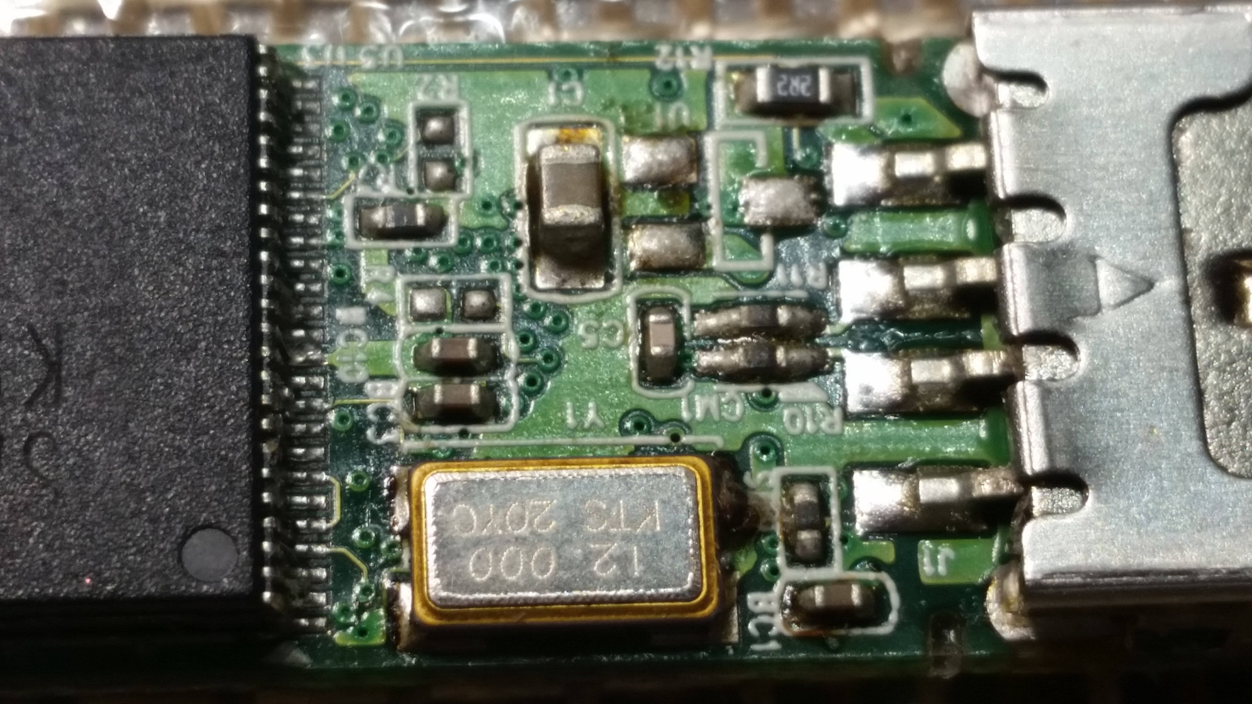

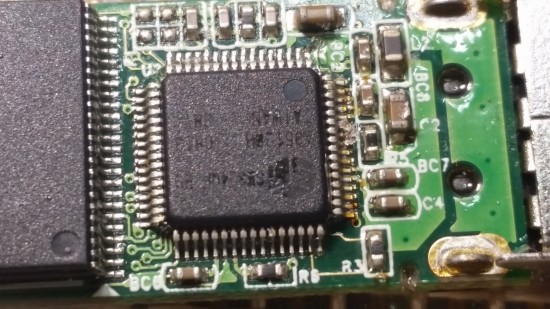

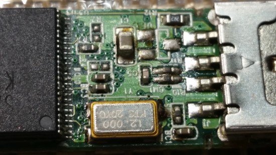

Just received this flash drive. One area I am not strong in is assessing what might be wrong electronically with a dead board. I can complete chip offs and repair broken connectors but know I need different skills. This flash drive is dead, does not mount and no LED so presume its a power issue. What are the steps I should be taking to find out whats wrong before completing a chip off?

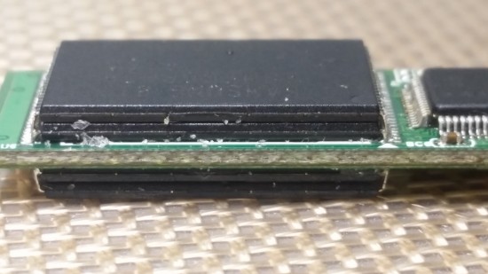

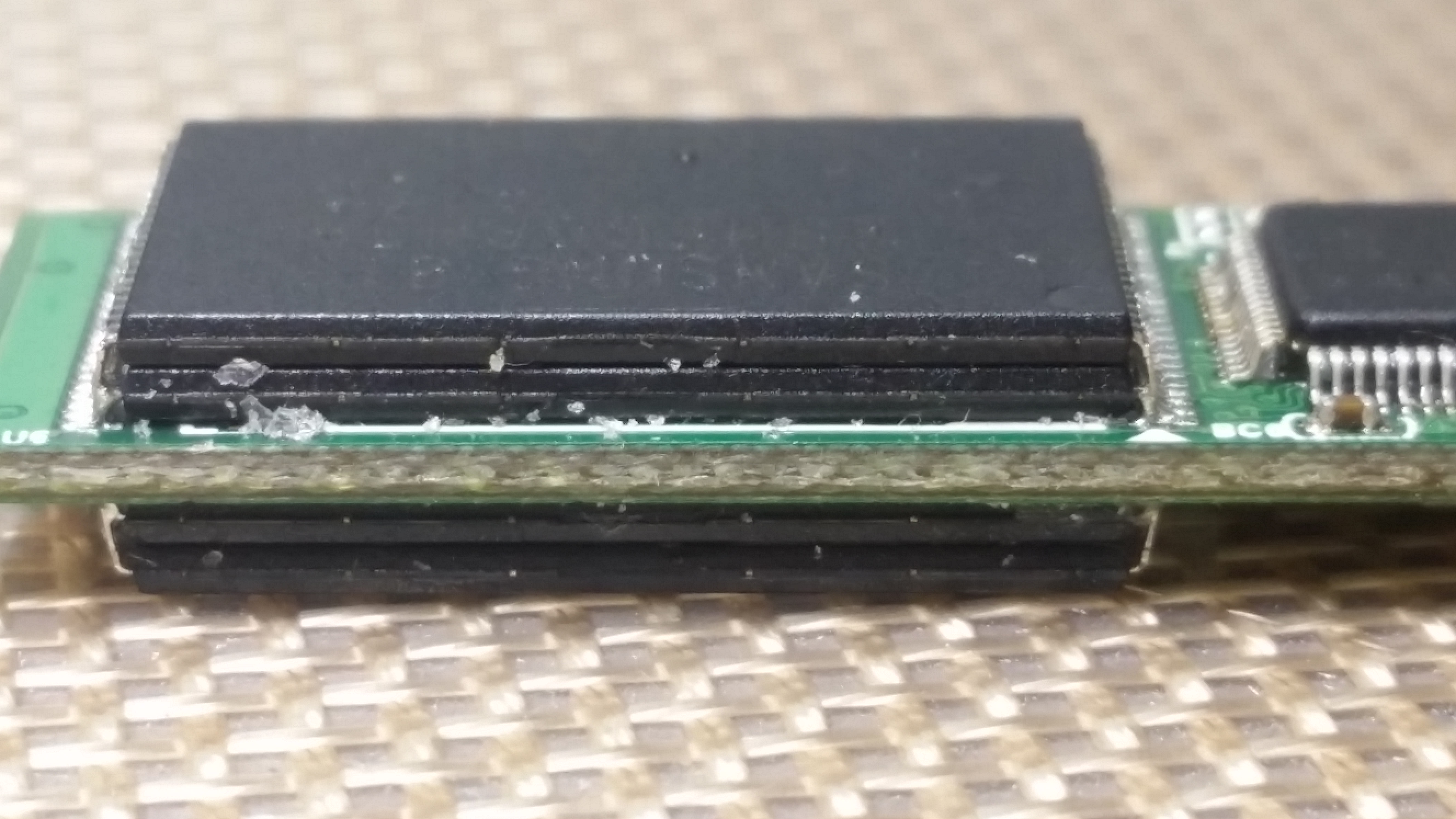

Also if it does need a chip off, this drive has 'double decker chips' (see pic) and advice on removing and reading these vs normal TSOP chips? Never seen these before.

Looks like flux residue on it. Did it arrive like that? If so, then asking customer questions can be very helpful in finding out in whose hands it has been.
AFAIR reading the NAND in reader, it is the same thing as regular NAND.

I would measure the voltage on either side of the 2R2 resistor (2.2 ohm). This will tell you whether +5V is getting to the drive.
Measure the voltage across the same resistor. This will tell you the current that is being drawn by the drive.
    current = voltage / 2.2 ohms
Measure the voltages across the capacitors. You will probably find +3.3V for the NANDs. There may also be +1.8V and a Vcore supply (~ 1V ?).
Shake the PCB against your ear. If it rattles, then the 12MHz crystal (Y1) is probably shattered.
Test for continuity between the Data + and Data - pins and their respective resistors, R11 and R10. There should be a low resistance between the USB Data pins and the controller side of the resistors.

The residue is burnt glue. The drive was contained within a waterproof rubber enclosure and covered in glue presumably to keep it watertight. After spending an hour removing most of the glue I tried to reflow the board with no luck (hence the dark residue). I have tested the connector legs and there is power, so the issue is somewhere on the board (or perhaps controller failure).
The metal leads are welded together, try not break the welds, you can use solder to reconnect them but it's a minor PITA, otherwise they show up as 4 Banks, nothing special.
DON'T SEPARATE THE TOP AND BOTTOM CHIPS
Silicone is holding the NAND chips to the PCB, in addition to heat slip a Xacto knife under the bottom chip to gently lift it from the PCB.

How About Using a Preheater To Heat Bottom To 100 Degree Celsius ? .This Should Melt The Silicon IMHO

Silicon is pretty good at dissipating heat (?right word?), you can get a little bit of play using heat (400C) but not a lot which is why I recommend using a spreader of some sort.
Voltage either side of R2R is 6.6v which seems high
Voltage across R2R 0.1v
Most capacitors are 4.5v of 1.8v except:-
C5 0.0v
C3 6.6v
C4 0.3v
No noise from the crystal
Data+ 0.3
Data - 0.3
Hope that helps....

The voltage readings are too high by about 33%. Either your meter is bad, or perhaps it behaves that way when its battery is flat.
    6.6 / 1.33 = 4.96V
    4.5 / 1.33 = 3.38V
    1.8 / 1.33 = 1.35V

Fzabkar you are indeed a genius. I had a new 9v battery, tested it and it read 12v. New battery now installed. You can take your new readings above as true. Do any of the other zero/low readings point to any particular issue?

The current through the 2.2 ohm resistor is about 45mA, so that would suggest that the board is drawing the right amount of current.
3.3V is what you would expect for NAND, but I'm not sure about the 1.35V supply. It could be Vcore, but the following circuit diagrams only show 3.3V and 1.8V. Your chip could be different, though.
ftp://helpedia.com/pub/temp/uploads/ala ... ematics.7z
The zero reading for C5 looks OK. I don't know the function of C4, so I can't advise there.
I would test the crystal with a scope. Other than that, I can't see what else you could do with a meter.
