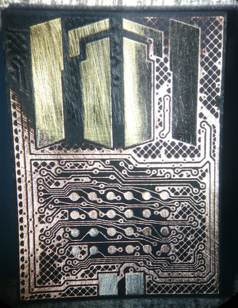

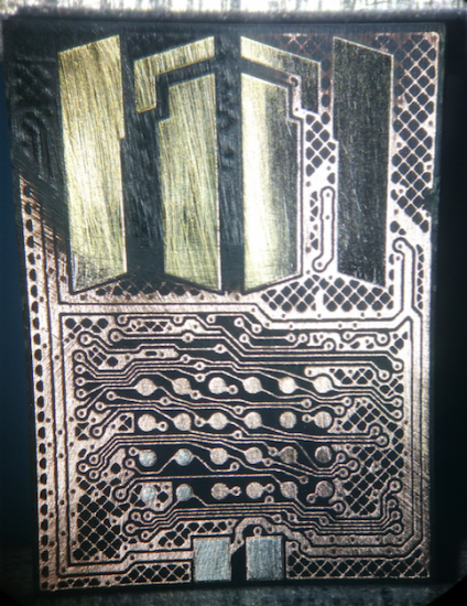

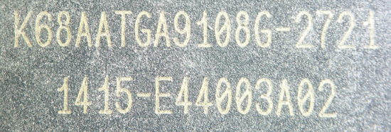

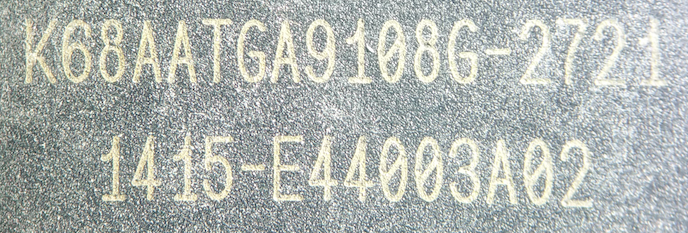

Hello There,
Just trying to figure out how to find the pinout for monolitic USB
if it looks that this model of USB not researched yet by flash rader provider.
Any public or private web sites for it or keywords?
Thanks a lot Folks.
Specific text from top of usb in attachment
P.S.: just for case if someone want take a look on it, it is here:

Usually it is complicated task to find pinout for monoliths. It can't be explain in few words. You need at least logic analyzer, working same device and methodology how to find pinout.
 Post subject: Re: How to find correct pinout for USB monolith
PostPosted: March 16th, 2016, 17:48
Posts: 3977
have you tested other 6 row x 4 column pinouts to see if gnd and vcc are in the same place?
PostPosted: March 16th, 2016, 18:51
Posts: 922
It is not. Pad 2nd row 5th column should be D0, but it is empty.

Just tried to test, but UFD to small, gonna create special tool for more comfortable testing and will continue tomorrow. Keep you posted, thank you for advice

I just said about size of UFD and thought that I gonna test it directly from usb port of my laptop, but that was mistake for sure, I gonna solder it on test PCB and working from it. Trying to realize what model of Logical Analyzer should I buy for this case.
