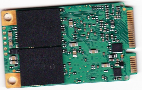

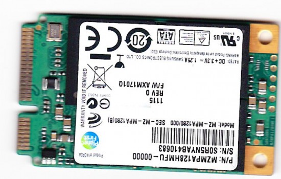

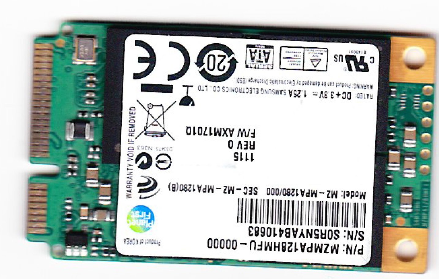

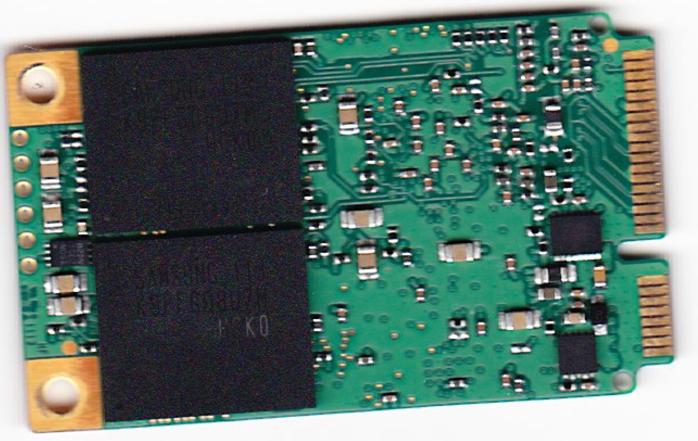

Hi Sirs,
I have this arrived in Lab. Pls see photo. Tested in PC3K 5V led in ON not green but RED. This should mean PS problem.
I'm not so used to work this SSD and I do not see any blown component. Can I ask someone some hints to test and repair to recover data? Without (possibly) dismounting chips.
Thanks in advance.
Max

I mean... I used Acelab PC3000 to test connecting to SATA port. I know that is 3,3v, is also written on the label, but usually I connect these SSD to sata using an adapter that gives 3,3v to them. It seems that 5V supply from SATA is over current (this means red light in pc3k). So the question is, what could be the problem that put 3,3V to go over current? Thanks

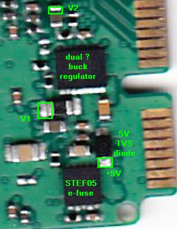

I would start by measuring the resistance between +5V and Ground at the input to the adapter, and between +3.3V and Ground at the output of the adapter. Then do the same thing with the adapter connected to the SSD.

The photos aren't very good, but here are my guesses for the voltage test points.
