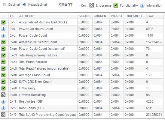

Could we see the SMART report?

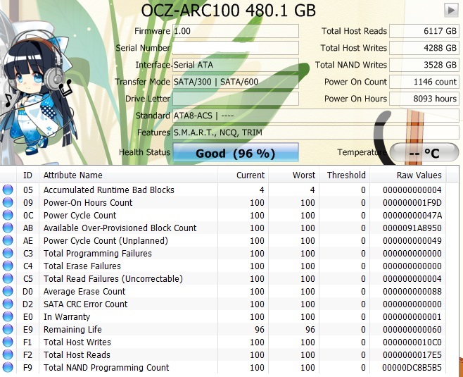

Sure, here are 2, one from Crystal and the other the OCZ util:

Some time ago I helped a user recover data from an SSD with a similar problem. He played with the NAND supply voltage among other things. IIRC SMART reported some problems that pointed us in that direction.
Just out of curiosity I checked the numbers for attribute 0xAB.
User accessible capacity + Available OP Sector Count
    = (480.1 GB) + (152 734 032 x 512 bytes)
    = 519.96 GiB
    = 512GiB + 8GiB
    = (16 x 32GiB) + 8GiB
I would have thought that the sum should correspond to the total capacity of the NAND array but it appears that there is an additional 8GiB capacity (0.5 GiB per chip).

The point I'm making is that the following relationship should hold true, AISI:
    User accessible capacity + Available OP Sector Count = total capacity of NAND array
However, the numbers suggest that the total capacity of the NAND array is 512GiB + 8GiB rather than 512GiB. This in turn suggests that each chip has a capacity of 32.5GiB. Therefore the SMART attributes don't make sense.
