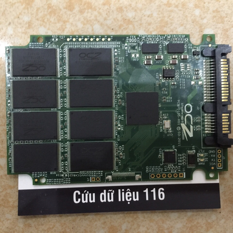

hello guys,
long story short SSD ocz vertex 3 sata III 2.5 240gb I did not detect on bios
But there are pictures on the SSD
how i can fix this problem?
HELP ME

being SandForce based you should hope it is an electronic issue with a failed component or power supply issue. Have you examined the circuit board under a microscope for any obviously blown parts? maybe some good pics of both sides of the PCB may help in diagnosis

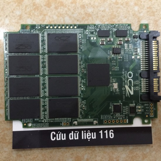

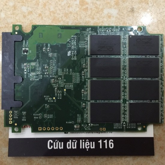

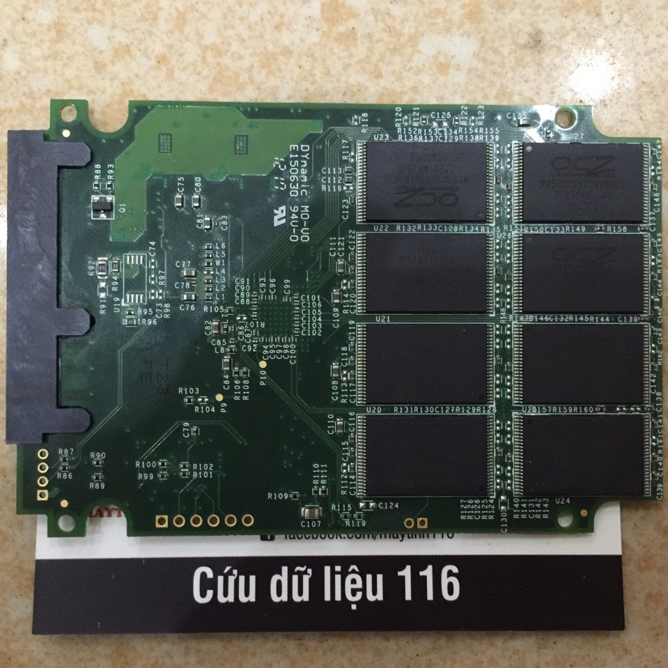

Can you help me

Do you get anything on the PWR and FLT LEDs?
Can you get a log from the serial port (TX/RX)?
Do you have a multimeter and do you know how to use it?
