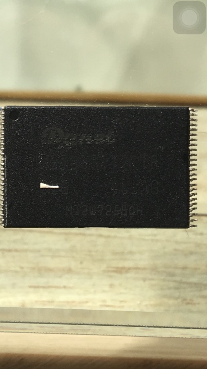

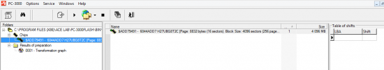

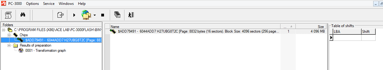

I do not know to use this tool ... and I need to recover data from this chip. Any help will be welcome or someone who can do the service via the TV or with the chip .dump.
Look prints.

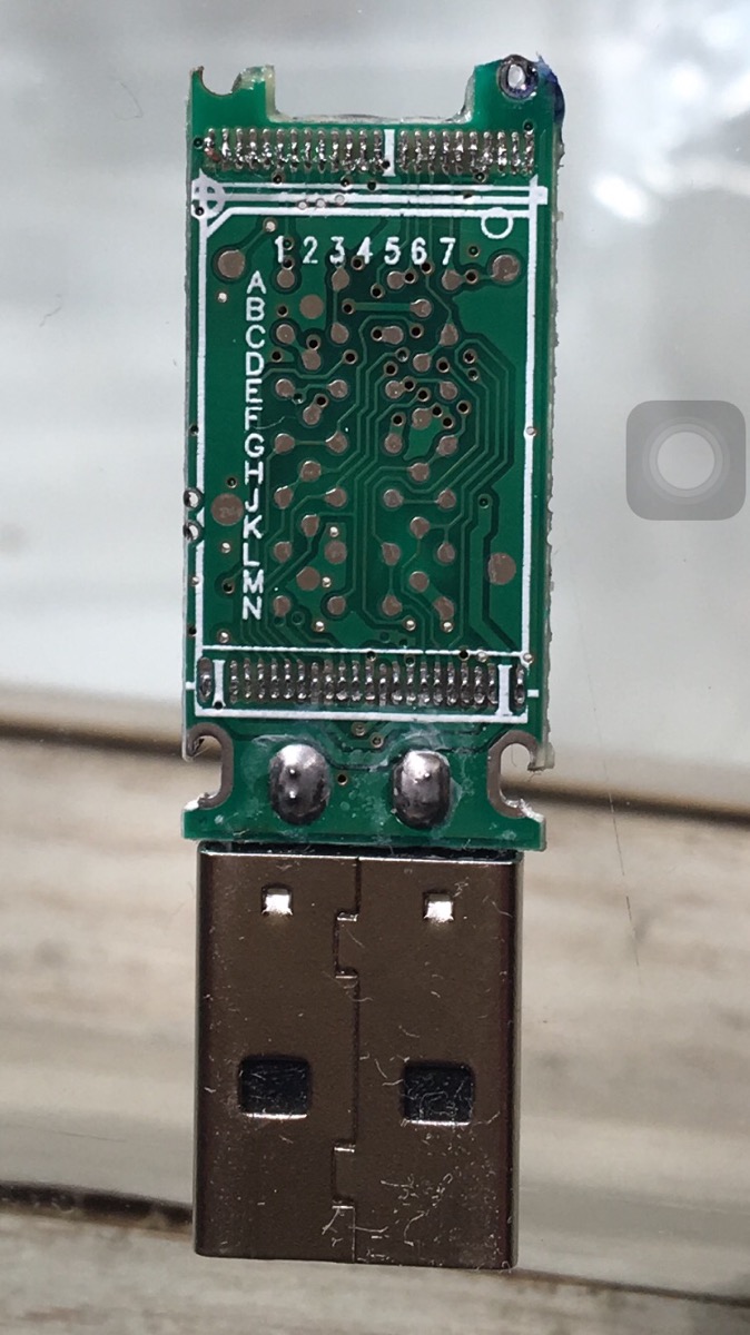

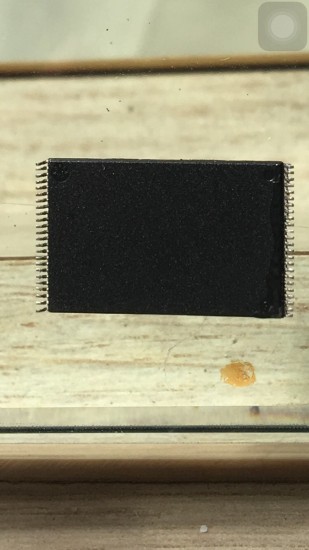

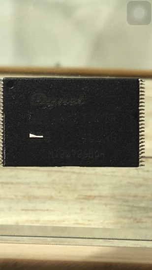

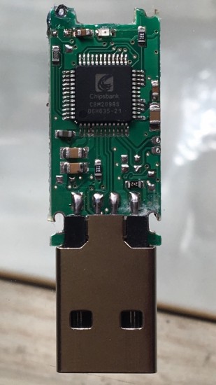

 Post subject: Re: CBM 2098S
PostPosted: May 12th, 2016, 7:35
Posts: 413
Is that a tsop48 ? Please upload the dump.
Perhaps HaQue or pcimage can see this for you.
PostPosted: May 12th, 2016, 7:43
Posts: 456

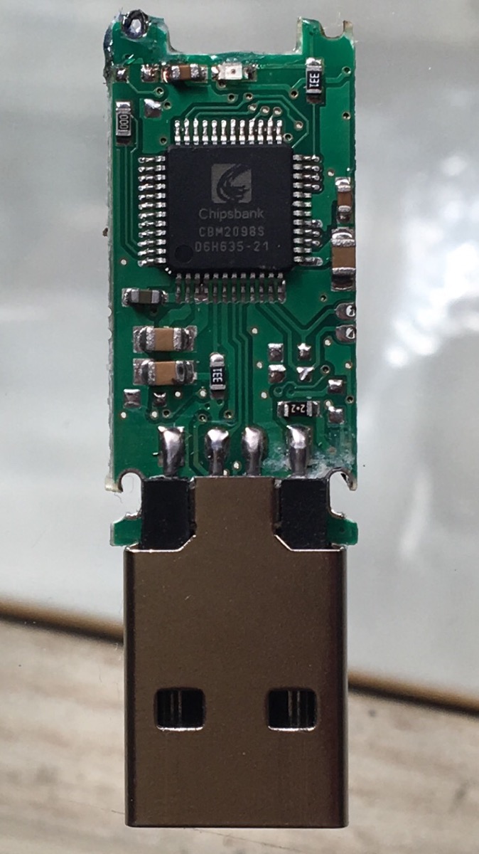

If I recall correctly, some Chipsbank controllers use dynamic XOR. If that's one of them, then recovery is likely to be a PITA.
Anyway, we'll be happy to help with this job remotely, if necessary.
PostPosted: May 13th, 2016, 14:42
Posts: 1060

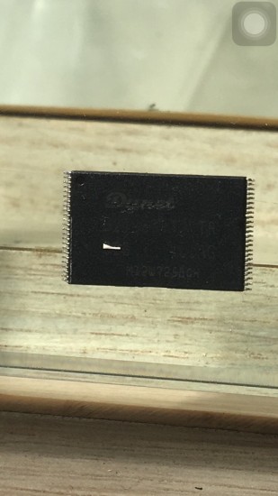

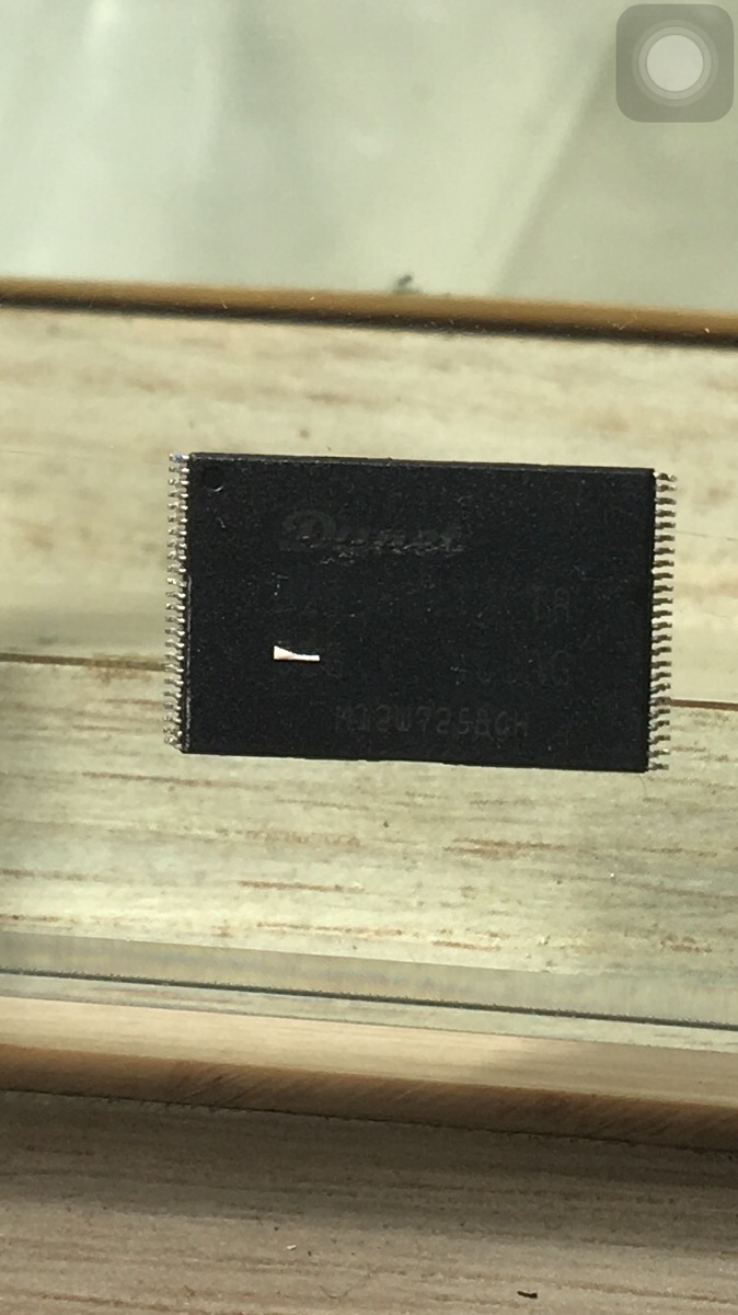

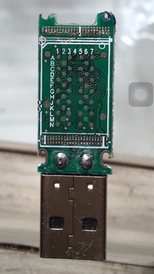

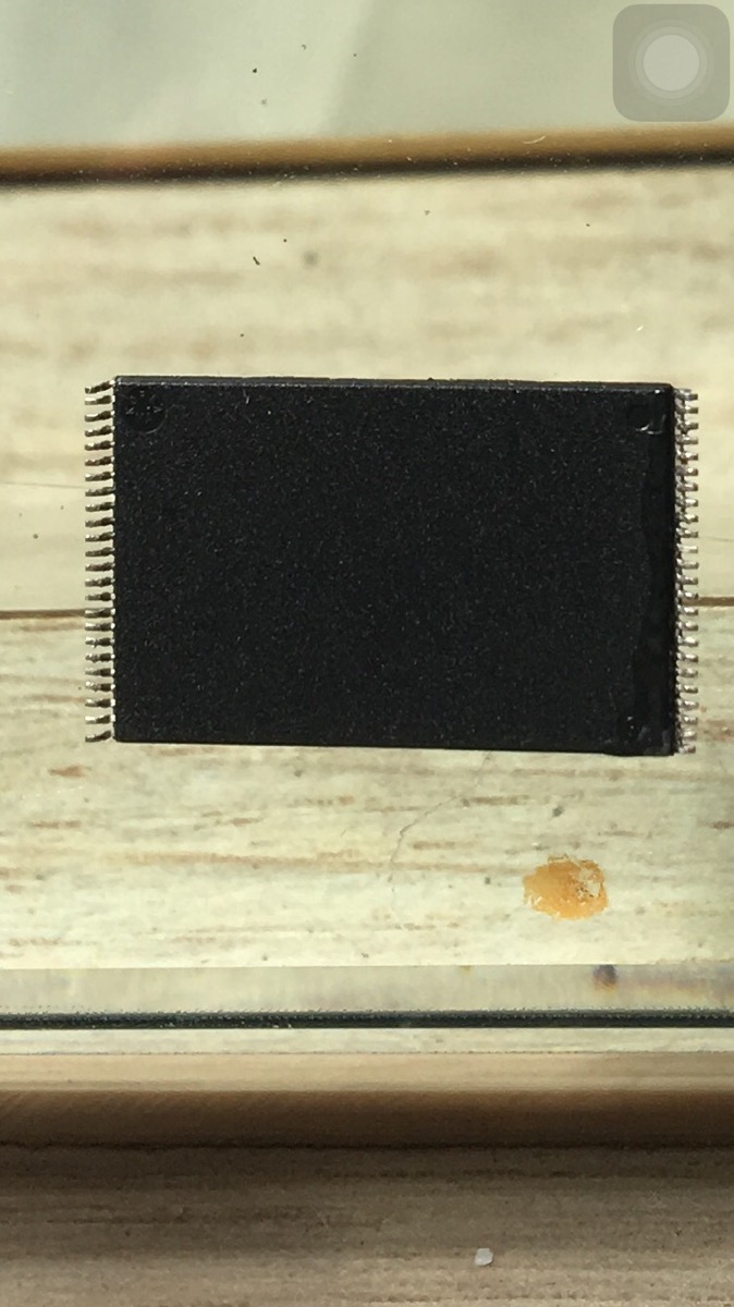

Look photos!
Нет ничего невозможного
 Post subject: Chipsbank CBM 2098S recovery
PostPosted: May 14th, 2016, 6:42
Posts: 456
sempre wrote:
Look photos!
This USB drive will require further manual work, but we should be able to recover the data from it.
