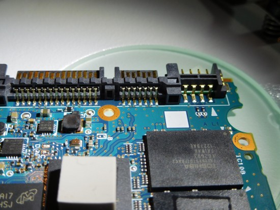

Some weeks ago my laptop did sporadically not recognize the SSD with OS (W7P). If I took the Laptop out of the dock it detected HDD and the system booted after a few tries. When the system was up and running I had few problems. Only some system freezes. So I did a full back up what was good because the situation went worse to that stage that the drive wasn't detected any more.
That is not quite right: when positioning the laptop vertically and applying pressure on the drive in the slot the drive was detected and the system booted some times.
The other strange thing was that sometimes I heard a strange buzzing sound from the hdd which should not be the case since it is an SSD.

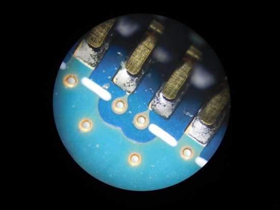

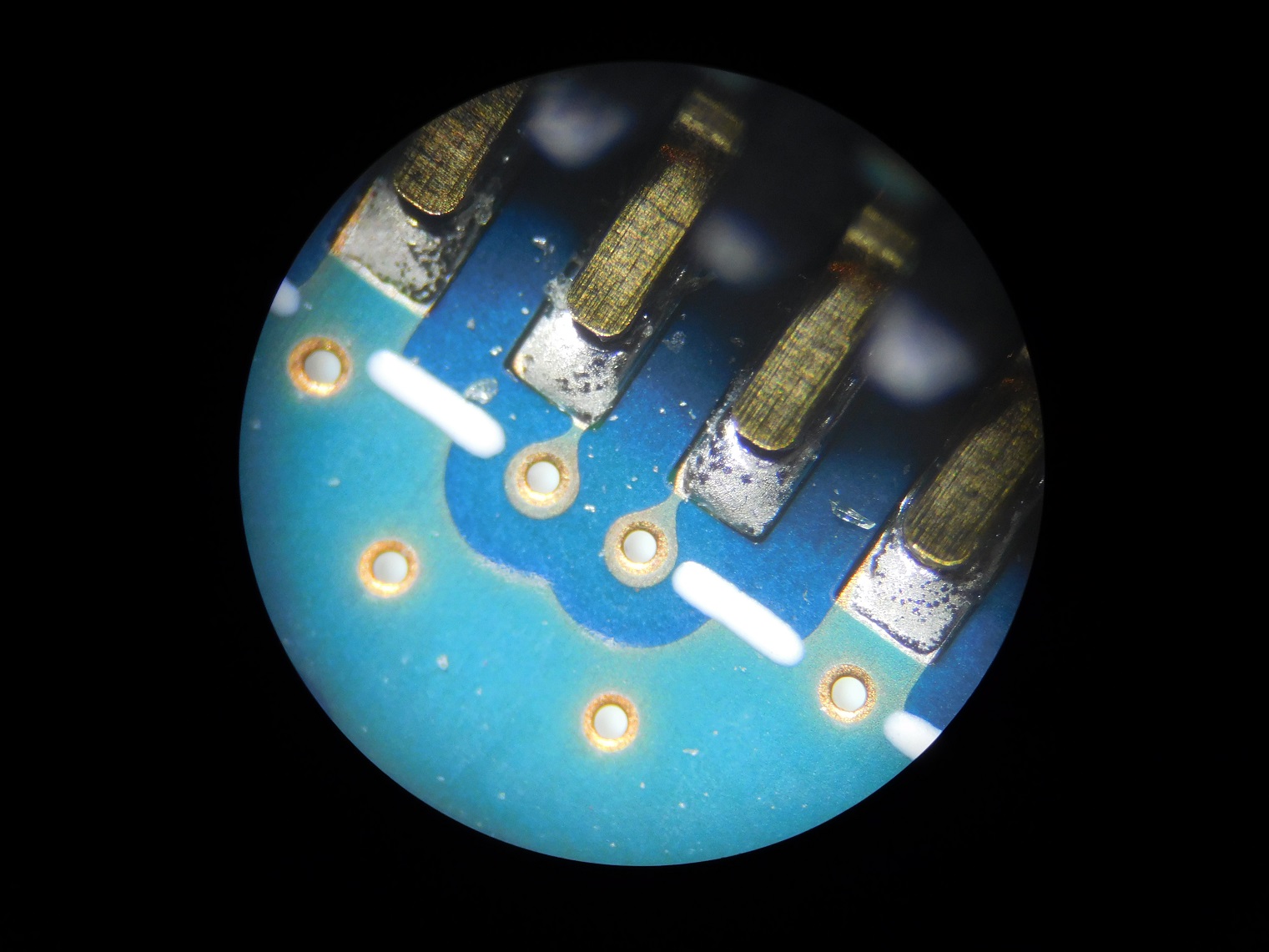

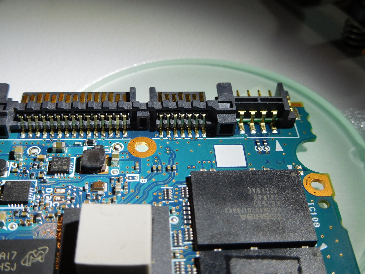

Looking on the connectors revealed that some of the connections from the small connector to the board were lose.
This might be the problem.
Why did this happen? Is the Laptop getting too hot?
Could one trust a drive where contacts are resoldered?
What do you think?

It won't hurt to reflow the solder joints.
Can you show us the drive's SMART report?
If the drive buzzes, then I would suspect that one of the coils would be responsible for the noise, in which case it could be that the coil is being overloaded by a short somewhere on the PCB. If so, and if this short comes and goes when the PCB is flexed, then I would suspect an intermittent MLCC (ceramic capacitor).

After resoldering the Pins on the SATA connector the drive was detected reliably.
System booted and seems to work. The Sound did not appear up to now.

I don't know what these numbers mean, but my intuitive feeling is that they are OK. The differences that stand out are in attribute 168 and the ATA Error Count.
