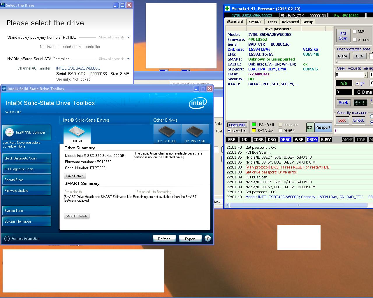

Hello
model ssdsa2bw6000g3 600GB
F/W 4pc10362
Flash Winbond 4 Mb
appendage
I have a programmer
someone has copies of the rom?

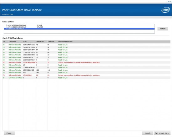

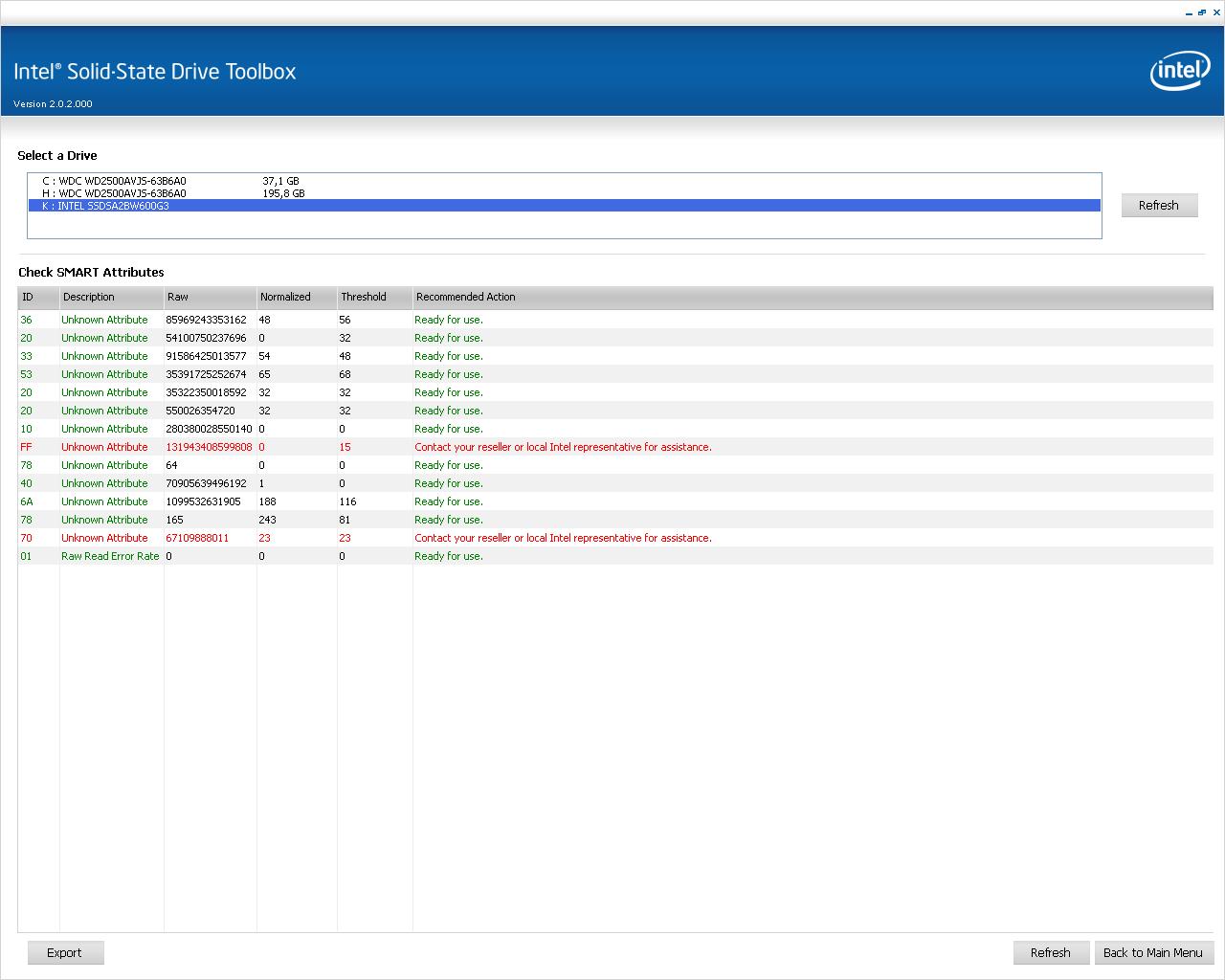

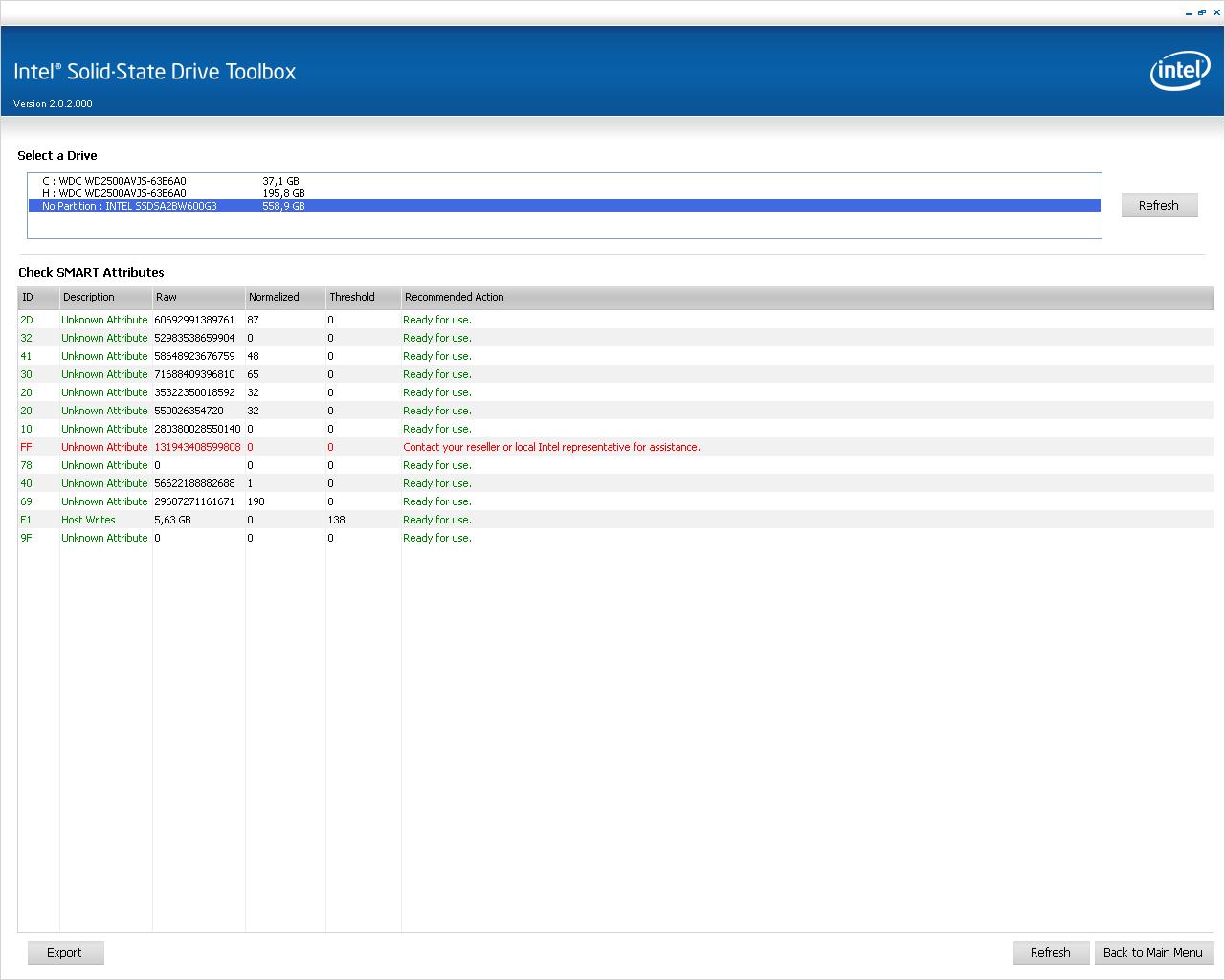

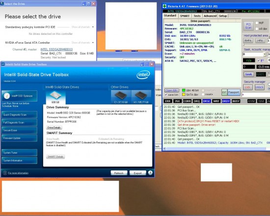

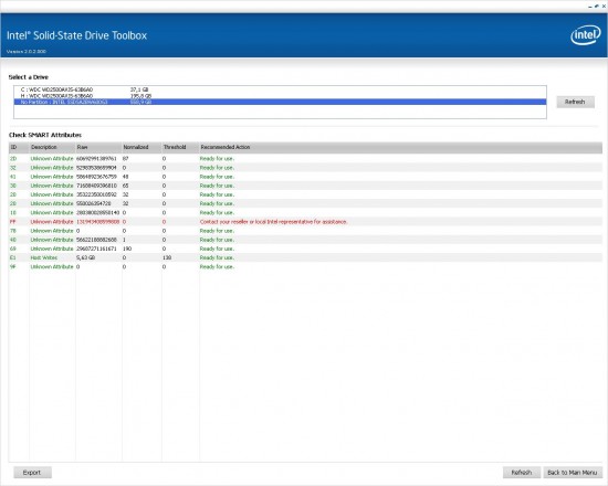

You have BAD_CTX issue, as i see at screenshots. So the problem is in Context module, that storing in NAND chips. You dont need do anything with ROM dump, it's fine.
PC3000 SSD supports drives with this issue. And i'm afraid, I've not heard about other tool that could handle it.
