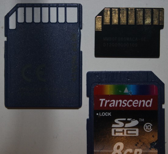

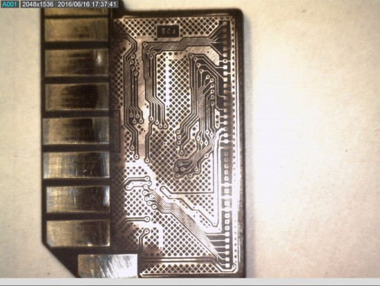

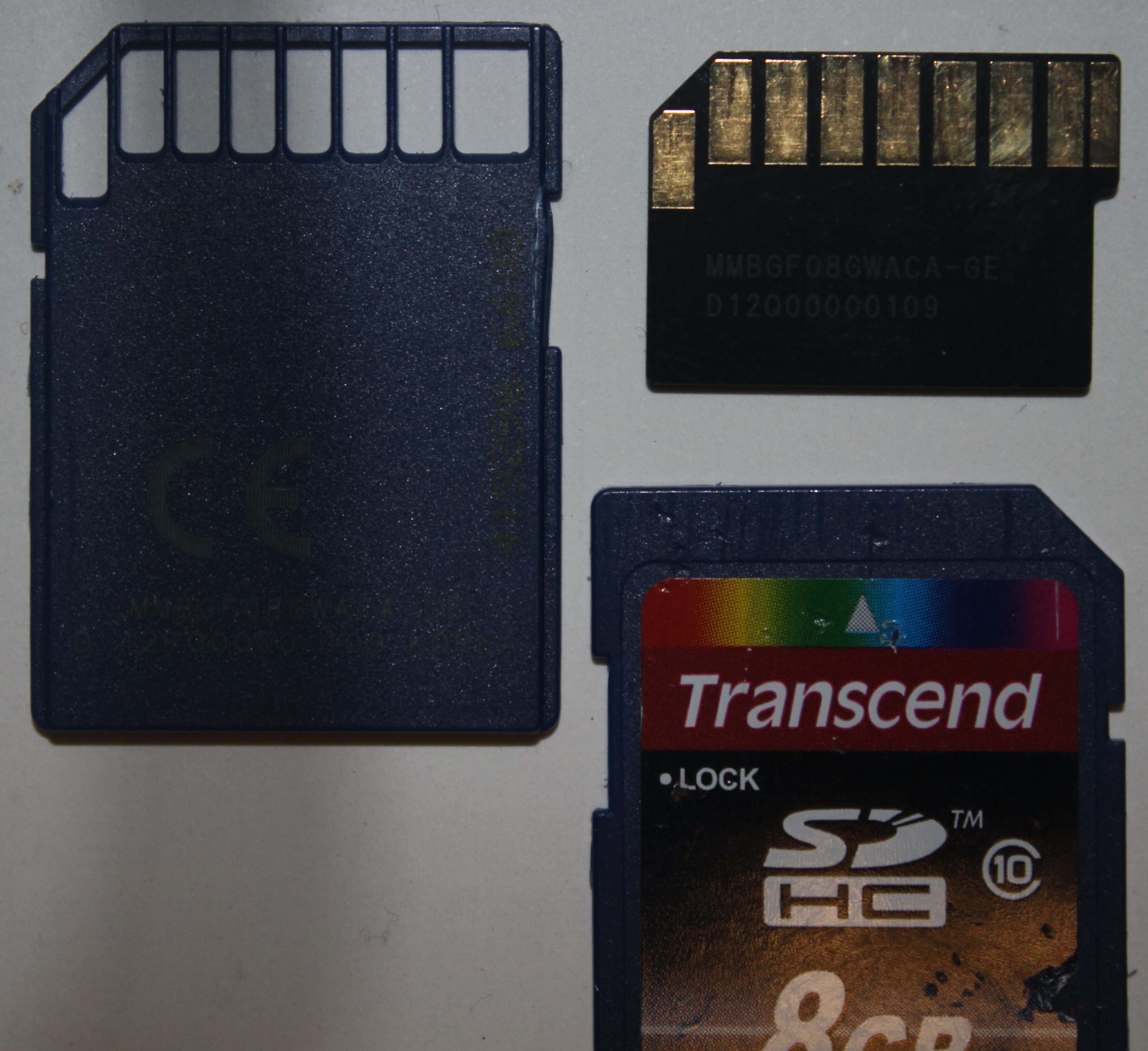

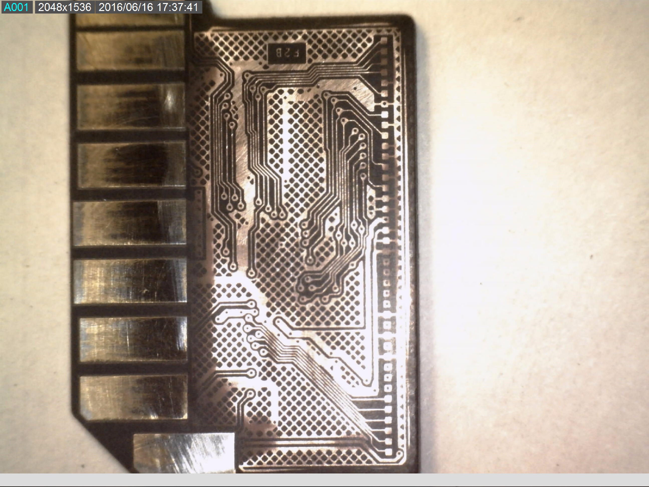

Hello everyone;
I have a monolithic SDHC, it seems that the controller is damaged and i can“t get the data from it, so i would like to know if there a possibility o recover the data from it, by connecting some wires to monolithics adapter, as PC 3000 adapter, The pictures below shows the type SDHC that i have. I'm not finding any kind of this SD Card. Any sugestions?
Thank you very much.

I have this pinout. http://odzyskiwanie-danych.com.pl/image ... arvika.jpg

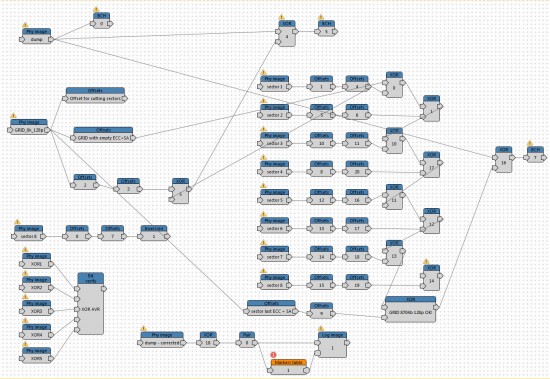

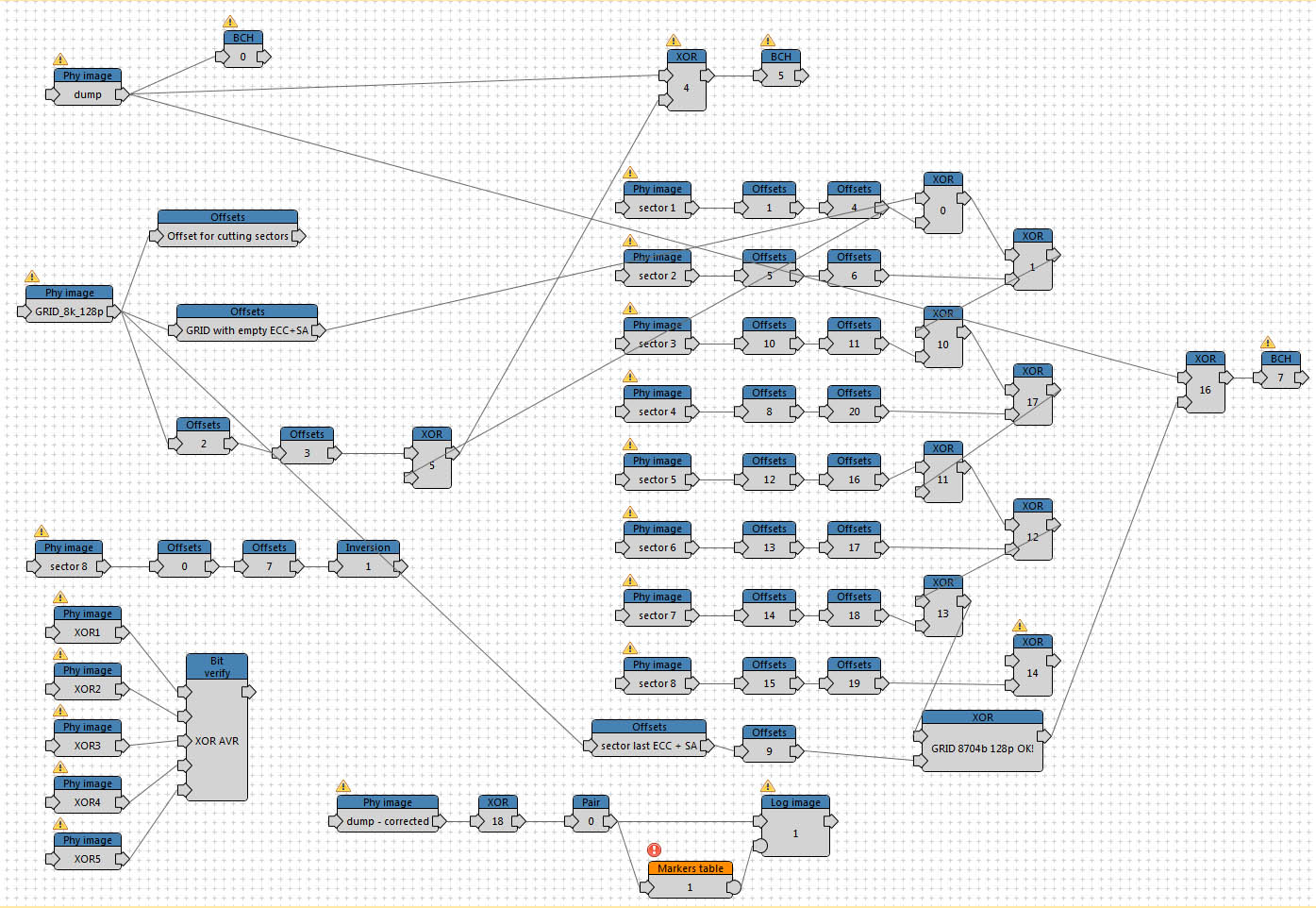

This could be tricky case. In this case probably there is two XORs (grid + standard XOR).
Last time I have similar case which was solved. It looks like this:
