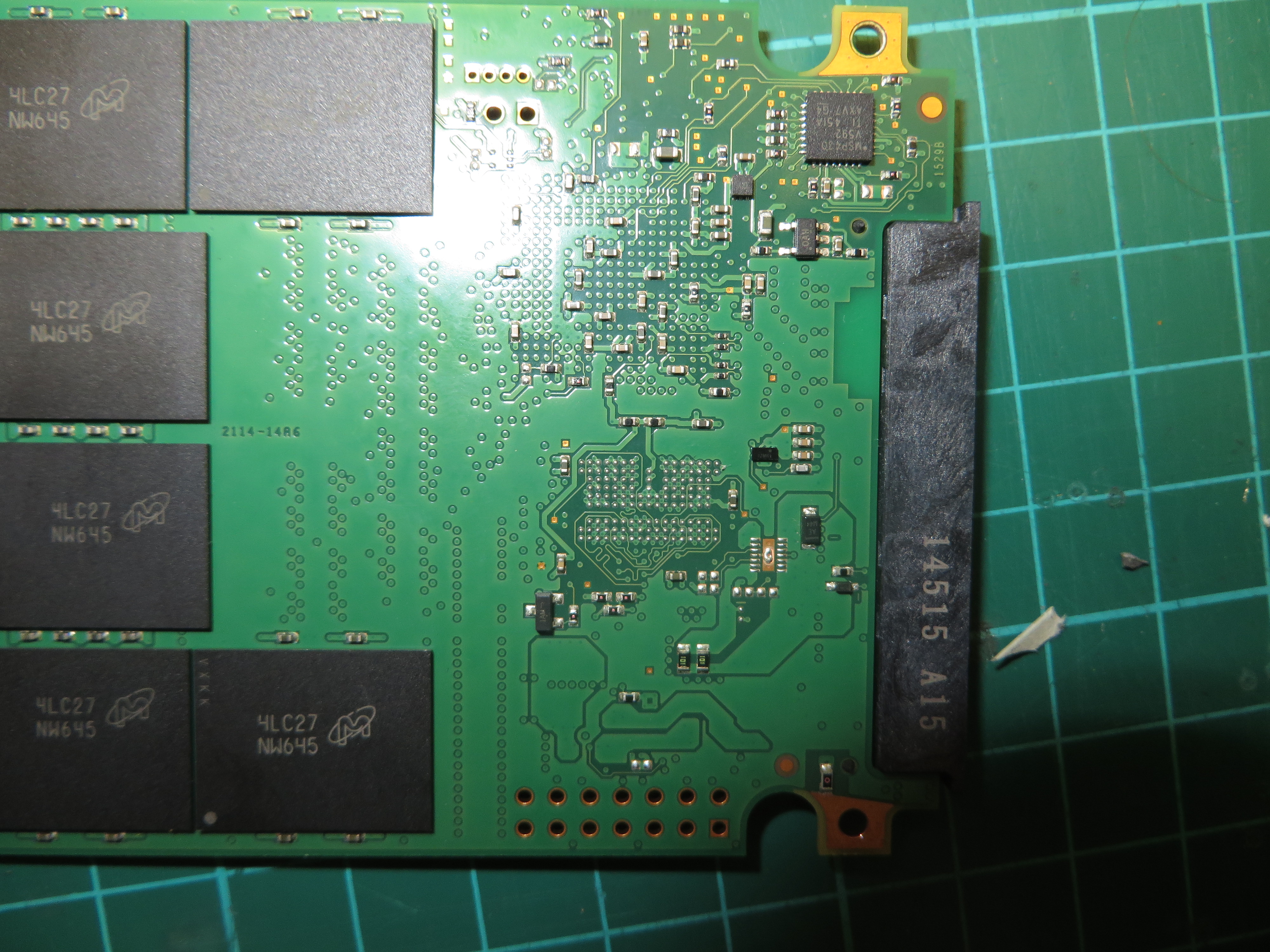

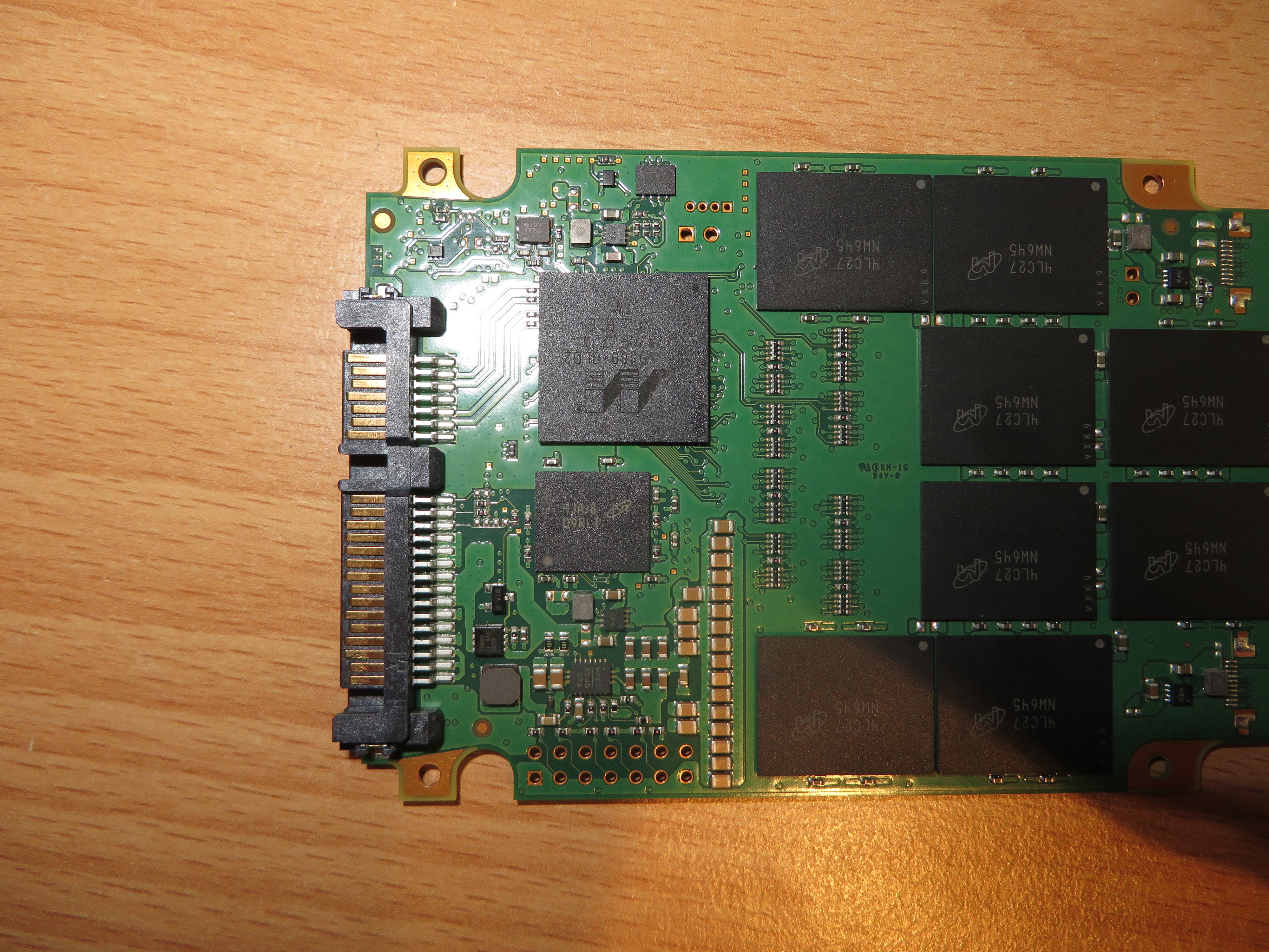

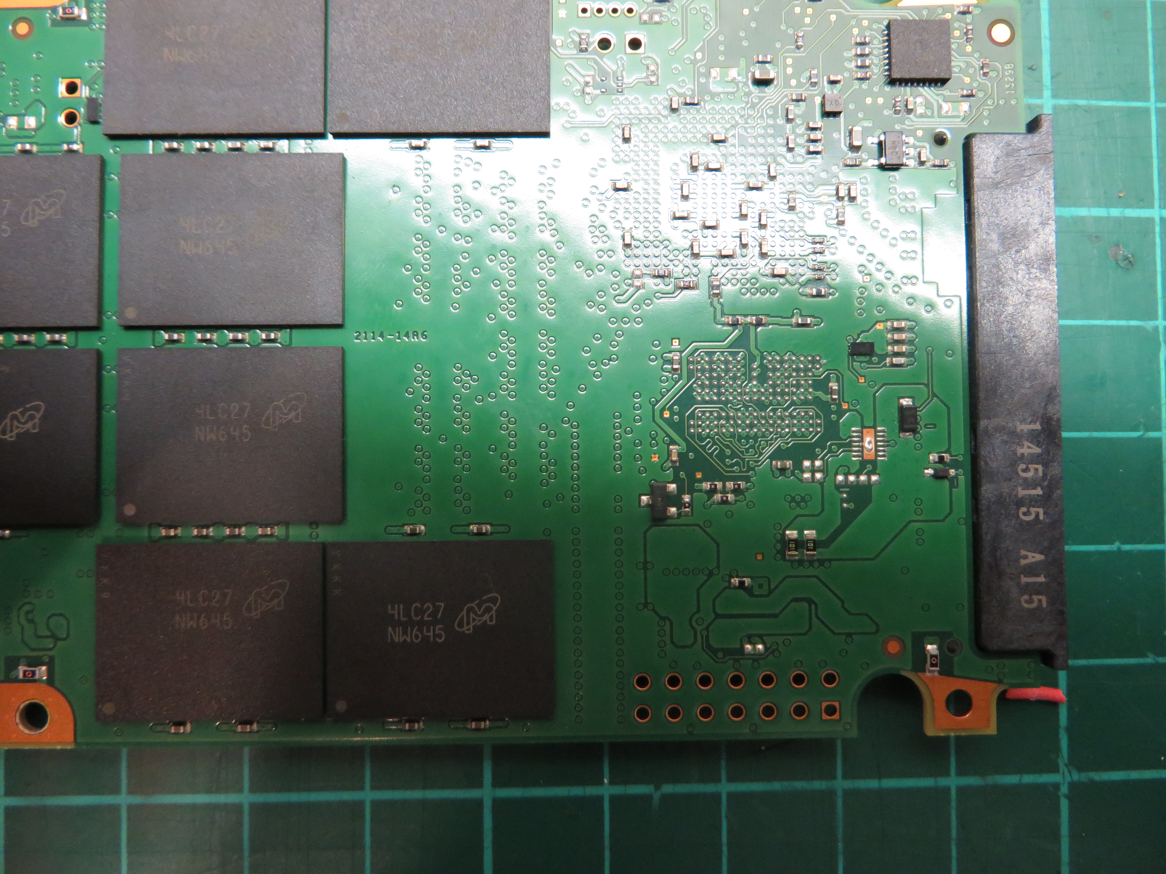

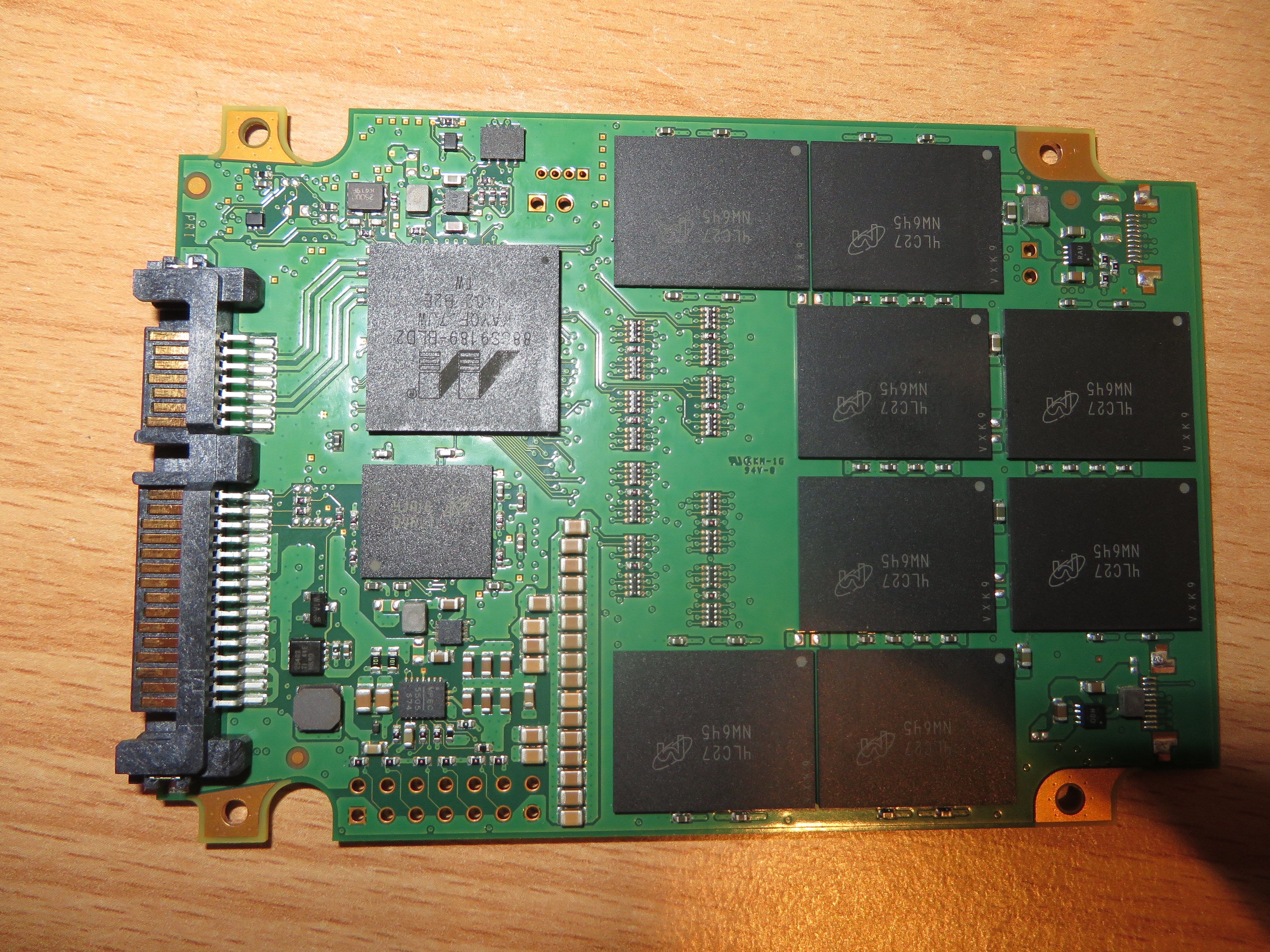

My server PSU failed and seems to have taken the SSD containing the OS with it. Now while I do have backups of the important bits of this OS drive, rebuilding the system from these backups would likely take about a day so I'm willing to invest some time into finding out if the SSD can be repaired.
Symptoms are simple and clear: BIOS doesn't detect the drive. POST isn't delayed, so there's no hang or failed init there.
I opened the drive and took some pictures (attached). Now I need some help determining what might be defective. The resistors marked 0-ohm are fine, but a lot of them are marked with a yellow/orange square and usually measure a different resistance over them. I also see some diodes but they don't appear to be TVS, at any rate they're not close-circuited.
Any points on where to go from here?

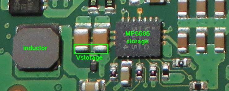

I'm not sure of some of the markings, but I have identified at least some of the supply voltages.

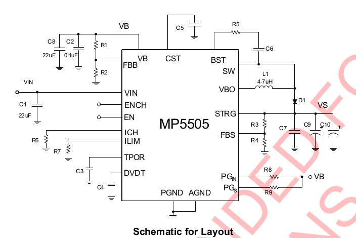

MP5505, Monolithic Power Systems, 7V, 4A, High-Efficiency Energy Storage & Management Unit, 2.7V-to-7V in, marking 5505, QFN20L:
https://www.monolithicpower.com/Desktop ... nt?id=2477

Oops, I have incorrectly identified two of the "RAU" chips. They should all be TLV62080 devices, not CSD25401.

I've performed the measurements (with only power cable attached, no data cable). The measurements are in the attached pictures.
Not sure if there's a plausible conclusion to be taken from this. I'll find out of the TLV chips are okay next.

The TLV62080 near V3 seems okay while the V1 and V2 ones might not be.
Does the 0.0V measured at Vstorage indicate the MP5505 is likely to require replacement as well?

The pins I have marked as 12V could be the problem (they should measure 3.3V). I suspected that you may have switched modular cables between PSUs, in which case the wrong voltages would have appeared on the SATA power pins.

Ouch. After checking, it appears you're indeed correct. The same-brand (be quiet) replacement PSU has similar modular cables (including matching notches etc.) but pin assignment is rearranged.
Guess I'm lucky only the one drive was connected.
Is there hope for this SSD?

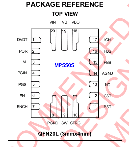

Check the EN(able) and ENCH inputs of the various chips. EN should be high if the chip is enabled, or low (0V) if the chip is disabled. I expect (and hope) that EN will be low, as this would point to a common factor.
There is a fourth regulator (V4) which is shrouded in darkness in one corner of the board.
The OAH LDO regulator has an input voltage (Vin) of only 2.75V. IIUC, this voltage is too low (Vout should be 3.3V), in which case the source of Vin must be suspect.
Can you measure the resistance between the Drain and Source pins of the MOSFET switch? As mentioned before, the Gate voltage is not consistent with an ON state.

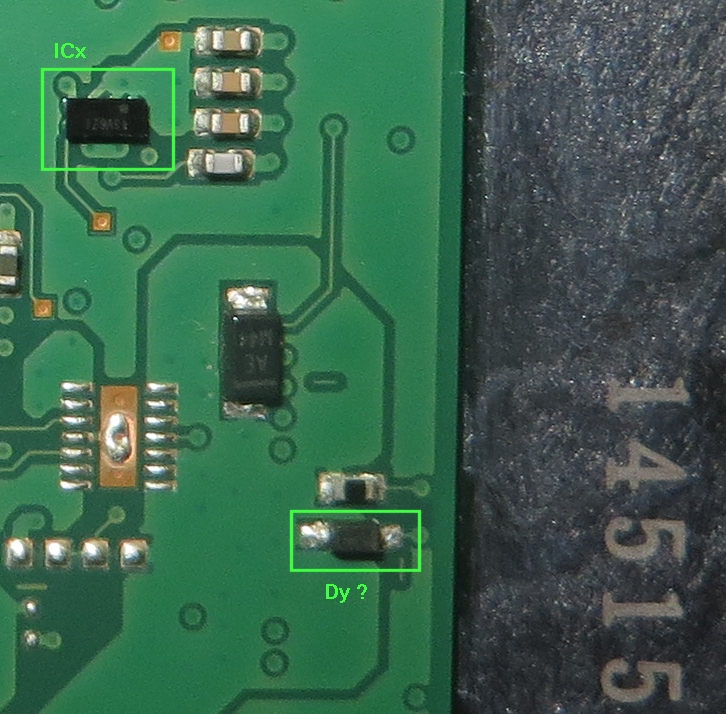

Can you identify the markings on ICx and Dy (does Dy have a polarity stripe?) ?
Can you measure the voltages on the capacitors adjacent to ICy? Is the IC marking CY or QY? I think I may have incorrectly identified it.
Each of the 4 (3x RAU, 1x ODH) enable pins are low.
V4 is at 0.0V.

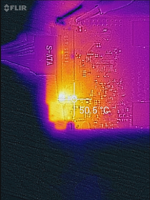

There's some heat generation in this IC (see flir attachment). I'm guessing this is the primary suspect.
With the power connector attached it's 25.2 ohms. With no power it's 24.8 ohms. I also re-checked the gate voltage, it's indeed 4.95V as reported earlier.
ICx is 43V6ZI I'm fairly certain. Unlikely, V may be Y, 6 may be G or 5, I may be 1 or lowercase L but I'm 95% confident my reading is correct.
Dy is much harder to read, it might be '5jw' but I'm only remotely certain about the 5. Cathode marking is on the SATA connector side. Voltage drop is 0.247V so I'm guessing it's a schottky.
Nice Flir image. May I ask what make/model of Flir imager you used?

Simple Flir ONE android. They've been sold out everywhere or offered at an extreme premium in Europe, but I got a chance to buy one in the US for $240.

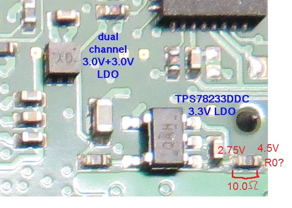

I did some more measurements near the 3.3V LDO. See attached picture, I believe there's a 10 Ohms resistor nearby with 4.5V coming into it and only 2.75V getting into the regulator.
I removed the component. It's indeed a 10Ohm resistor. Now I measure 5.0V on the left side and 0.0V on the input on the regulator.

FWIW, here is a datasheet for the MSP430F1122 chip:
http://www.ti.com/lit/ds/symlink/msp430f1122.pdf
It appears to have a different pinout, but its max current rating in active mode at Vcc=3V is 350uA. However, a voltage drop of 1.75V across a 10 ohm resistor corresponds to a current draw of 175mA, so I'd say that the MSP430 is dead, assuming that it is the only device powered from this supply. You could isolate the capacitor on the 3.3V output, just to be certain that it is not the culprit.
Edit: A similar voltage drop across the 10 ohm resistor at Vout would account for the 0.9V measured voltage (2.6V - 1.75V = 0.85V).
Edit #2: Measure the resistance between the 0.9V point and ground.
