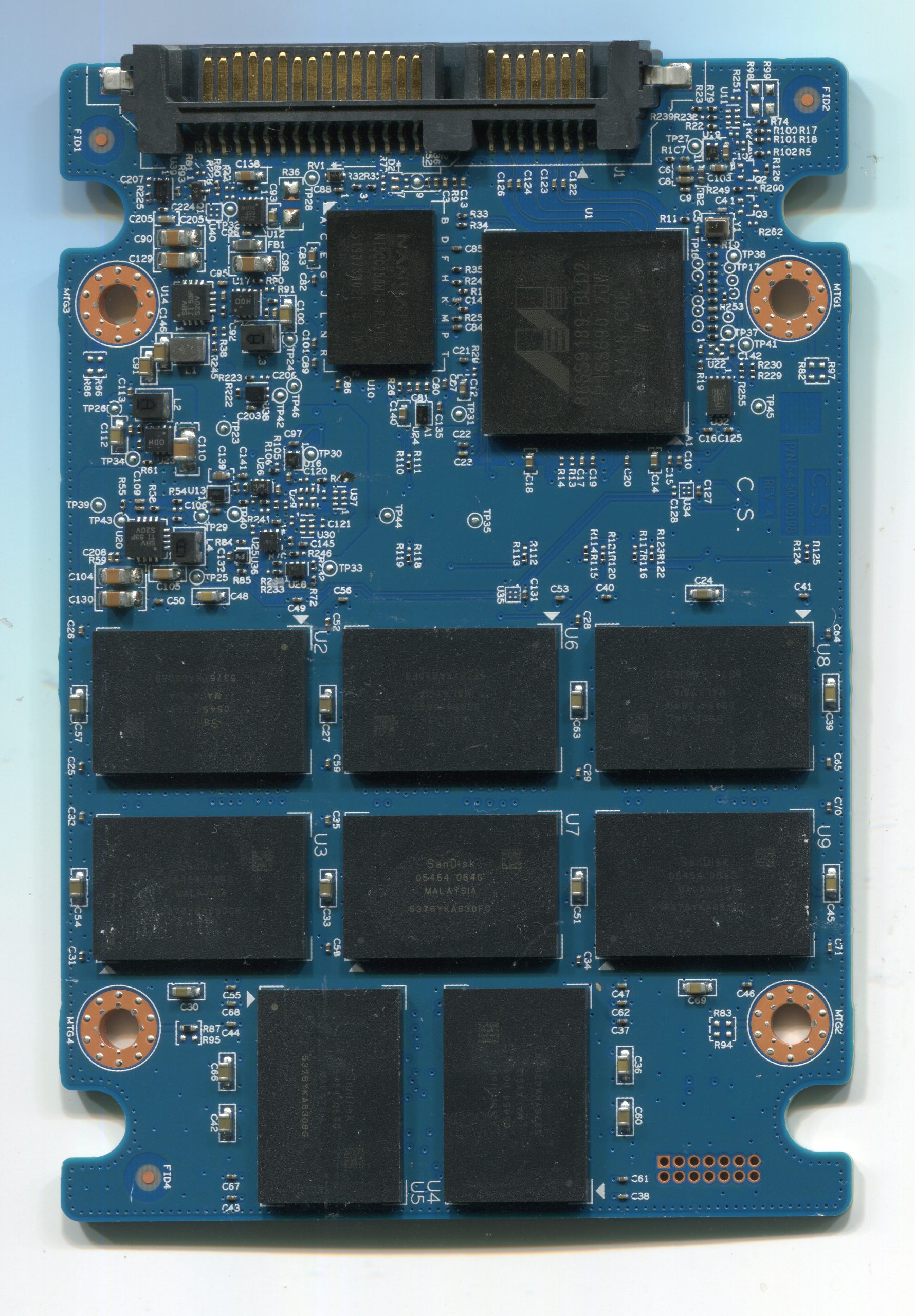

This present with all status lights dimmed, but for the life of me I can not find anything wrong with the board. I've already purchased 8 donors looking to find a comparison drive or even just to move nand/controller but none are the matching pcb and use the 88SS1074 controller instead.
Anyone been here before or even have a working donor PCB for beer tokens, nobody I've asked has one either.
AFAICS all the voltages are present and as expected, no shorts to ground anywhere. Drive goes instantly to a constant 170mA no sign of any startup sequence, 3v on terminal pads (7/9) but no output at all.
TP values :
23 : 3.04
24 : 1.36
25 : 1.05
26 : 1.81
27 : 2.49
28 : 4.82
29 : 3.04
30 : 1.79
31 : 1.36
32 : 0 (Boost?)
33 : 1.36
34 : 1.33
35 : 0 - GND
37 : 1.04
38 : 1.79
39 : 4.77
40 : 2.99
41 : 3.04
42 : 3.02
43 : 1.51
44 : 0 - GND
45 : 0 - GND

Lardman wrote:
32 : 0 (Boost?)
have you been able to find where this TP connects ?

westcoast wrote:
Lardman wrote:
32 : 0 (Boost?)
Not had the chance yet, there's 10v floating around on u12 though. The power IC's were delivered today, I doubt any are bad but I'm going to swap them out anyway just in case. If I can find the same sdram on another board I might as well swap that too.

Lardman wrote:
... there's 10v floating around on u12 though.
U12 is a "TPS22965 5.7-V, 6-A, 16-mΩ On-Resistance Load Switch":
https://www.ti.com/lit/ds/symlink/tps22965.pdf
I can't see where 10V would come from. :-?
 Post subject: Re: SDSSDHII-480G
PostPosted: April 23rd, 2025, 22:25
Joined: June 27th, 2020, 8:58
Posts: 60
Location: europe
that's true. and U14/U20 are TLV62090 converters 2.5-5.5V
as there is no energy storage, this drive shouldn't have more than 5V anywhere
PostPosted: April 24th, 2025, 3:05
Posts: 1319
I've doubled checked this morning as it wouldn't be the first time I'd misread the scale on the meter, and pin 6 is definitely 9-10v - 7, 8 are 4.8v though. Pin 6 goes only to cap C96 with is grounded. TP32 is connected to U40 and r44? which are both no stuff.
I'll pull the ROM as @gold6565 suggested next and no doubt struggle for a few hours trying to get my revelprog to read it :roll:
Short the first pin of the ROM to ground. This is the safe ATA mode. Turn on the SSD, it won't take long.
I've already removed it. No change in the drive status other than a slight drop from 270mA to 220mA, still no output on terminal.

Lardman wrote:
If the readiness registers do not light up when the ROM is disabled, then most likely there are problems with the processor or its connection. The terminal will not be in this mode.

gold6565 wrote:
... most likely there are problems with the processor or its connection.
It's been looking that way hence my search for a donor, it's just unusual for me to see one that's failed without obvious reason.

westcoast wrote:
if you got new TPS22965 remove it and compare pins
CT would limit inrush current, if something cracked there, maybe it hogs the cpu
I did, no change.

Location: europe
ridiculous that they did not mention in datasheet this pin can have 10v
if you checked ODH output on scope i bet it wouldn't look like in datasheet (and i'm guessing its fine on my unit too)
texas instuments - i'd thought they would do better job than this

Posts: 17323
The block diagram for the load switch shows a charge pump for the N-channel MOSFET. That must be the reason for the 10V reading. However, the datasheet says that the CT pin can be left floating. :-?

Location: europe
from what i've read on vlab - no status lights -> CPU to trash

Posts: 4848
cpu fault is only one of the many possible causes.
