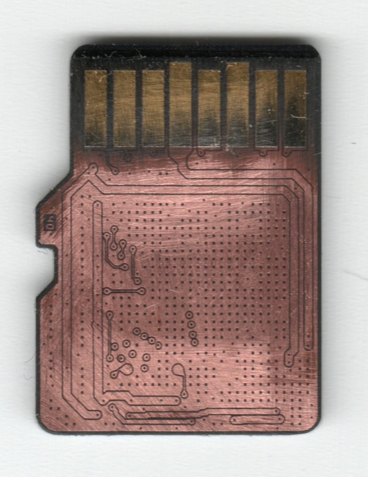

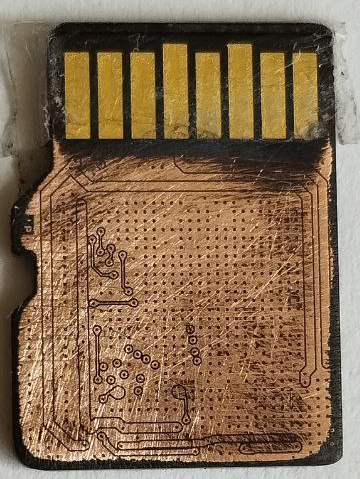

I'm looking for pinout for MicroSD Smartbuy 8GB. Does anyone know?

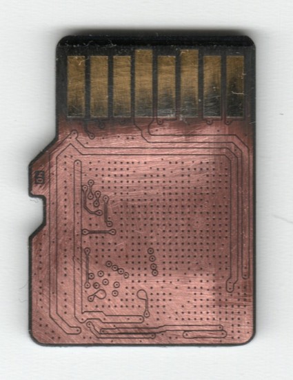

I had it once. Didn't find any databus in the top layer. Just found WE,CLE,ALE, CE, RB. So i think some lines are in the second layer. Attached a better quality photo.
Zdjęcie WhatsApp 2024-09-21 o 16.50.10_6a0c70df.jpg [ 349.07 KiB | Viewed 4995 times ]
