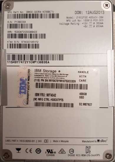

We're decommissioning two IBM DS8800 at work and I have about 200 x 400GB SSD drives, that I don't know what to do with. A first this seemed like a nice problem to have, although they are SAS drives, they still have a decent size and they are enterprise grade :D
Well unfortunatly I've run into the issue that these SSD's are branded and I cannot get them to work in a normal server. I have tested several of the SSD's and it's the same with all of them.

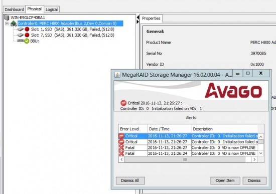

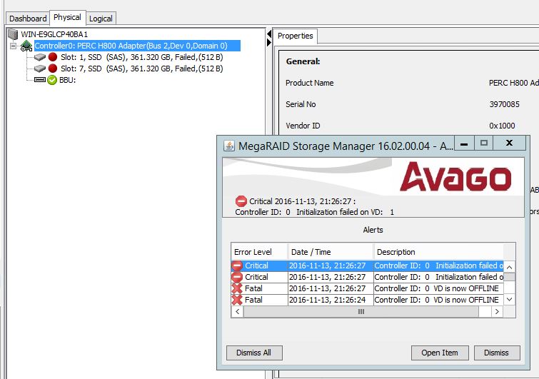

As soon as I try and set the drive online or create a new raid set, then the disks go into a failed state.
Disk details:
sTec model: Z16IZF2E-400UCV
IBM FRU: 98Y4042
Is there any way I can get life back into these disks? FW upgrade/downgrade, special tools, special SAS controller, etc.

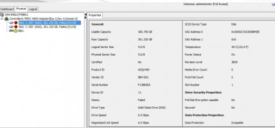

Have you wiped the drives clean before attempting to put the drives into a new configuration? The controller might be recognizing them as drives that belong to a different RAID.

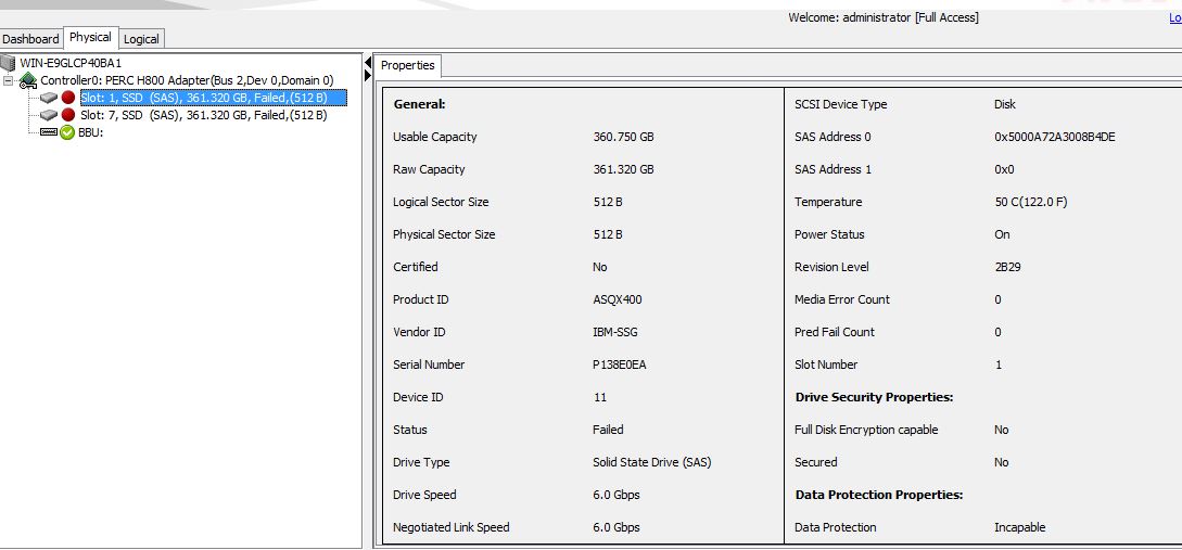

Yes, I've tried clearing the configuration and when scanning for a foreign config, the controller responds with "No foreign configuration found"

I've tried changing the SAS controller, they accept all disks (Dell and Non-Dell) except the IBM disks :-(
