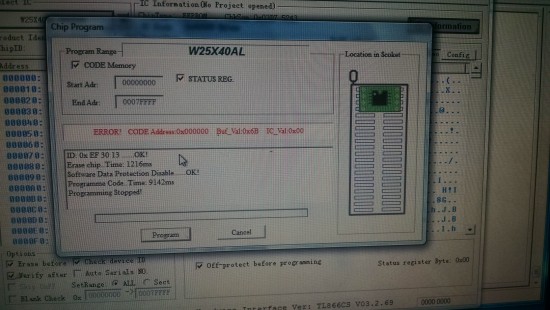

Help !! On writing rom using programmer giving that error.

The chip you're trying to program is a W25X40AL ?
yes bro

Remove the V from check device ID.

Could be a bad ROM chip.
Have you tried writing zero blocks first to see if you still get errors?
