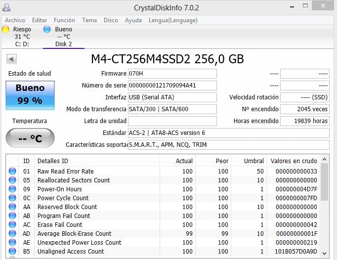

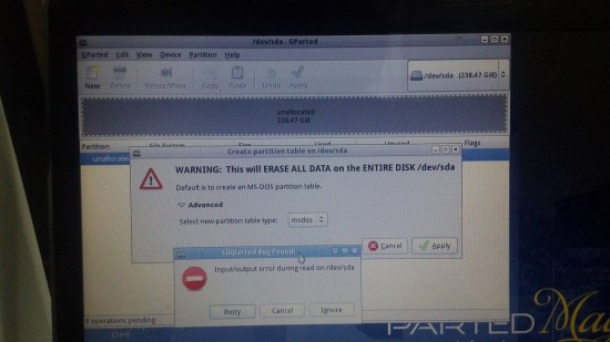

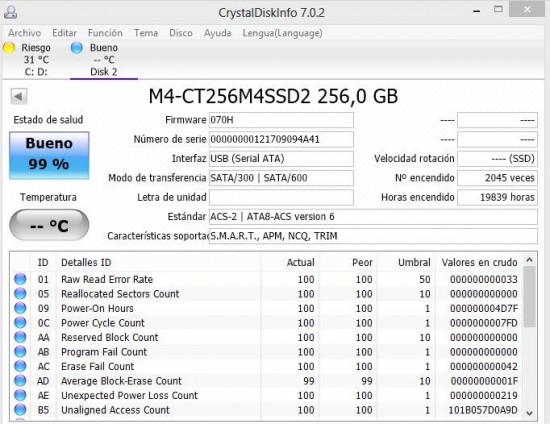

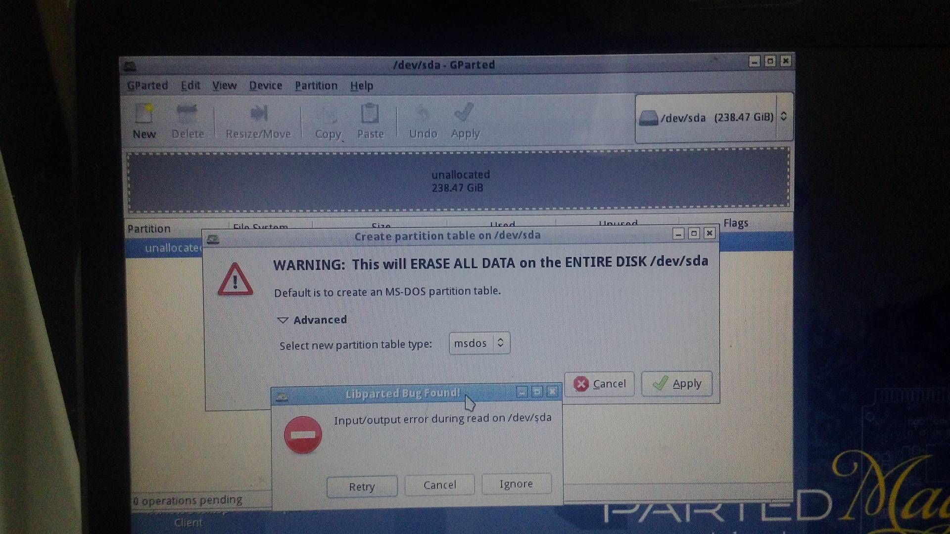

Hello, having a problem with my 3 years old M4 256Gb when try to get a secure erase. Attaching some pictures to show my problem. The drive is fully recognized on IDE mode but not on AHCI.
Secure-Erase-Log-2016-08-23-1748-Advanced.txt [8.23 KiB]
Downloaded 1253 times
The log error from Parted Magic (Secure Erase)

smartctl 5.43 2012-06-30 r3573 [i686-linux-3.10.18-pmagic] (local build)
Copyright (C) 2002-12 by Bruce Allen, http://smartmontools.sourceforge.net
=== START OF INFORMATION SECTION ===
Model Family:     Crucial/Micron RealSSD C300/C400/m4
Device Model:     M4-CT256M4SSD2
Serial Number:    00000000121709094A41
LU WWN Device Id: 5 00a075 109094a41
Firmware Version: 070H
User Capacity:    256,060,514,304 bytes [256 GB]
Sector Size:      512 bytes logical/physical
Device is:        In smartctl database [for details use: -P show]
ATA Version is:   8
ATA Standard is:  ATA-8-ACS revision 6
Local Time is:    Tue Aug 23 17:48:07 2016 UTC
SMART support is: Available - device has SMART capability.
SMART support is: Enabled
=== START OF READ SMART DATA SECTION ===
SMART overall-health self-assessment test result: PASSED
General SMART Values:
Offline data collection status:  (0x80)   Offline data collection activity
               was never started.
               Auto Offline Data Collection: Enabled.
Self-test execution status:      (   0)   The previous self-test routine completed
               without error or no self-test has ever
               been run.
Total time to complete Offline
data collection:       ( 1190) seconds.
capabilities:           (0x7b) SMART execute Offline immediate.
               Auto Offline data collection on/off support.
               Suspend Offline collection upon new
               command.
               Offline surface scan supported.
               Self-test supported.
               Conveyance Self-test supported.
               Selective Self-test supported.
SMART capabilities:            (0x0003)   Saves SMART data before entering
               power-saving mode.
               Supports SMART auto save timer.
Error logging capability:        (0x01)   Error logging supported.
               General Purpose Logging supported.
Short self-test routine
recommended polling time:     (   2) minutes.
Extended self-test routine
recommended polling time:     (  19) minutes.
Conveyance self-test routine
recommended polling time:     (   3) minutes.
SCT capabilities:           (0x003d)   SCT Status supported.
               SCT Error Recovery Control supported.
               SCT Feature Control supported.
               SCT Data Table supported.
SMART Attributes Data Structure revision number: 16
Vendor Specific SMART Attributes with Thresholds:
ID# ATTRIBUTE_NAME          FLAG     VALUE WORST THRESH TYPE      UPDATED  WHEN_FAILED RAW_VALUE
  1 Raw_Read_Error_Rate     0x002f   100   100   050    Pre-fail  Always       -       51
  5 Reallocated_Sector_Ct   0x0033   100   100   010    Pre-fail  Always       -       0
  9 Power_On_Hours          0x0032   100   100   001    Old_age   Always       -       19839
12 Power_Cycle_Count       0x0032   100   100   001    Old_age   Always       -       2045
170 Grown_Failing_Block_Ct  0x0033   100   100   010    Pre-fail  Always       -       0
171 Program_Fail_Count      0x0032   100   100   001    Old_age   Always       -       0
172 Erase_Fail_Count        0x0032   100   100   001    Old_age   Always       -       66
173 Wear_Levelling_Count    0x0033   099   099   010    Pre-fail  Always       -       31
174 Unexpect_Power_Loss_Ct  0x0032   100   100   001    Old_age   Always       -       537
181 Non4k_Aligned_Access    0x0022   100   100   001    Old_age   Always       -       4123 1405 2717
183 SATA_Iface_Downshift    0x0032   100   100   001    Old_age   Always       -       0
184 End-to-End_Error        0x0033   100   100   050    Pre-fail  Always       -       0
187 Reported_Uncorrect      0x0032   100   100   001    Old_age   Always       -       0
188 Command_Timeout         0x0032   100   100   001    Old_age   Always       -       0
189 Factory_Bad_Block_Ct    0x000e   100   100   001    Old_age   Always       -       82
194 Temperature_Celsius     0x0022   100   100   000    Old_age   Always       -       0
195 Hardware_ECC_Recovered  0x003a   100   100   001    Old_age   Always       -       100707
196 Reallocated_Event_Count 0x0032   100   100   001    Old_age   Always       -       0
197 Current_Pending_Sector  0x0032   100   100   001    Old_age   Always       -       0
198 Offline_Uncorrectable   0x0030   100   100   001    Old_age   Offline      -       0
199 UDMA_CRC_Error_Count    0x0032   100   100   001    Old_age   Always       -       0
202 Perc_Rated_Life_Used    0x0018   099   099   001    Old_age   Offline      -       1
206 Write_Error_Rate        0x000e   100   100   001    Old_age   Always       -       0
Read SMART Log Directory failed.
Error SMART Error Log Read failed: scsi error aborted command
Smartctl: SMART Error Log Read Failed
Error SMART Error Self-Test Log Read failed: scsi error aborted command
Smartctl: SMART Self Test Log Read Failed
Error SMART Read Selective Self-Test Log failed: scsi error aborted command
Smartctl: SMART Selective Self Test Log Read Failed

ISTM that your first screenshot is reporting an error when the software attempts to read sector 0 of the SSD. Is your SSD now read/write locked?
Hello, thanks for your reply.
This part of the log that i post say it's not locked. But when i use "diskpart" on Windows it shows "read only: Yes"

I noticed that i only can read my SSD if SATA controller is on IDE but not on AHCI mode.

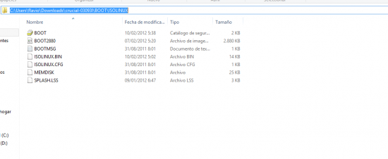

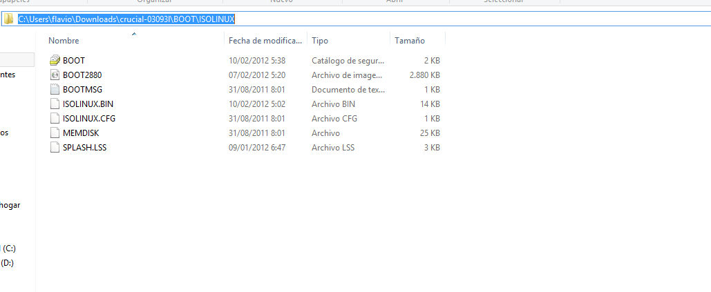

FWIW, there is a DOSMCLI.EXE utility that is packaged with Micron/Crucial firmware updates. It is able to perform a "low-level format".
    --low-format <x> Perform a low-level format of the specified drive.
That said, if you can read the drive in IDE mode, I can't see how there could be a problem with it. :?

Could you explain me more about "DOSMCLI.EXE" or how to use?
"read" wasn't a correct word, i mean "see" or "detect" on my system.

fzabkar, when i unzip the .img it doesn't contain any item called "dosmcli.exe"

Drill down to this level (or equivalent):
sp62063.exe\\MicronSEDUpdate.exe\.rsrc\RCDATA\107\
Edit: When you are "drilling down" through the levels, r-click each level and select "open inside".

This is what i got from .zip
 Post subject: Re: SSD Crucial M4 256GB I/O error
PostPosted: September 1st, 2016, 2:31
Posts: 17223
Expand BOOT2880.
