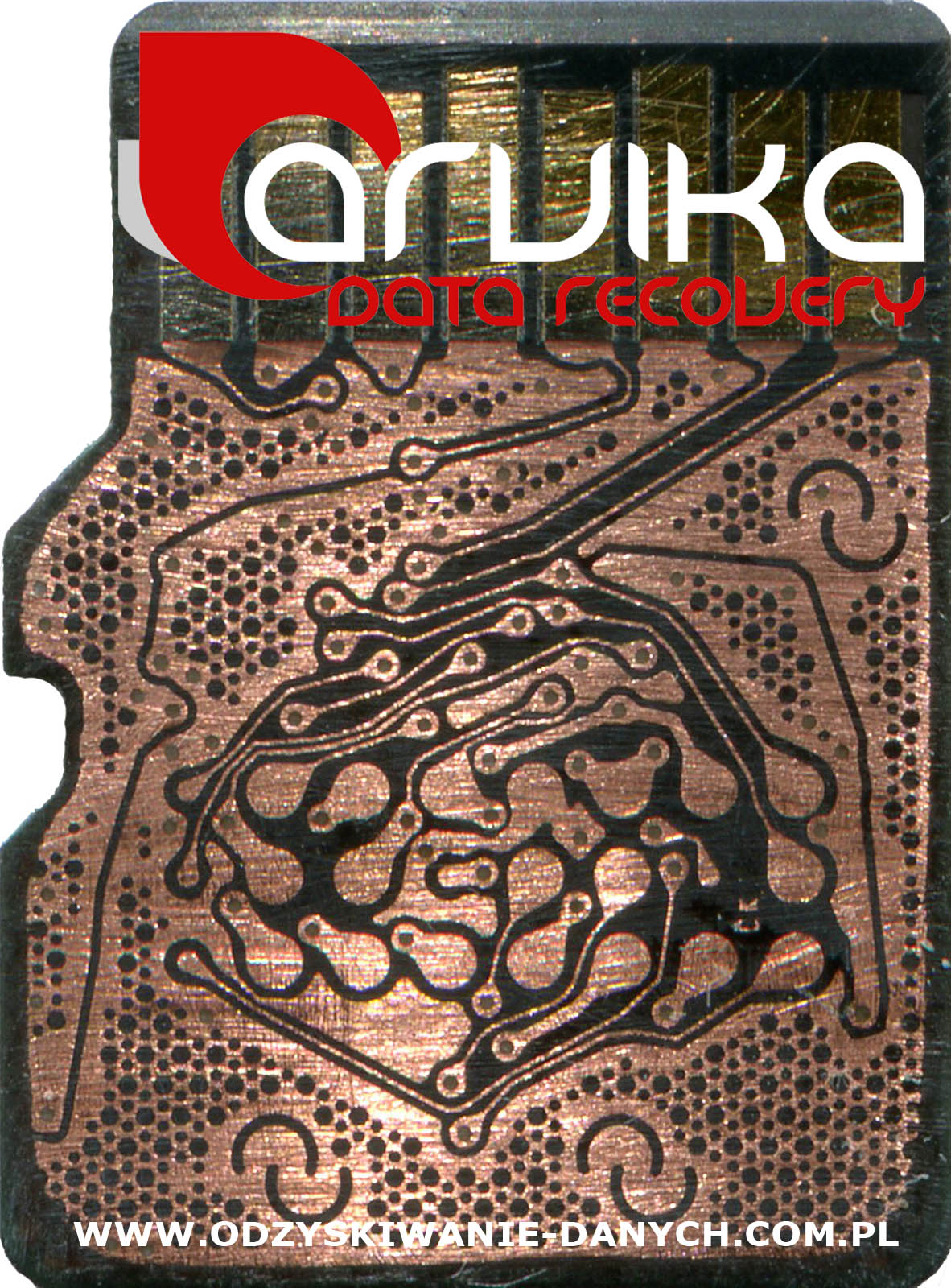

Arvika logged in and its been determined that this is a 16 bit MicroSD Card but there is no pinout in either PC3K Flash of VNR. Anyone happen to have the pinout?
What prevents you from figuring out the pinout?

PostPosted: November 4th, 2016, 0:26
Posts: 1777
Location: Phoenix, AZ USA
I have no idea how to. Any pointers would be appreciated.
