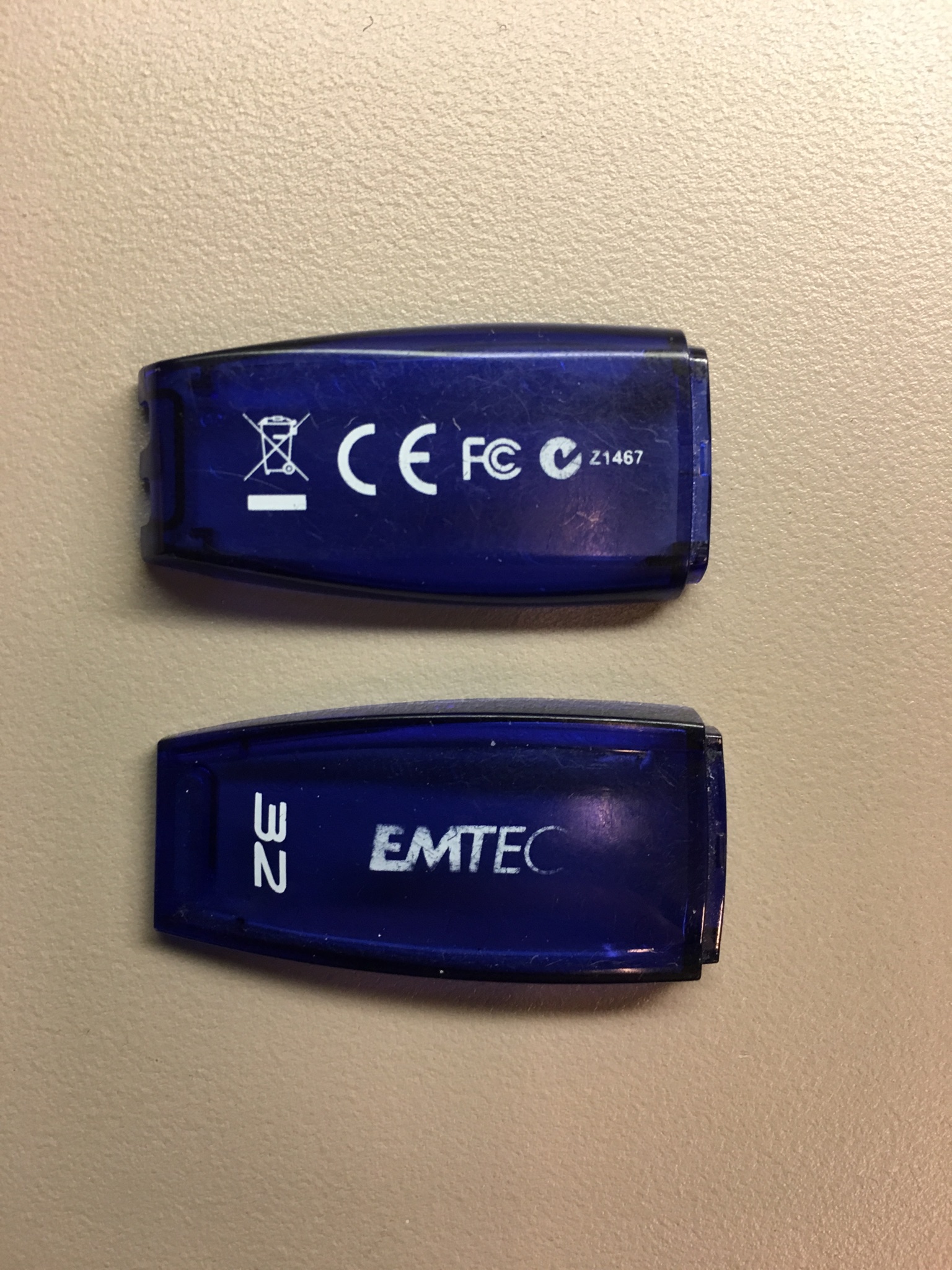

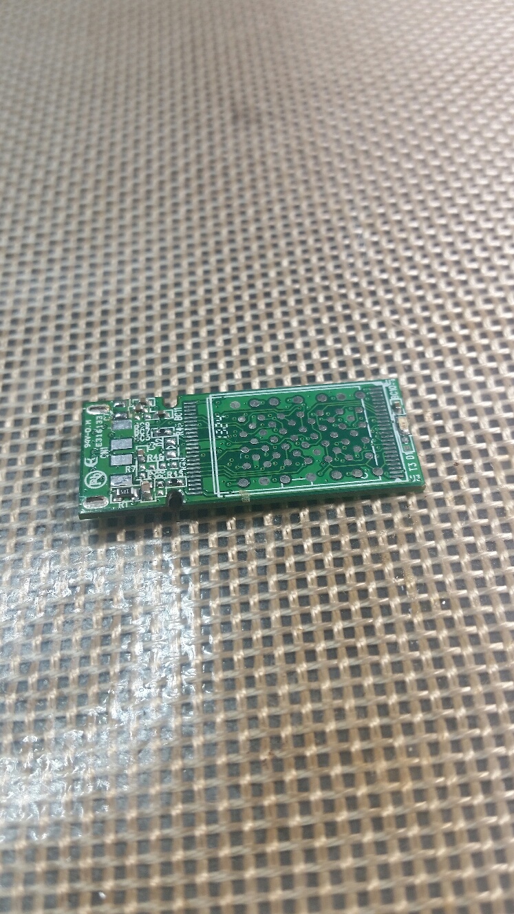

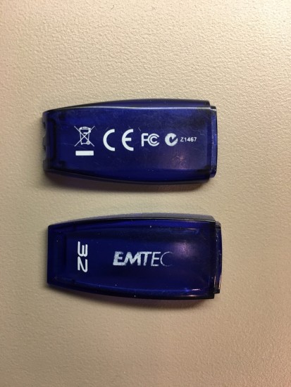

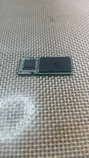

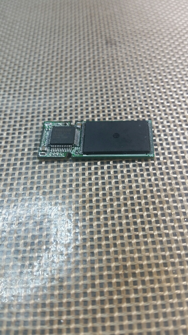

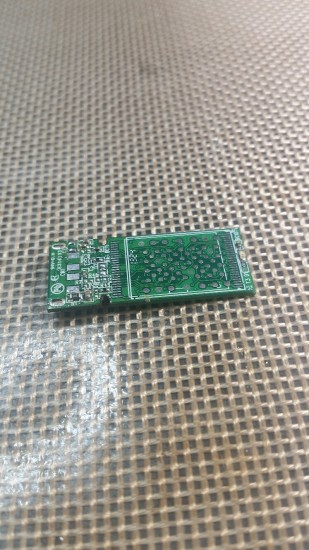

I am looking for a donor for this Flash Drive. I have purchased aout 10 from different sources but they all have either a different chip (eMMC) or a different controller. I am looking for a single TSOP 48, with a PS2251-67-5 controller. Client had his IT department 'work' on the board that why it looks a bit hacked up.
