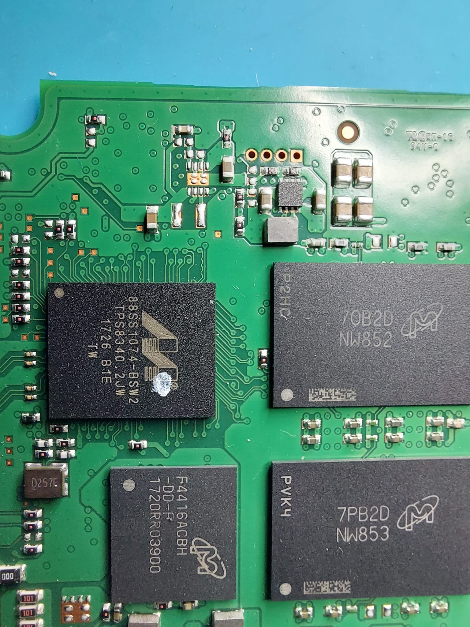

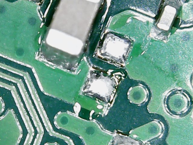

Author:  valy1965 [ May 28th, 2023, 13:11 ]
Post subject:  Re: SanDisk Ultra II not detected (data recovery options?)
Carefully check all the capacitors, I found one in short circuit.
Greetings.
