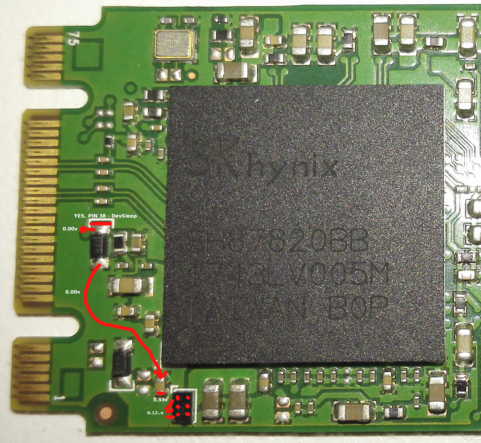

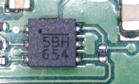

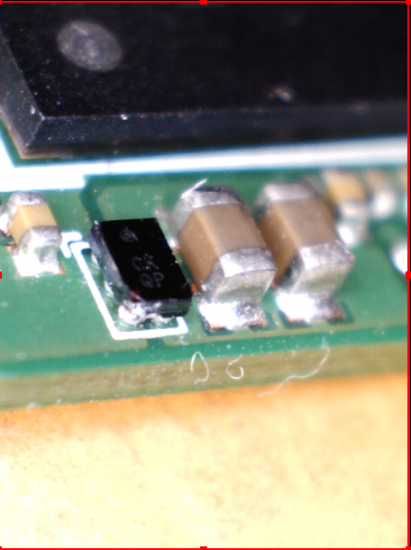

Please help me for find this component or any info.
Micro bga 6 ball
Enter a 3,3V and out 0V
Thank you for any info

Could we see the whole PCB? Sometimes it is easier to identify the IC when it is viewed in the context of its surroundings.
 Post subject: Re: SK Hynix SC308 hfs256g39tnd-n210 need a component name
PostPosted: May 12th, 2020, 4:04
Posts: 17134
I suspect that the part may be a load switch or a P-channel MOSFET, probably controlled from the DevSlp input.
PostPosted: May 12th, 2020, 4:29
Posts: 17134
It's not the correct part, but it could be something like this:
https://www.onsemi.com/pub/Collateral/FPF1039-D.pdf

If this IC is the main load switch, then its On/Off pin should be controlled via DevSlp (pin #38).
http://www.hddoracle.com/download/file.php?id=7418&mode=view
The Vout pin should connect to the Vcc pins of the DC-DC converters. You photo is too poor, but I managed to find a clearer photo with Google. AFAICT, two of the regulators are marked with "AZ".
MP2162, Monolithic Power, Synchronous Step-Down Converter, marking AZ, 2A, 6V, 1.5MHz, QFN-8:
https://www.monolithicpower.com/pub/media/document/MP2162_r1.03.pdf

In this photo, the chip looks more like a fixed LDO regulator:
https://cdn.mos.cms.futurecdn.net/LDpLp4YTVFL5bxYr577MeE-1182-80.png
The small black square devices near the AZ parts appear to be load switches for standby mode.

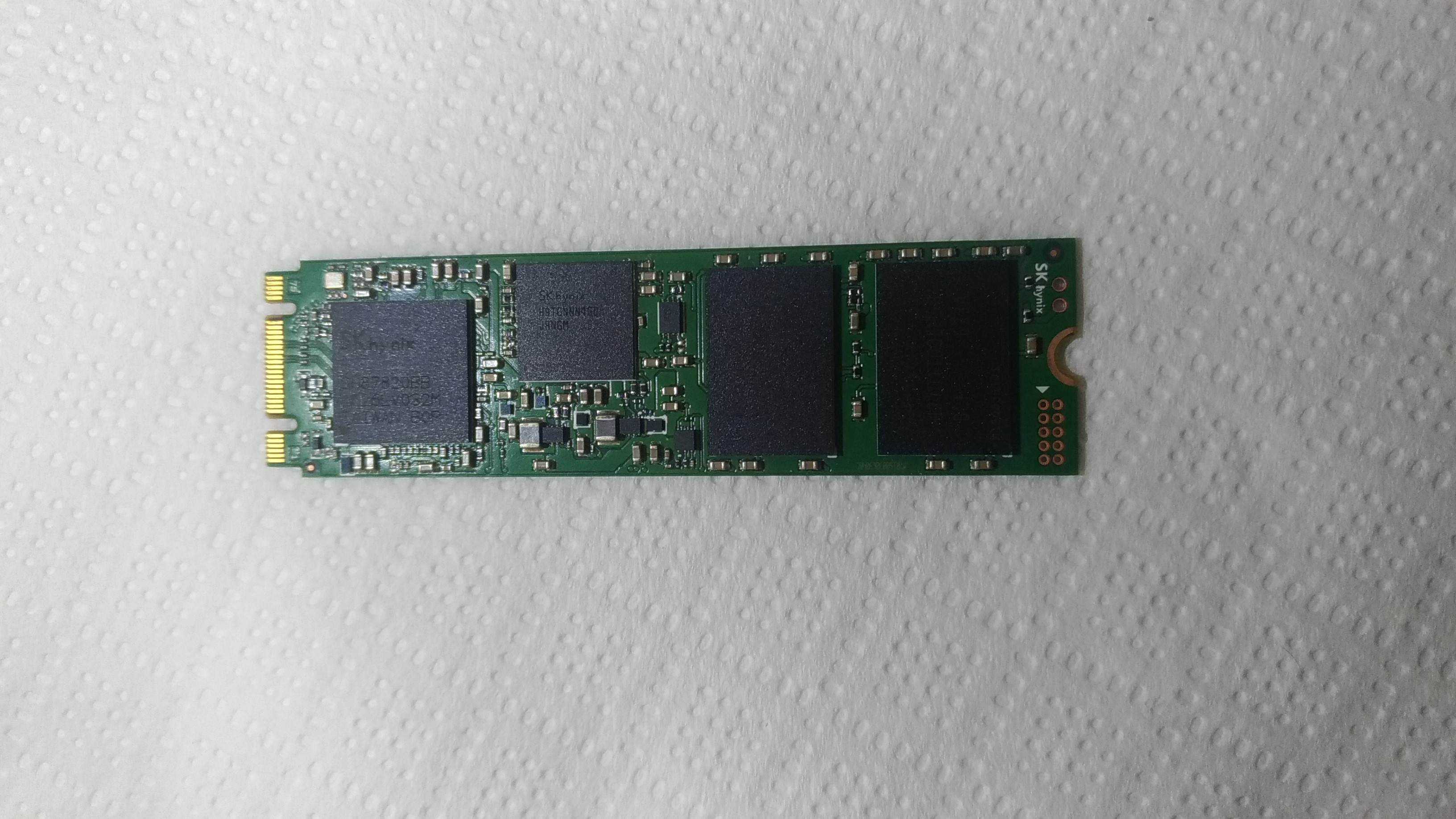

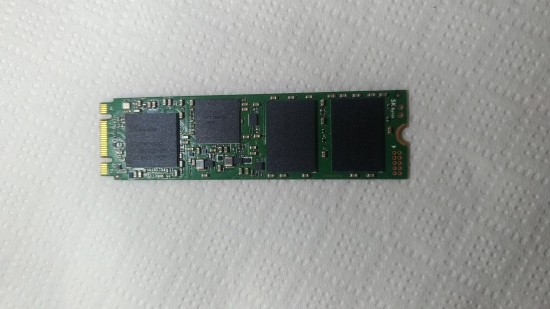

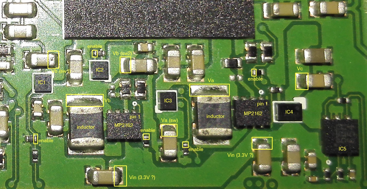

Hello.
I take advantage of the thread, because I have exactly the same unit.
I attach detailed photos.
Full Photo:
https://i.ibb.co/XxV83PD/HFS256-G39-TND-N210-A-Full.jpg
Detailed photo:
https://i.ibb.co/80s1VPz/HFS256-G39-TND-N210-A-1-2.jpg
https://i.ibb.co/mtJwhD2/HFS256-G39-TND-N210-A-2-2.jpg
Sistomas: The unit when connected does not show any signs of life. The bios does not detect it and as is logical neither windows nor linux, it has been left connected for about half an hour and no chip heats up.
I have looked at the voltage that it gives me in the same components that the creator of this thread puts and it gives me exactly the same as he did. I have checked the capacitors and the two input diodes and everything is correct.
What else can I check?
Does anyone know how to put this unit in safe mode?
Greetings and thanks for the help.
PostPosted: February 4th, 2022, 15:19
Posts: 17134

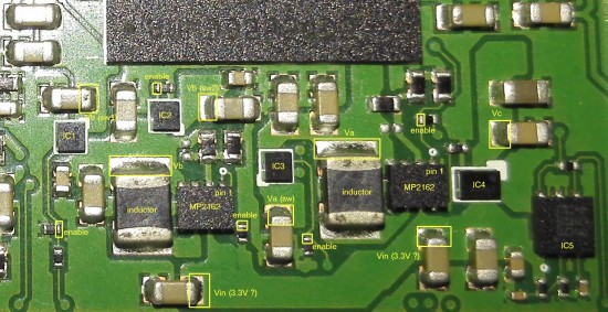

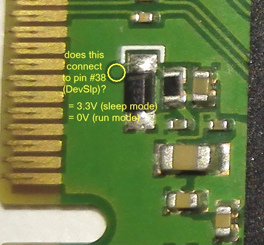

@DeVlL, what are the markings on the first IC at the bottom left ("CK PJ" in first photo)?
What are the markings on IC1 - 5? I suspect that IC1 - 3 are load switches, but I'm not sure about IC4.
Can you measure the voltages at Vin, Va, Vb, Vc, Va(sw), Vb(sw1), Vb(sw2)?
What are the voltages at the Enable pins for each IC?
Does the output of the first "CK PJ" IC connect to Vin?
Does the 3.3V input of the first "CK PJ" IC connect to Vin?

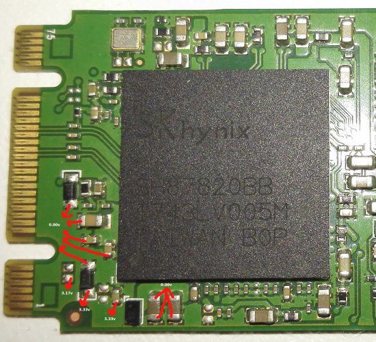

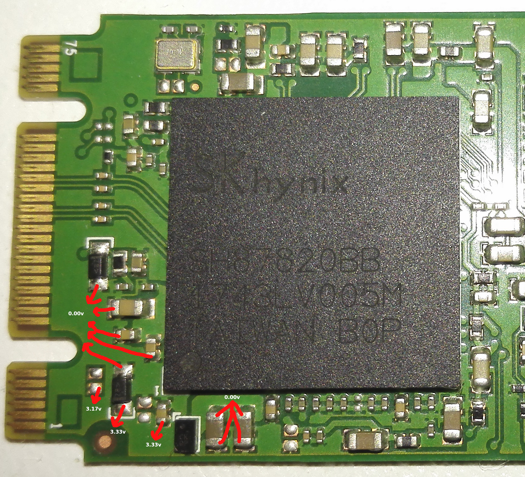

Here are your answers to your questions.
It's a CK QP
They all give me 0 voltage
They also give me 0v voltage
The CK QP is connected to VIN
Does the 3.3V input of the first "CK PJ" IC connect to Vin?[/quote]
THE CK QP gives me 0v
I think the solution is in the input.
Here I show you the measurements at the entrance.
My question is. Could it be that the Rom bios is corrupt and there is no voltage for it to start? And from there my previous question. Does anyone know how to put this unit in safe mode?

DeVlL wrote:
It's a CK QP
That means that "CK" is the part number and PJ/QP are date or batch codes.
I presume that Vin = 0V? If so, then the "CK" component must be the main switch, possibly a load switch or electronic fuse.
I presume you mean that the Vin test points are connected to the 0V output of the "CK" chip?
It does appear that "CK" is the main switch. My question is, is this switch being switched on? There should be a DevSlp pin on the m.2 interface (pin #38). Does it connect to the diode in the middle of the PCB, or does it connect to the "CK" chip?
http://www.hddoracle.com/viewtopic.php?f=106&t=2506
That doesn't make sense. The two MP2162 ICs produce the Vcore and Vio supplies for the flash controller. If there is no voltage, then what does it matter if anything is corrupt?
Why?
My approach would be to determine the pinout of "CK". If the output of this chip is not shorted to ground, and if it is indeed a switch or e-fuse, then it should be OK to jumper its input and output.
If you can tell us the markings on ICs 1 - 5, then we may be able to identify them and their manufacturer. This might make it easier to identify "CK".

Can you confirm if this is the pinout of "CK"?
+3.3V in   O  O   output
+3.3V in   O  O   output
+3.3V in   O  O   ground
Can you measure the resistance between the outputs and ground?
Can you confirm the connectivity of the m.2 DevSleep pin?

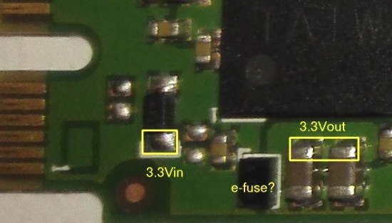

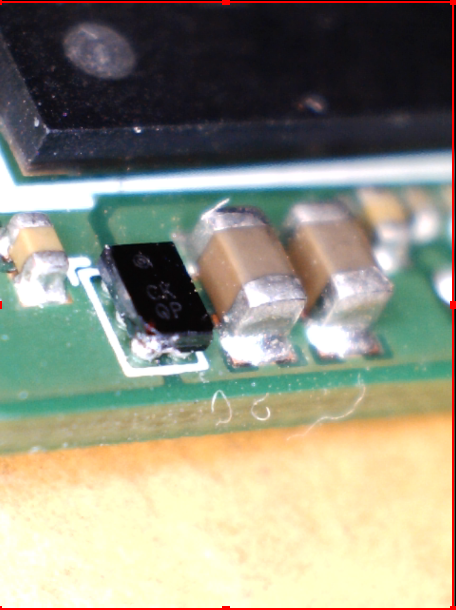

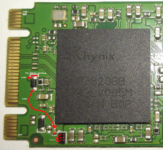

I think the culprit is definitely CK QP.
Here I detail what you ask for and the conclusions that I believe the fault is in the CK QP:
The measurements give completely crazy values, they go up and down. It is not a fixed value.
If there is connectivity to pin 38 DevSleep.
Now I attach an image of the CK QP. As you can see in the image the CK QP has a broken corner (I hadn't seen it because I don't have a microscope) I remembered that I had saved a USB microscope here and that is the image you see now.
In the second image with the measurements, it confirms that the possible failure is the CK QP. What do you think?
In a while I'll edit the message and tell you exactly the ICs from 1 to 5
PostPosted: February 9th, 2022, 15:16
Posts: 17134

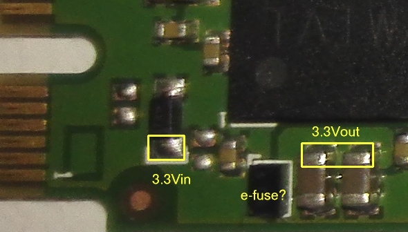

Your measurements would suggest that there is no short between 3.3Vout and Ground. Your measurements would also suggest that 3.3Vout in connected to Vin(3.3V).
If this is correct, then it should be safe to connect a jumper wire between 3.3Vout and 3.3Vin.

For the benefit of others, here are my guesses as to suitable equivalents for IC1 - 3, and IC4.
SiP32462DB-T2-GE1, Vishay Siliconix, 50 mOhm, Slew Rate Controlled Load Switch, Vin = 1.2V - 5.5V, 1.2A, marking AH, WCSP4:
https://www.vishay.com/docs/67754/sip32461.pdf
SiP32458, SiP32459, Vishay Siliconix, 20 mOhm, Slew Rate Controlled Load Switch, Vin = 1.5V - 5.5V, 3A, marking AA or AB, WCSP6:
https://www.vishay.com/docs/63999/sip32458.pdf
This appears to be IC5:
MP6400DG, Low Quiescent Current Programmable-Delay Supervisory Circuit, marking 5B, QFN6:
https://www.monolithicpower.com/pub/media/document/MP6400_r1.1.pdf
Here you have pictures of the ICs from 1 to 5
So if I put a cable between those two points, in theory the bios/windows should detect it.
So is it a fuse?
