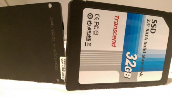

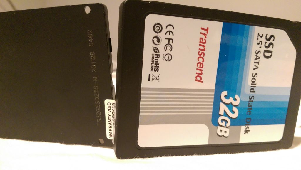

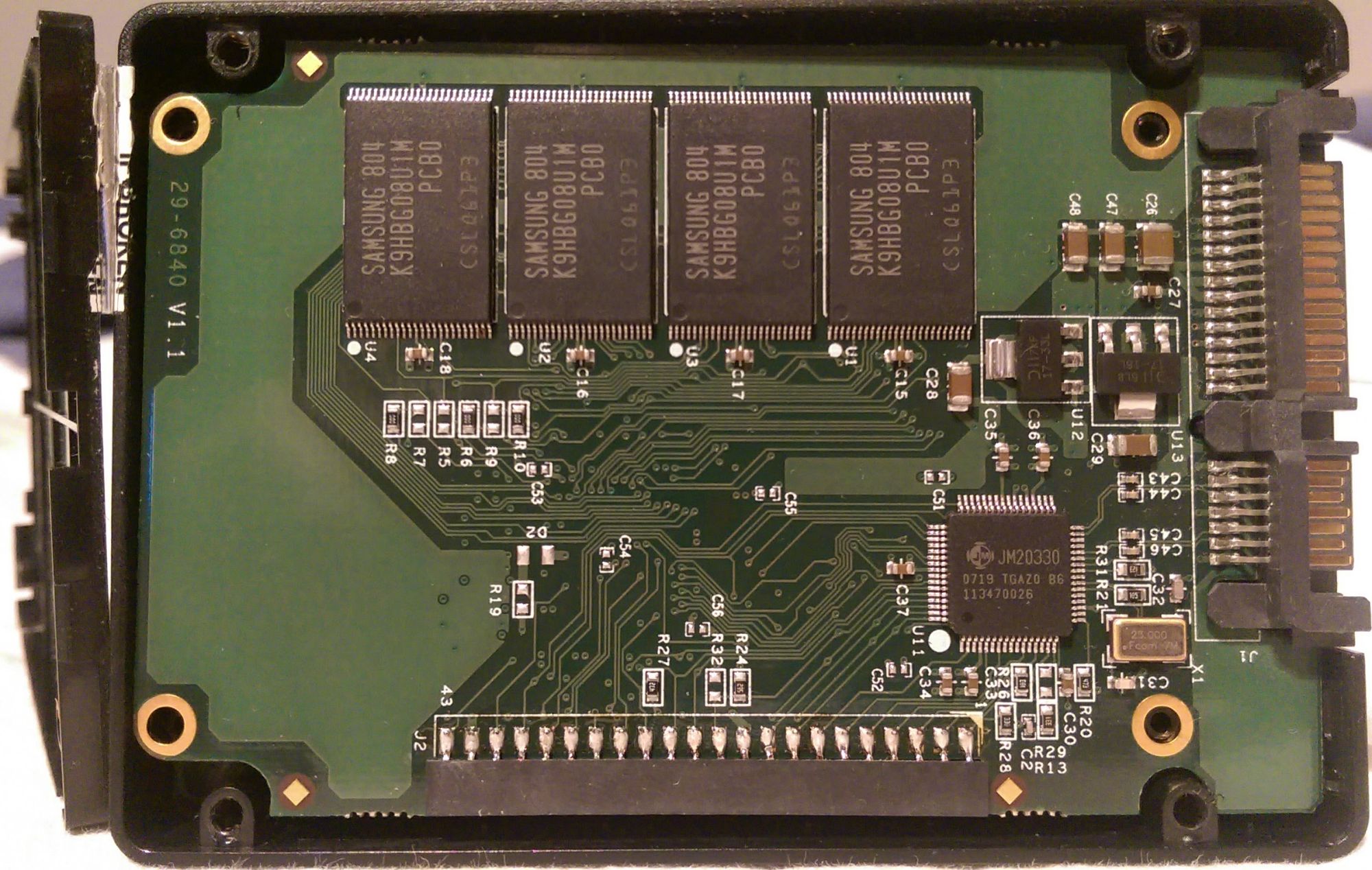

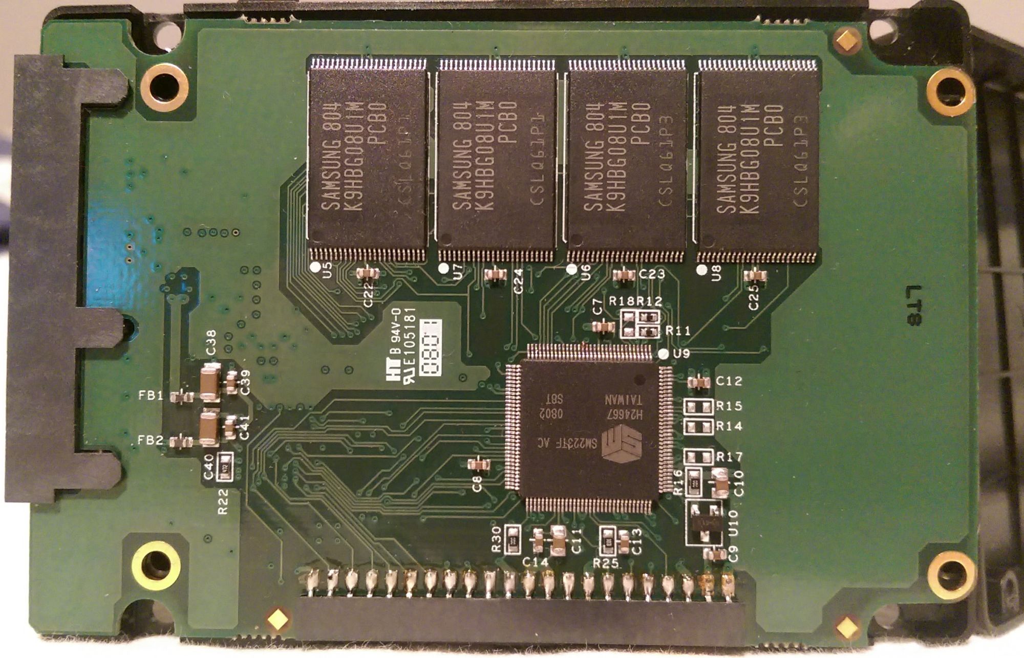

Hi, I bought this Transcend TS32GSSD25S-M SATA SSD over 8 years ago to have a silent drive in my firewall.
It's super slow and by reading reviews I got the impression that it was based on a JMicron JMF601A.

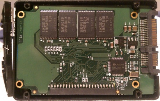

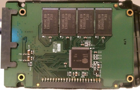

However I was curious and disassembled it a few days ago and found something very surprising inside:
The "SSD controller" is made by Silicon Motion: SM223TF AC
Why I put it within quotes is because it's actually a Compact Flash controller primarily, hence native IDE.
For this there is a bridge chip: JMicron JM20330 to convert it to SATA.
The NAND is Samsung 804 K9HBG08U1M
What surprised me was the hidden female IDE port inside!
I bought a IDE cable with one male end so I could try to hook it up to a system I have.
But it hardlocks when I try to boot that system though.
Anyone got any details on this thing?

Per Hansson wrote:
I bought a IDE cable with one male end so I could try to hook it up to a system I have. But it hardlocks when I try to boot that system though.
Maybe you need to ensure that the JM20330 remains "quiet" so that there is no contention for the IDE port. That is, try to place its IDE port in a hi-Z state.
If crystal X1 is not shared by the flash controller, then perhaps you could simply defeat (short?) the crystal.

It would appear that the SM223TF does not require an external oscillator, so it seems that X1 is associated with the JM20330.

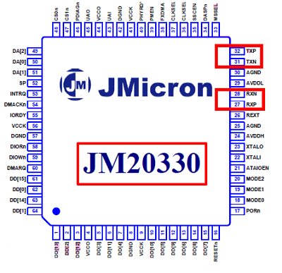

JM20330, JMicron, Serial ATA Bridge Chip, 3.3V & 1.8V, 25MHz Reference Clock, Product Brief:
http://www.go-gddq.com/downlocal/J/JM20330.pdf

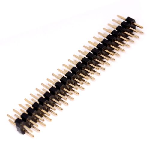

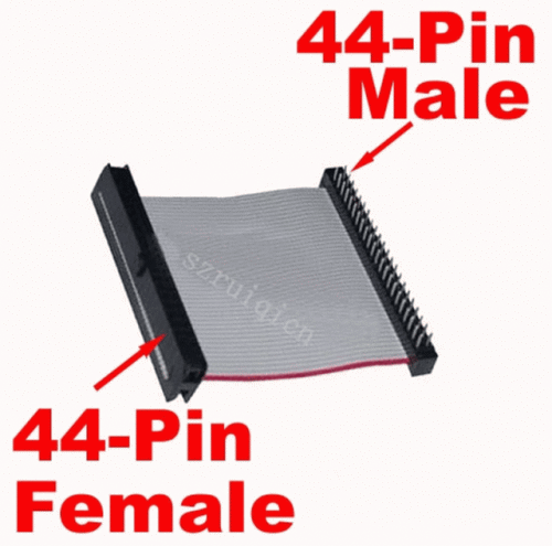

The cable I'm using now is the the male/female flat cable pictured below.
I have also ordered a 44-pin header so I will be able to hook it to some different adapters I have.
Right now I can only plug it in to my Watchguard Firebox X700 which has a 44-pin IDE interface.

On pin 16 of the JM20330 is a Reset pin.
This goes to pad R29 which is unpopulated.
It's then tied to GND (pin 1 of the IDE connector)
I tried to just bridge it but then the system does not POST at all.
Pin #1 of the IDE connector should be /RESET. This signal is driven by the host controller (or by the bridge?). Instead I would be looking at pin #17 (/POR) of the JM20330. This appears to be a Power On Reset input to the bridge.

Here is the JM20330 datasheet:
http://web.archive.org/web/20141117163146/http://beyondwind.duckdns.org/wp-uploads/2014/02/JM20330_Spec_Rev.-2.3.pdf

I got the 44-pin header today so I could test the SSD on some more mainboards with 3.5" IDE headers using a 2.5" > 3.5" adapter.
It's the same thing though, using a FIC FA15T it hung for a long time then continued without recognizing the SSD.
And with a K8N Neo4-F it hung forever like with the Watchguard Firebox.
I then decided to desolder resistor R20 which is for pin 17 #POR which fzabkar mentioned above.
Strangely there was no change in behavior, the drive also still works with SATA so not sure what's up with that...
I could measure 3.3v on both pads to ground after removing the resistor. (And before as well for that matter).
