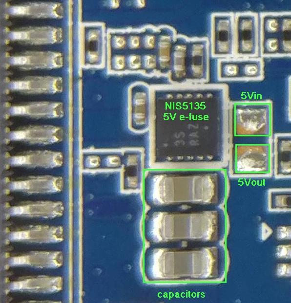

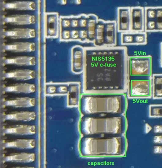

In practice, it would make more sense to invest in a US$5 multimeter and locate the cause of the short.
If this is your board ...
https://www.insidegadgets.com/wp-content/uploads/2013/07/IMG_3020.jpg
https://www.insidegadgets.com/wp-content/uploads/2013/07/IMG_3022.jpg
... then check the e-fuse ("35" marking) near the SATA power connector. This part can be removed and bridged with a wire or a picofuse. If the PCB has additional problems, then your PC3K board should provide the current limiting.

You have not addressed the cause of the short.
When you check the e-fuse, measure the resistances between 5Vin & Ground, 5Vin & 5Vout, and 5Vout & Ground. If the e-fuse is responsible for the short, then remove it. Otherwise, if the short is between 5Vout and Ground, and if the e-fuse is OK, then we need to do more investigating. Specifically, I would measure the resistance between ground and each of the coils.
                       bridge
                .----o       o---.
     SATA +5V   |  .-----------. |
        5Vin o--+--|           --+--o 5Vout
                   | 5V e-fuse |
                        GND
                    SATA Ground

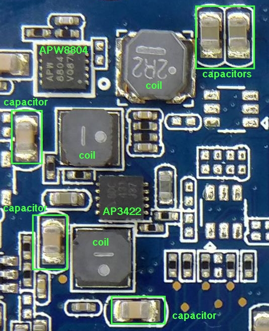

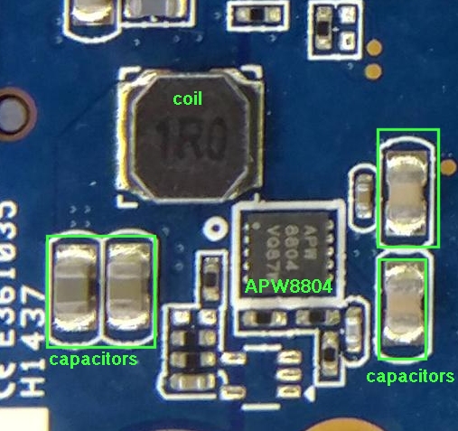

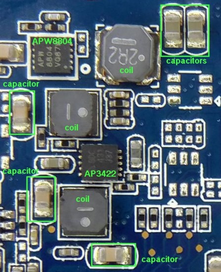

I would measure the resistance of each capacitor. Also measure the resistance from each coil to ground, and measure the resistance between ground and each of 5Vin and 5Vout. Use the 200 ohms range of your meter.
APW8804, Anpec, 3A, 1MHz. 2.6V - 6V input, 0.6V - 6V out, Synchronous Buck Converter, SOP-8P:
http://www.anpec.com.tw/ashx_prod_file.ashx?prod_id=687&file_path=20131024191901739.pdf&original_name=APW8804.pdf
http://fa.itservice-bg.net/baza/dc_dc/data/APW8804.pdf
AP3422, BCD Semiconductor, Dual 1.1MHz, 800mA Synchronous DC-DC Buck Converter, 2.5V - 5.5V in, marking BDC, DFN-3×3-10:
http://www.bdtic.com/datasheet/diodes/AP3422.pdf
MP6400DJ-01, adjustable Programmable-Delay Supervisory Circuit, marking 4Bxx, TSOT23-6:
http://www.monolithicpower.com/desktopm ... nt?id=1003
LM73, Texas Instruments, 2.7V, SOT-23, 11-14Bit Dig Temp Sensor w/ 2-Wire Interface, marking T730:
http://www.ti.com/lit/gpn/lm73
NIS5135, ON Semiconductor, 5V Electronic Fuse, marking 35:
https://www.onsemi.com/pub/Collateral/NIS5135-D.PDF

This is essentially the power supply layout of your PCB:
                        bridge
                 .----o       o---.
      SATA +5V   |  .-----------. |  5Vout               coil    Vout1
                 |  |           | |         .-------.    ___
         5Vin o--+--|           --+--oo--+--| Reg1  |----UUU---+--oo---.
                    | 5V e-fuse |        |  '-------'          |       |
                    '-----|-----'        |  .-------.         ---     | |  load
                          |              +--| Reg2  |- Vout2   |cap   | |  (MCU
                          |              |  '-------'          |      '-'  SDRAM
                          |              |                     |       |   NAND)
                         ===             +--| Reg3  |- Vout3       |
                         GND             |  '-------'             ===
                                         |                        GND
                     SATA Ground         |  .-------.
                                         '--| Reg4  |- Vout4
