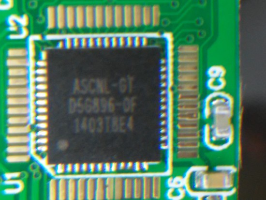

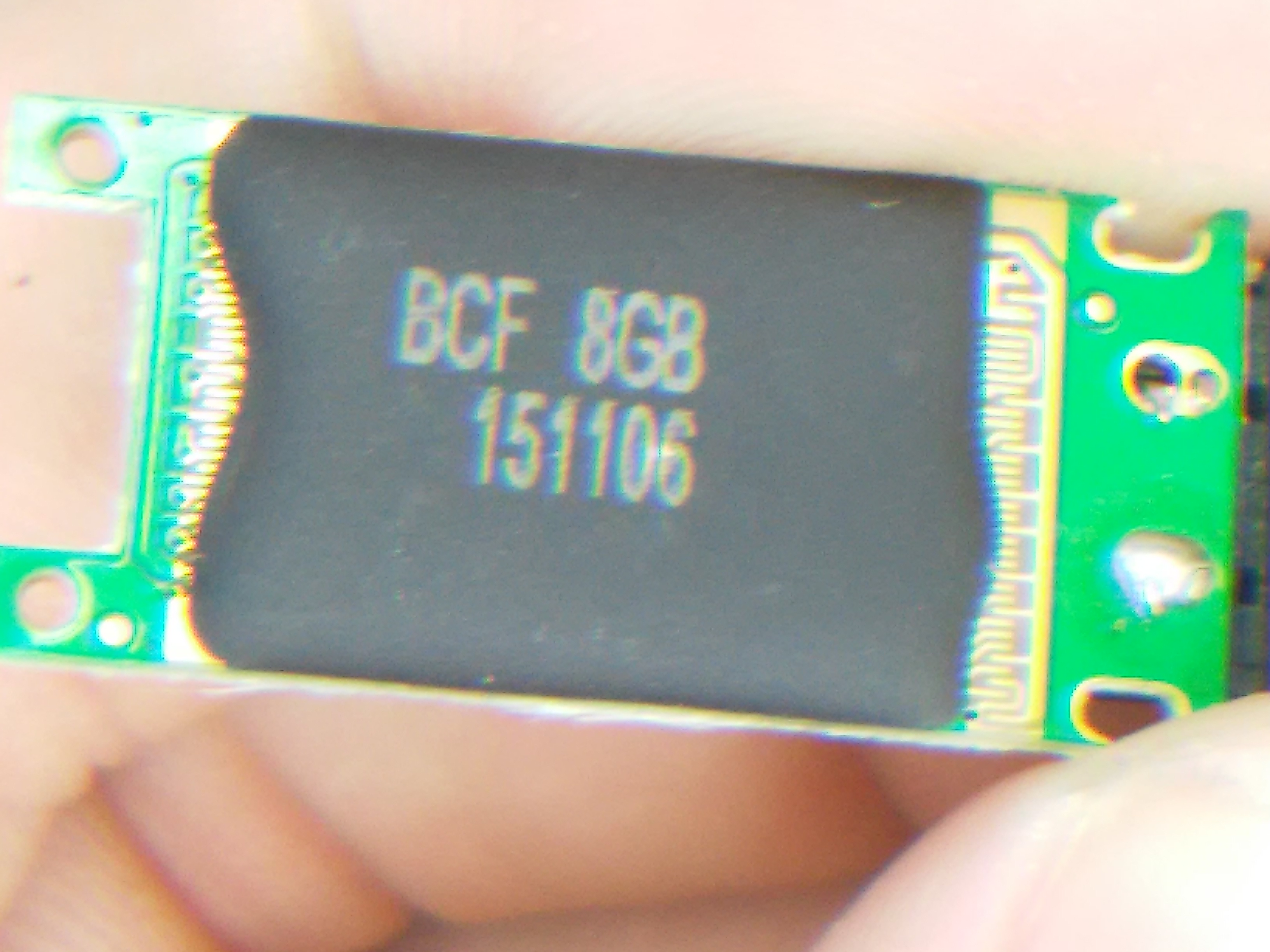

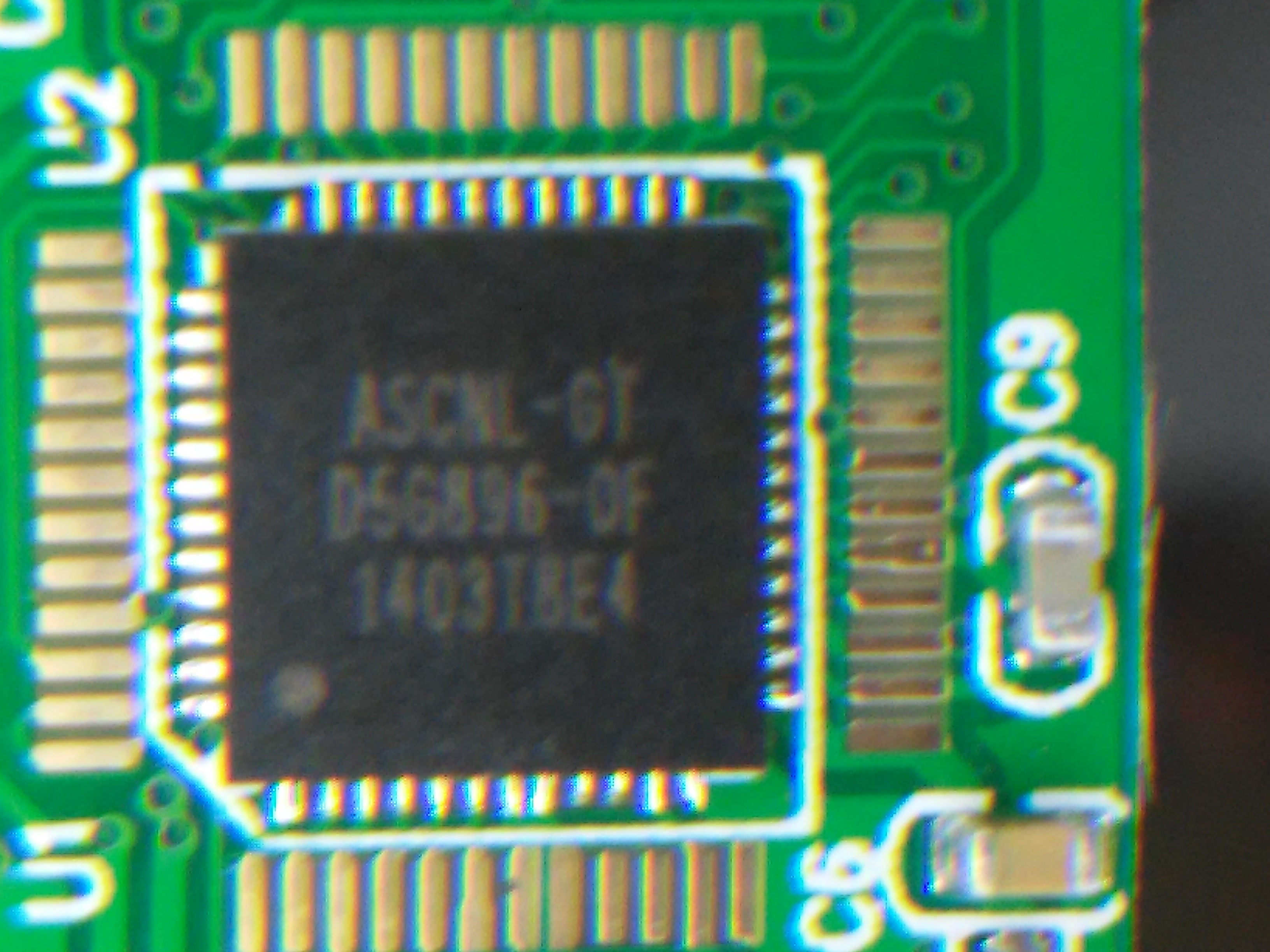

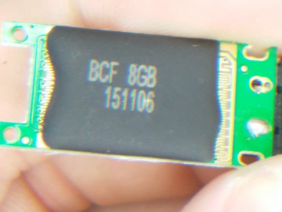

I got an 8 GB pen with a stange memoy chip as picture attached.
Any idea how can I extract the memory chip to recover data using PC3000?
Thanks,
^BCBB366AB6E5FD3F651A974E9D4E0E6DCC425AFA330E2DCAC3^pimgpsh_fullsize_distr.jpg [ 1.36 MiB | Viewed 7472 times ]
^3CF2DE61E5E709B1818635C70EA05B28A17EAE028794155B31^pimgpsh_fullsize_distr.jpg [ 1.05 MiB | Viewed 7472 times ]

Find datasheet for controller. Connect to memory chip from controller side.
 Post subject: Re: Strange memory chip
PostPosted: November 2nd, 2016, 11:55
I'd bet there's a NAND of some sort buried under that blob of tar. Getting it out in one piece might not work so well. Probably best to do what Arvika says.

Thanks for the suggestions but what do you mean by "Connect to memory chip from controller side"?
PostPosted: November 2nd, 2016, 12:21
Posts: 922
Remove controller and connect reader to memory chip by wire.
