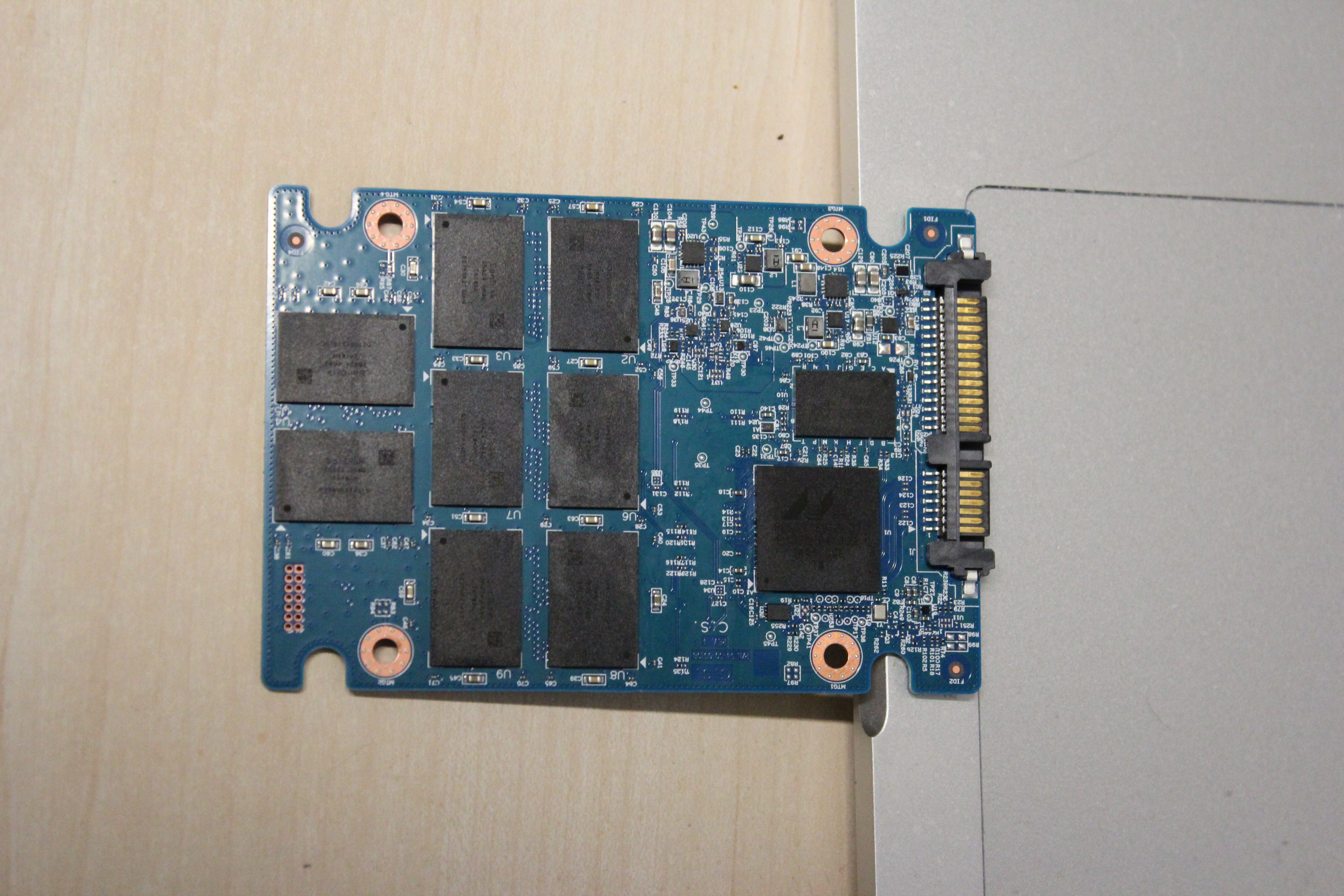

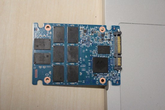

Ok, I bought the PC3k SSD, but it seems, it can't handle the problem. But now the SSD does not show the ERR flag, but all SATA registers light up, like no S-ATA cable is attached. So I think there is an electronic problem with the PCB.
But where should I start digging around? I checked the SATA and Data Ports, they are OK. The other Problem with this PCB is, that Sandisk used fuck'n 0201 parts on the PCB. I inspected the board with my microscope, but I couldn't find anything wrong. The RV1 Diode is also ok. And I have 5V on the big caps.
I also tried to reflow the controller IC, but it didn't work for me without a preheater from the bottom. That's what I'm going to try next.
Or does some one have another idea?
File comment: Front Side

arvika wrote:
It is Sandisk, not Samsung.
First check PCB for electronic problem. If only ERR status light probably PC3K not solve your problem.
Sorry ,
The Link i gave is wrong ,But its a marvell CPU and more and more marvell cpu's are getting supported by pc3K .
 Post subject: Re: Sandisk Ultra II - 88SS9189 Controller - ERR Flag
PostPosted: January 6th, 2017, 12:41
Might Be Chipoff Is a solution if nand is ok
PostPosted: January 6th, 2017, 12:50
Posts: 922
There is no solution so far for chip-off for controller Marvell 88SS9189.
