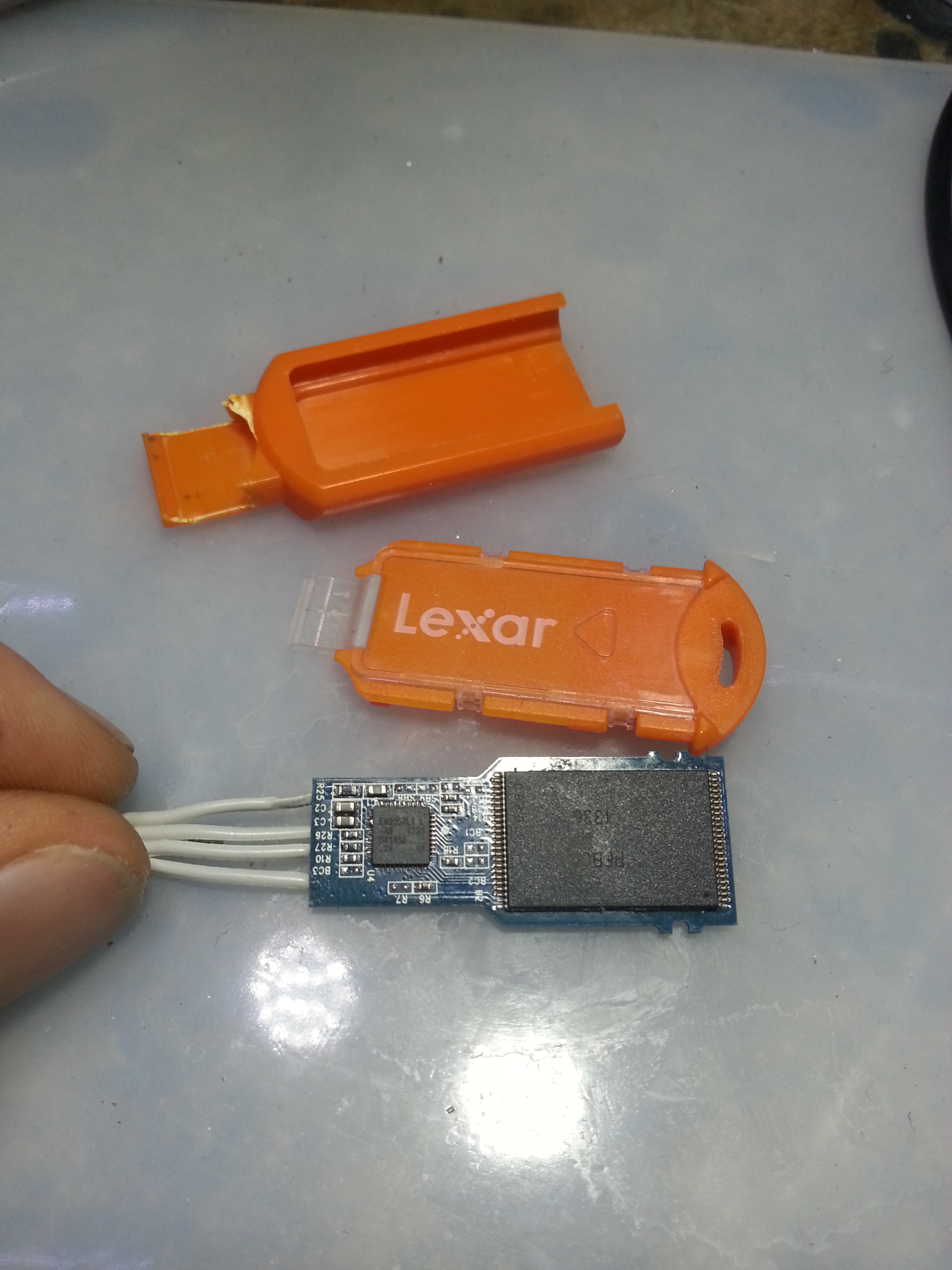

I've been passed an 8GB Lexar drive that had sustained damage to the plastic casing. It has subsequently been wiggled about in a USB slot to try and get it to work.
The controller was only partly soldered to the PCB, so I reflowed it with hot air, checked the few SMD components, soldered on a USB socket and plugged it in.
The drive is recognised and installed and given a drive letter but shows No Media under device manager.
After doing some searching online, I get the impression it's possibly something to do with the controller and have run ChipGenius and get the following output.

USB Device ID: VID = 090C PID = 3000
Device Vendor: Silicon Motion,Inc.
Device Name: SM3255AA MEMORY BAR
Device Revision: 0100
Product Model: USB MEMORY BAR
Product Revision: 1000
Controller Vendor: SMI
Controller Part-Number: SM3257ENLT - ISP NONE
Flash ID code: 44444444 - 2CE/Single Channel [MLC] -> Total Capacity = 8GB

I have followed the link at the bottom to some tools that suggest they reprogram the controller. I have downloaded a couple, and whilst i've tried to understand via Google translate how they work, they don't seem to detect this drive.
Am I going in the right direction with this software ? should I be doing something else ? or shall I go to my plan B, which was buy an identical drive and swap the flash chips over ?

1. If you reprogram controller your data will be lost or sure.
2. Controller do not see the memory chip.
3. Chip-off method will be best for this case
4. If you don't know what you doing better outsource the case. In UK there is pcimage and few other skilled guys.
 Post subject: Re: Lexar 8GB
PostPosted: January 17th, 2017, 4:06
Agree.
The controller is unable to access the memory, either due to bad connection or memory degradation.
Chip off is the way forward as Arvika says.
Bad PCB, bad solder joint on the controller or NAND..
It's reading the ID wrong
If he legitimately says that he will quickly go insane off chipping so many broken connector jobs
