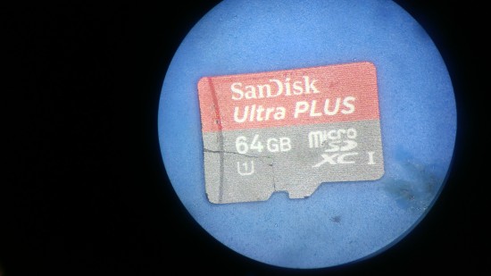

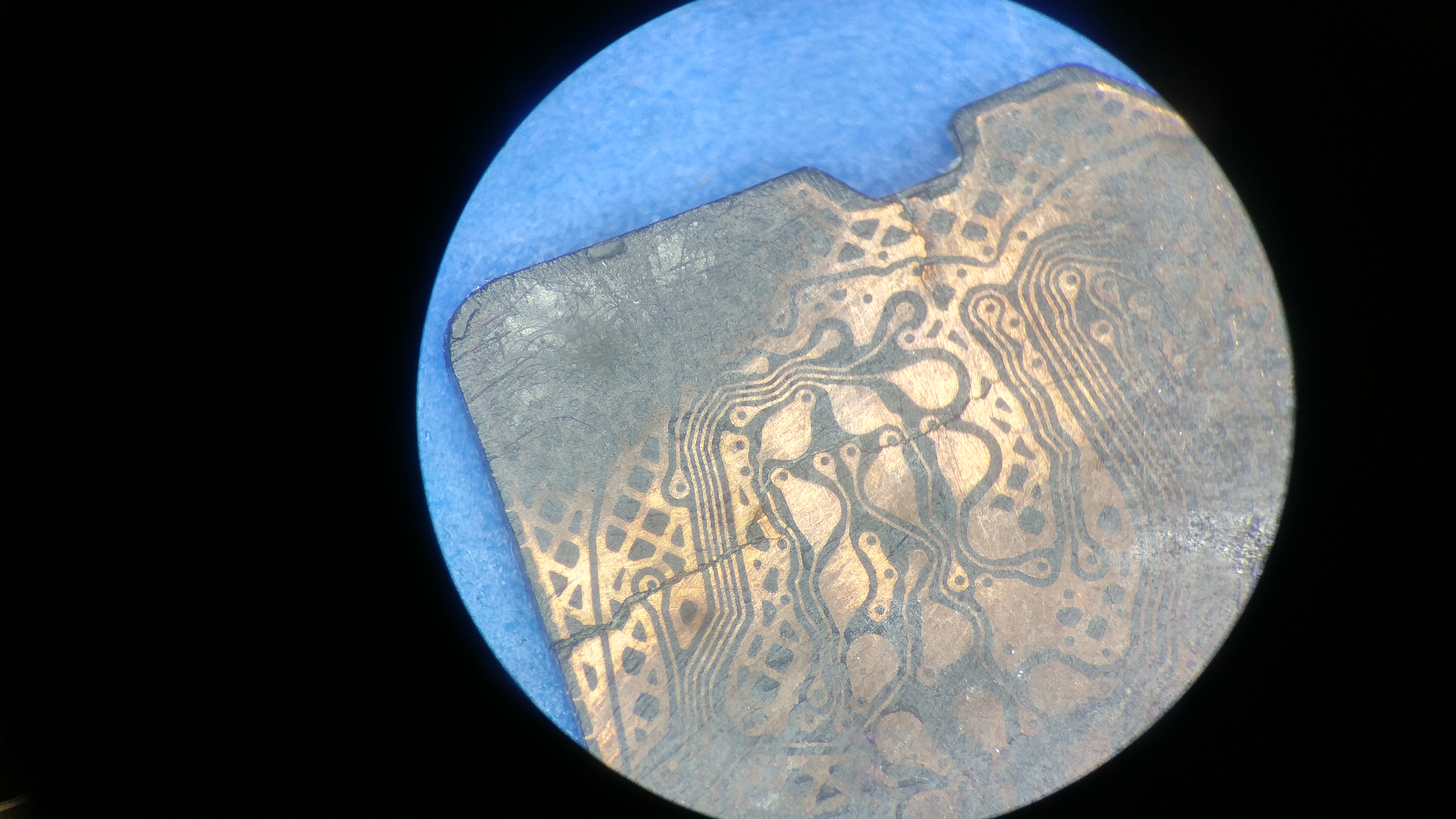

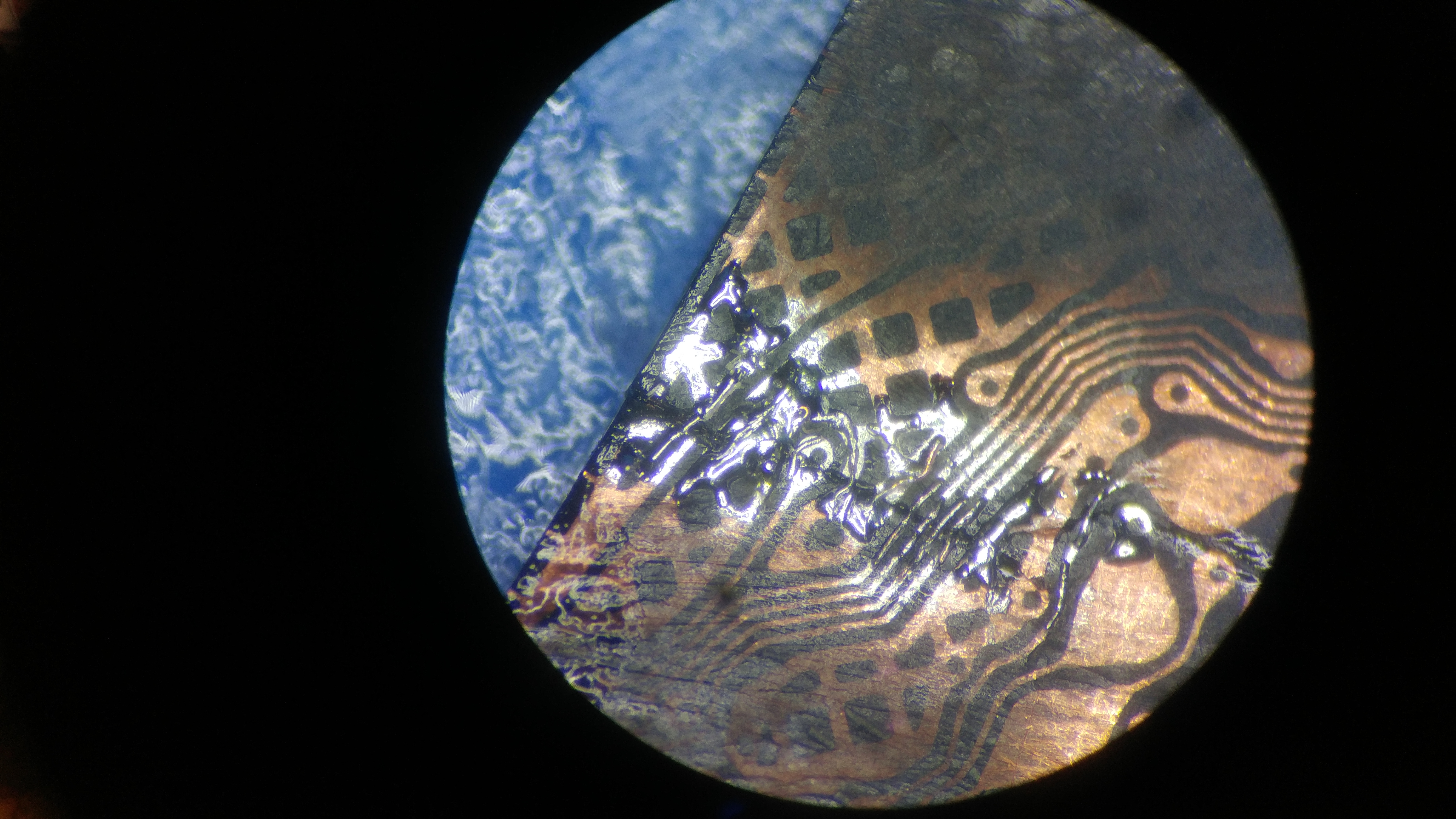

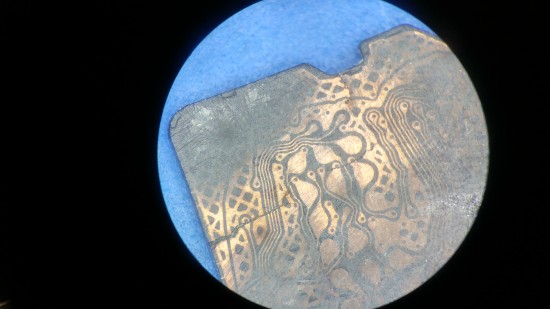

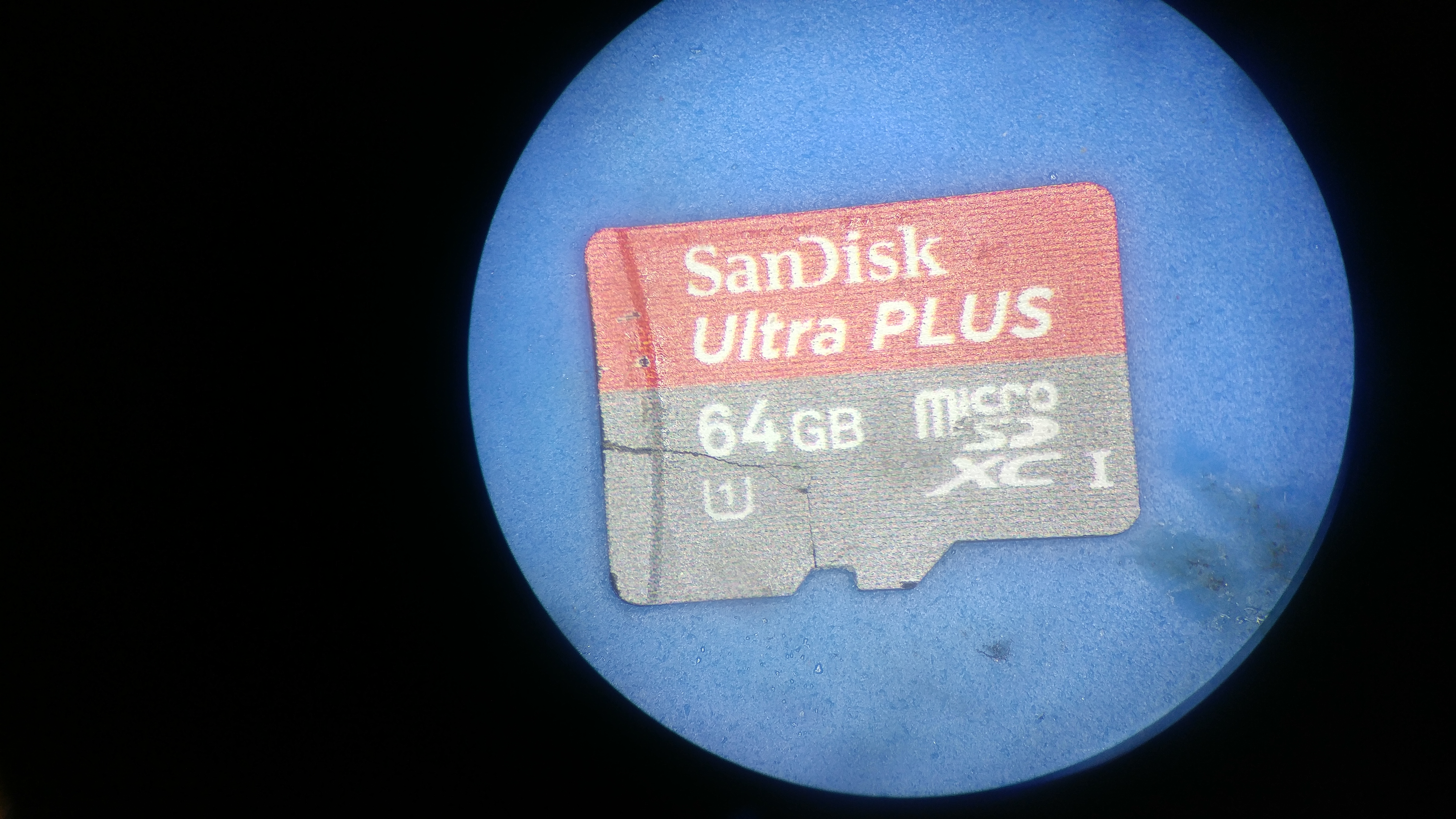

Got a cracked Sandisk Ultra PLUS 64gb micro SD with a fracture running through it. See attached photos.
Would it be possible to recover this using monolith tools?

Of course, some traces would have to be repaired on the surface, but is there any way to tell if it's damaged even more internally?
 Post subject: Re: Cracked Micro SD, possible to recover?
PostPosted: January 9th, 2017, 17:44
Posts: 923
IMHO no.

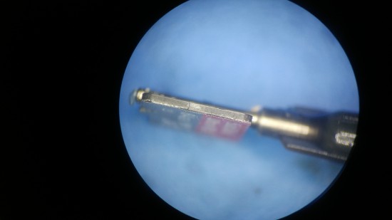

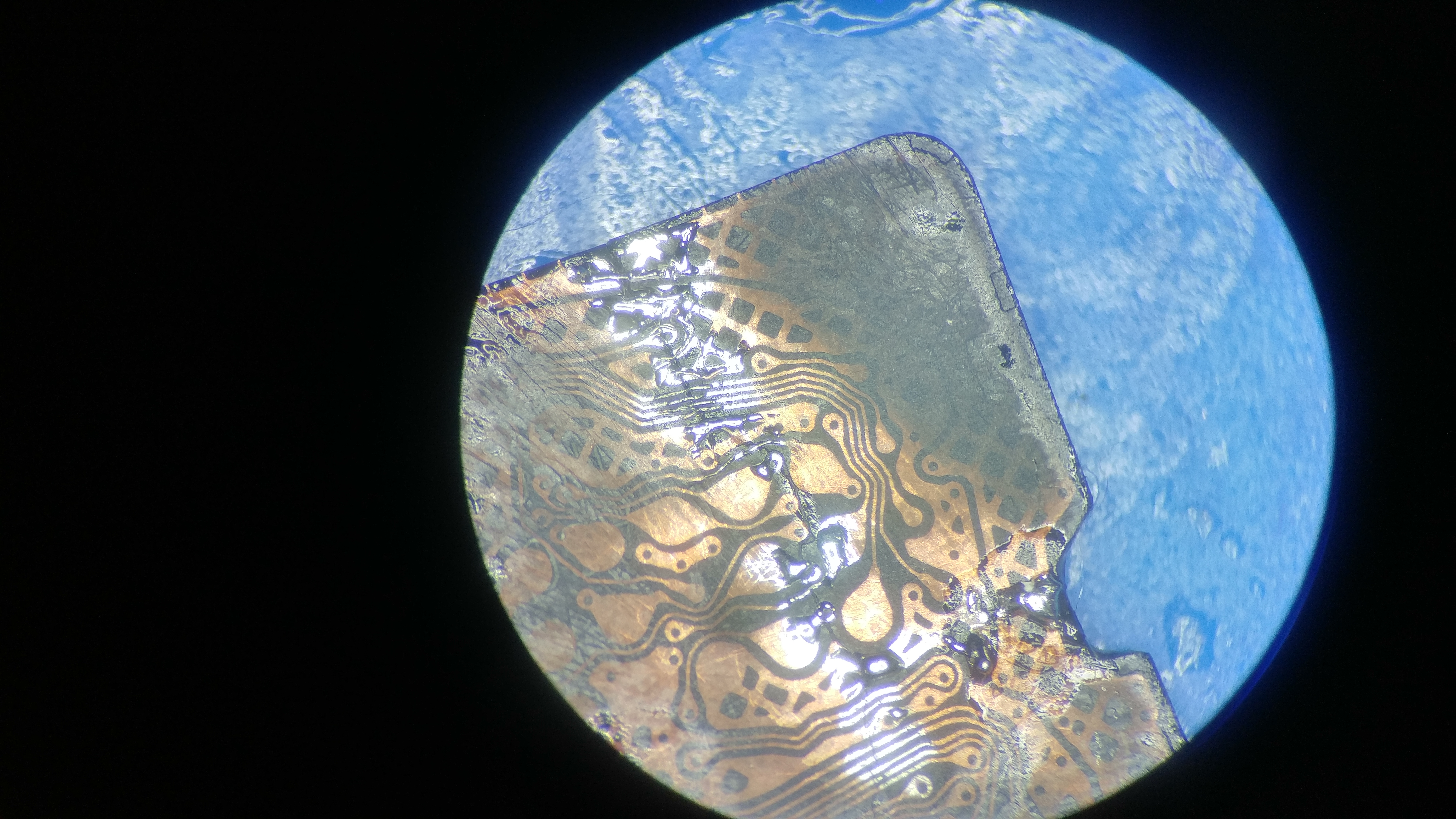

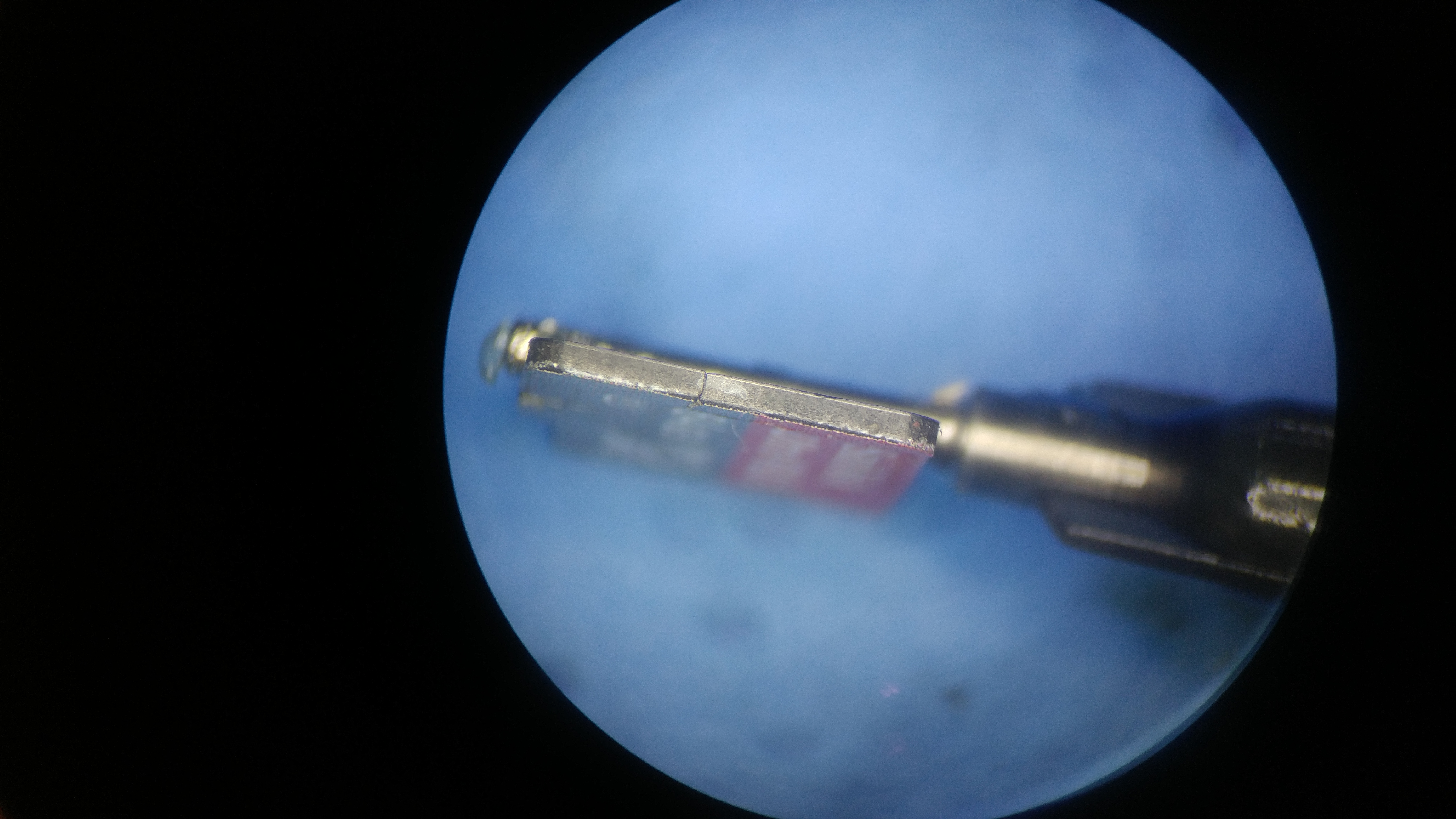

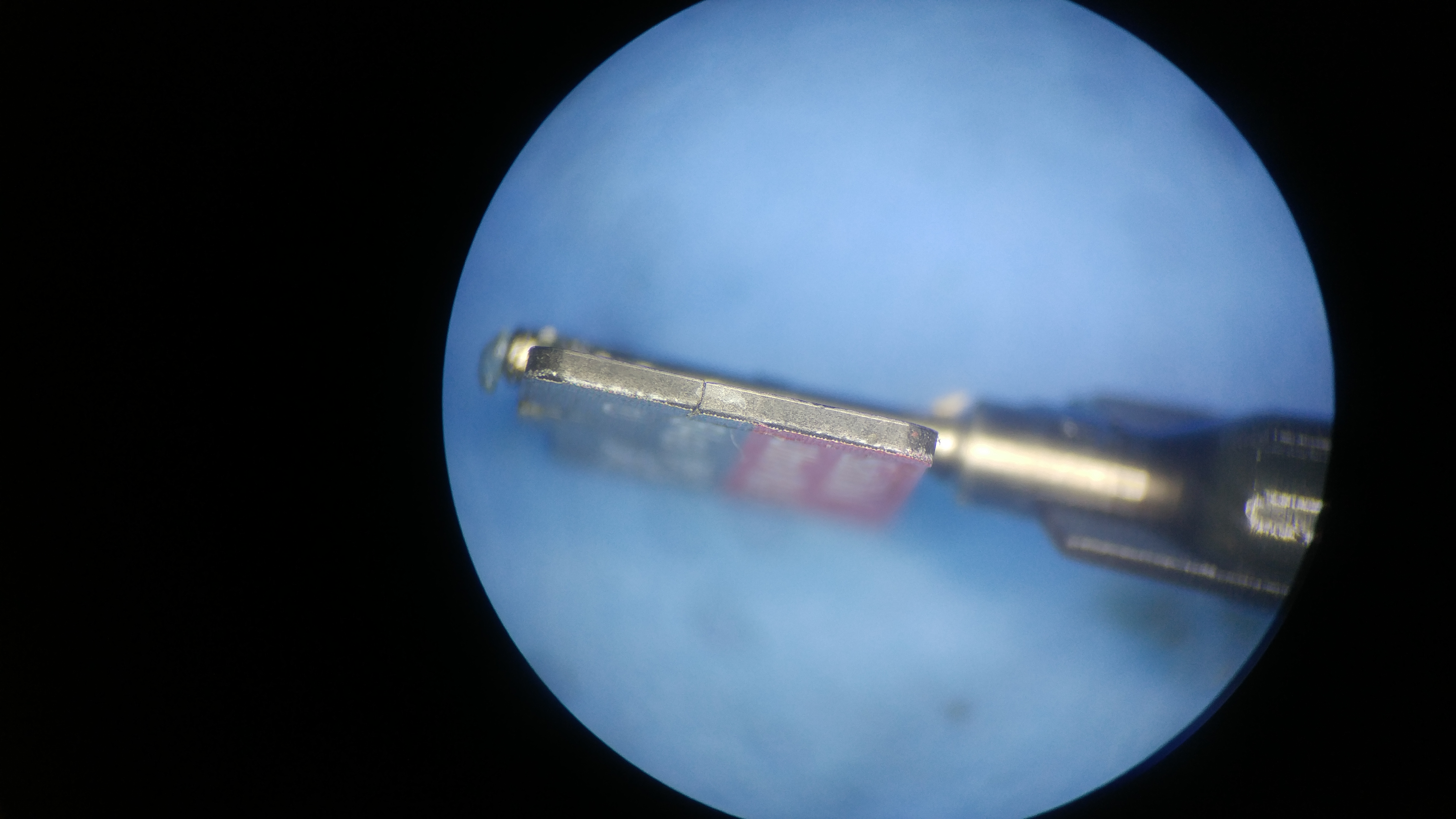

Well I completely believe you but I figure it can't hurt to try. Just gotta get a micro SD reader now.
PostPosted: January 10th, 2017, 4:39
Posts: 923
Yes, worth to try, but memory module in MicroSD cards usually cover all surface of card (inside). So any crack usually destroy the memory module.

Not Possible,Just Under 10% Chance It Can Work .If You See a Good Xrayed Image Of a Micro SD You Will Understand It Has a Lot Of Tracks Inside It .In You Case You Repaired Just The Top Once ,But Worth a Try

Same card as yours, most likely dead.

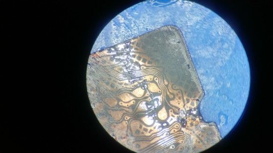

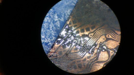

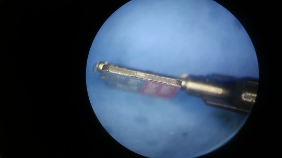

Holy crap. Touched it up a bit and guess what??
Didn't work. Thanks for the input though :roll:

Impressive soldering. What gear do you use?
PostPosted: January 11th, 2017, 15:20
Joined: November 27th, 2012, 21:59
Posts: 94
Location: Upstate NY, USA
Hakko T9-I but it's still too big for this.
