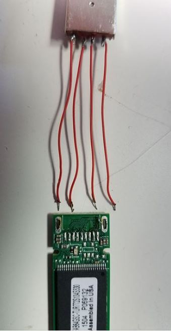

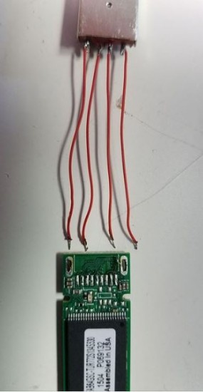

I have a flash drive with broken socket I have a usb2 socket but I dont know the pin out, could some one please point

If you didn't take a high-res picture of the assembled parts you may need an identical unit to determine what goes where. Usually it's straightforward, as one outside pin is ground, the opposite is 5v and the data lines are in the middle. Here are the pinouts for the connector.

Thank you, I think I didn't explain correct :oops: is a USB3 but I have a USB2 socket, USB3 has eight pads, my socket has only 4 cables, where do I need to solder the 4 cables

http://pinoutguide.com/PortableDevices/ ... nout.shtml

LOL, that's why there are so many pads! I have a cold and am a little slower than usual today. That and I'm just stupid.

http://pinoutguide.com/Slots/usb_3_0_co ... nout.shtml (9-pin)

Thank you Mr LarrySabo and Fzabkar I was able to recover my flash with the info you posted - Cheers!! :beer:
