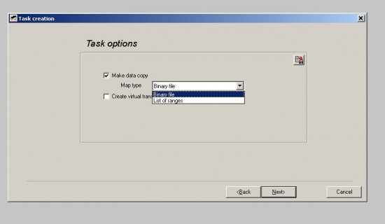

As far as I know, you can also save the image as a binary file in PC-3000 Flash. It's basically a modified version of Data Extractor. See the screenshot?
