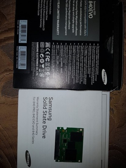

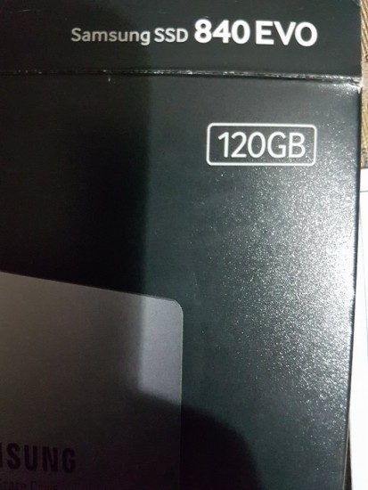

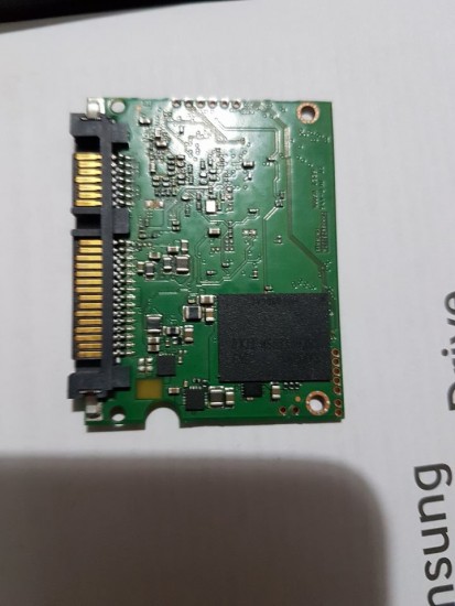

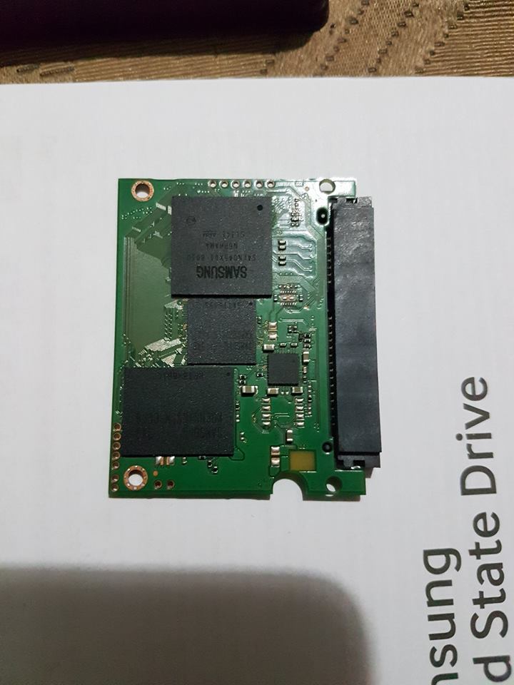

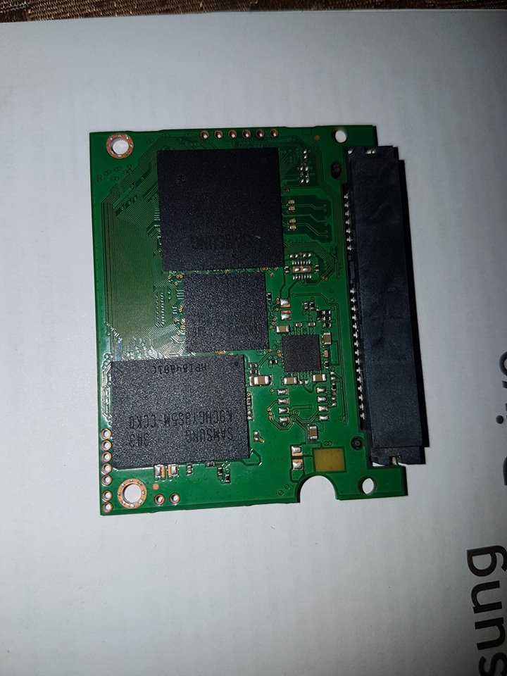

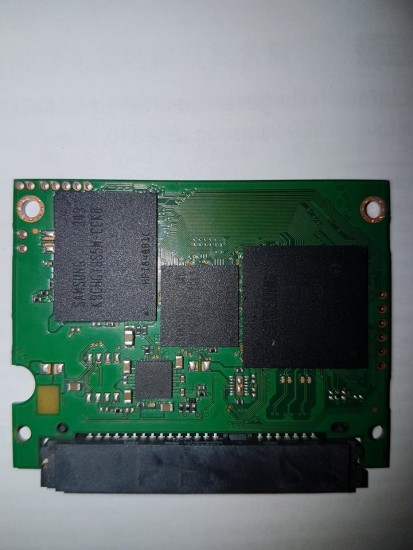

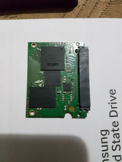

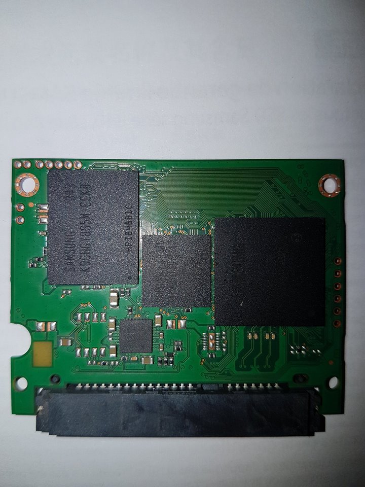

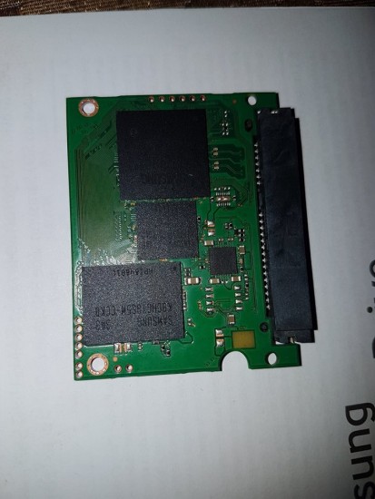

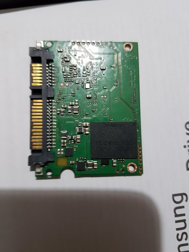

Hello
one of my friends has Samsung EVO 850 SSD 120GB SSD and its dead somehow when its connected to the pc via sata port its not even detected :/
what can we do to diagnose this ssd to find which chip needs replacement in order to fix it?
Whats the common issues with this model?
What software and or hardware needed to diagnose and fix this?
PICS below:
File comment: PICS
File comment: PICS
File comment: PICS
File comment: PICS
File comment: PICS
File comment: PICS

You need proper tools to recover this SSD, like pc3k ssd. you need to lead a fw loader and clone with DE

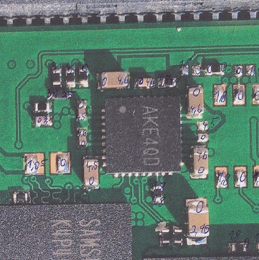

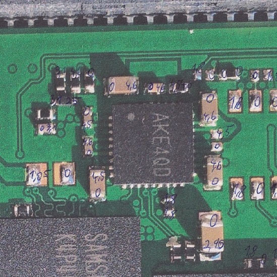

@HDDGEEK11, start by testing the e-fuse. Then check the onboard power supplies. You can do this with a $5 multimeter. I would mark the test points for you, but your photos are too poor. However, there are several threads in this forum that have photos and test points for similar PCBs.

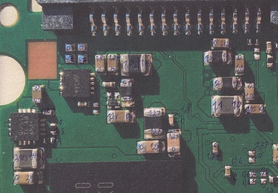

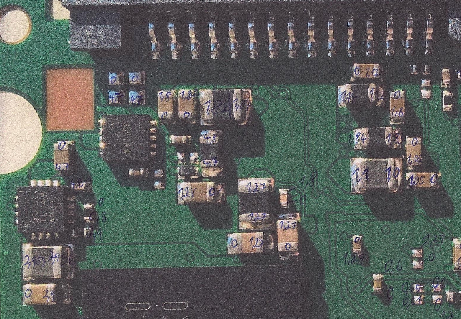

Here are voltages from "sourcerer's" manual:

This MCU supported with proper tools. Just need download proper loader via terminal and read data in techno mode.
We are noticing FW corruption due of "bad blocks" unrecoverable errors in memory chips. Chances to fix based on fzabkar's instructions are very low.

The title of this post is wrong, I think, on your photos it looks like a EVO 840, not like a EVO 850 to me.
If you want to diagnose it, you can try to get a good JTAG adapter, and run my analysi software:
https://github.com/thesourcerer8/SSDdiag
If your friend wants his valuable data back from the SSD, I would suggest that you ask a professional data recovery company to fix it. If you do that, please ask them to make and give you a backup of the corrupted data structures.

And answering your question: I guess that replacing any chips on the SSD will not help you.
(But feel free to measure the voltages with a multimeter and verify them against the ones I made and fzabkar posted. If you find any big differences, let us know)
Such measurements could indirectly provide some insight into the condition of the controller.

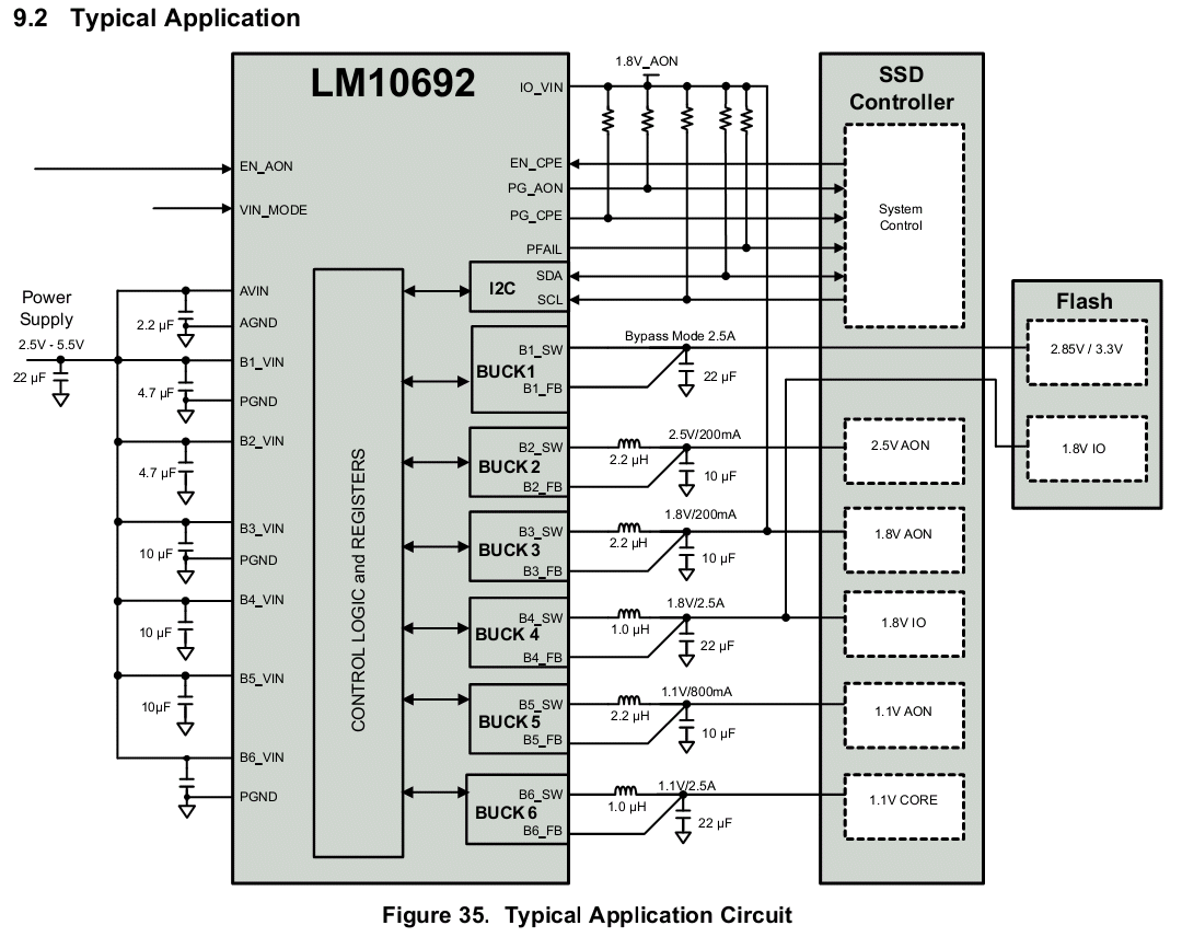

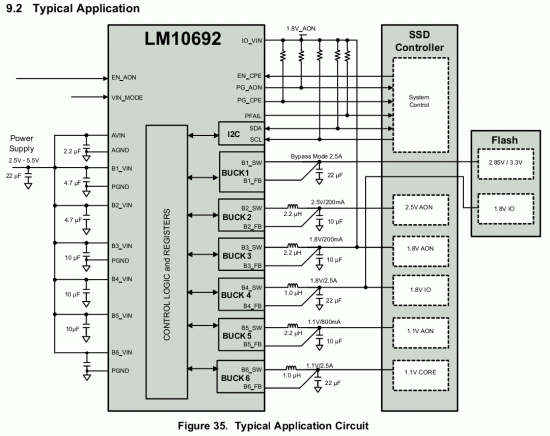

The "AKE" chip appears to consist of 5 switchmode step-down regulators plus 1 boost regulator. I couldn't find an off-the-shelf part that matches its function or pinout, but, FWIW, the following Power Management IC (PMIC) might help to understand how these chips work.
LM10692/LM10692B, Texas Instruments, Power Management Unit for SandForce SF3700 SSD Controllers, 6 buck regulators, I2C:
http://www.ti.com/lit/ds/symlink/lm10692.pdf
9.2.1 Design Requirements
The application needs to be able to operate with the default output voltages. Output voltages can be changed through I2C after start-up but the power-up levels will always be the default values.
ISTM that any significant difference between the OP's and sourcerer's voltage measurements might suggest that the controller and "AKE" chip were not communicating. Assuming any voltage difference was still within the operating range of the SSD, then the controller would be suspect.
