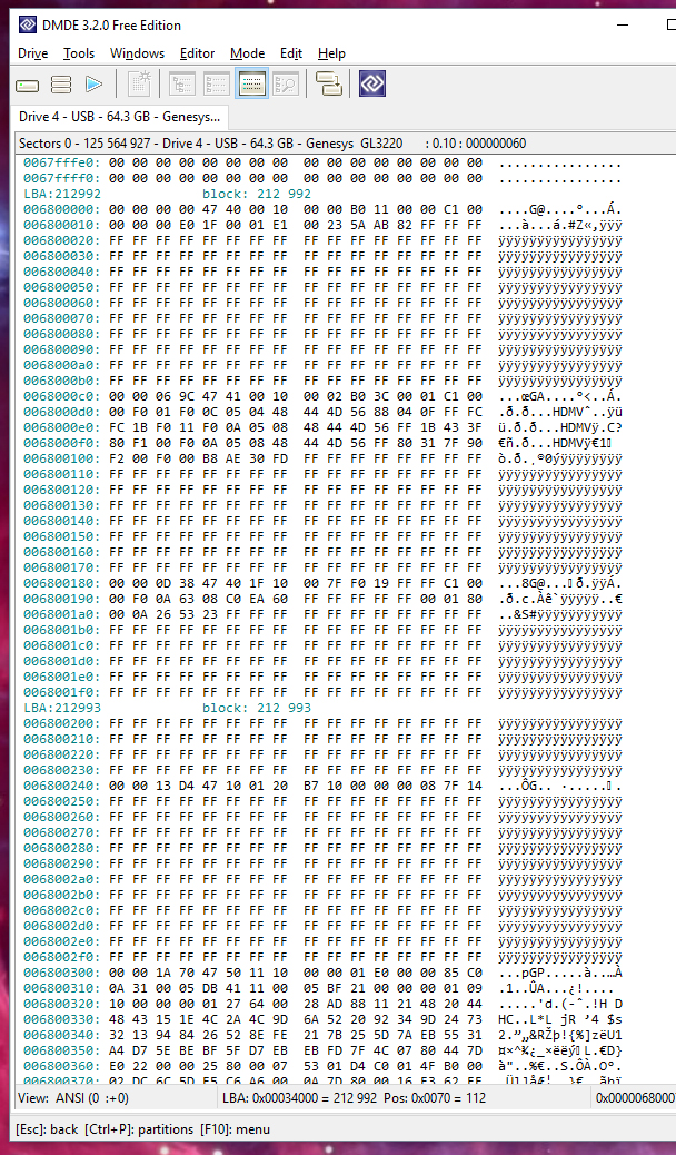

Can you show us a hex dump of the first non-zero sector?
Is that the right picture? https://drive.google.com/open?id=0B34Te ... TktZV9JRm8

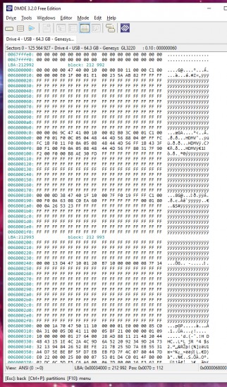

Is this the right picture?

This post shows the structure of the FAT32 file system on my 16GB Toshiba flash drive:
viewtopic.php?f=10&p=244411
This is my 64GB Lexar drive:
From the boot sector ...
Reserved Sectors        32
Bytes per Sector        512
Sectors per Cluster     64
Big Sectors per FAT     15260
These are the locations and sizes of the various components of the FAT32 file system:
    boot sector at LBA:2120
    32 reserved sectors
    FAT#1 at LBA:2152 (= 2120 + 32)
    FAT#2 at LBA:17412 (= 2152 + 15260)
    root dir at LBA:32672 (= 17412 + 15260)
Your first non-empty sector is at LBA 212992 whereas my root directory begins at LBA 32672. The hex dump looks like data, so this would confirm that all the important file system components have been destroyed. AFAICS, all that remains is a raw recovery.
