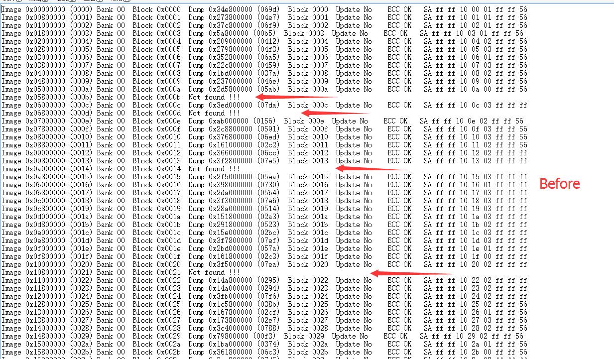

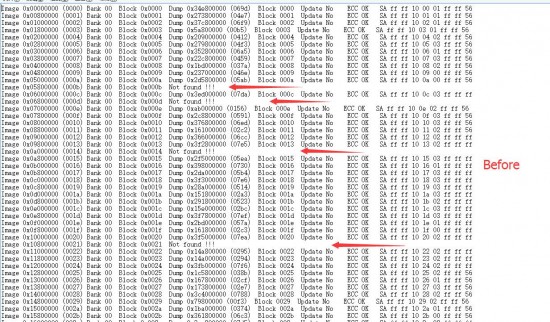

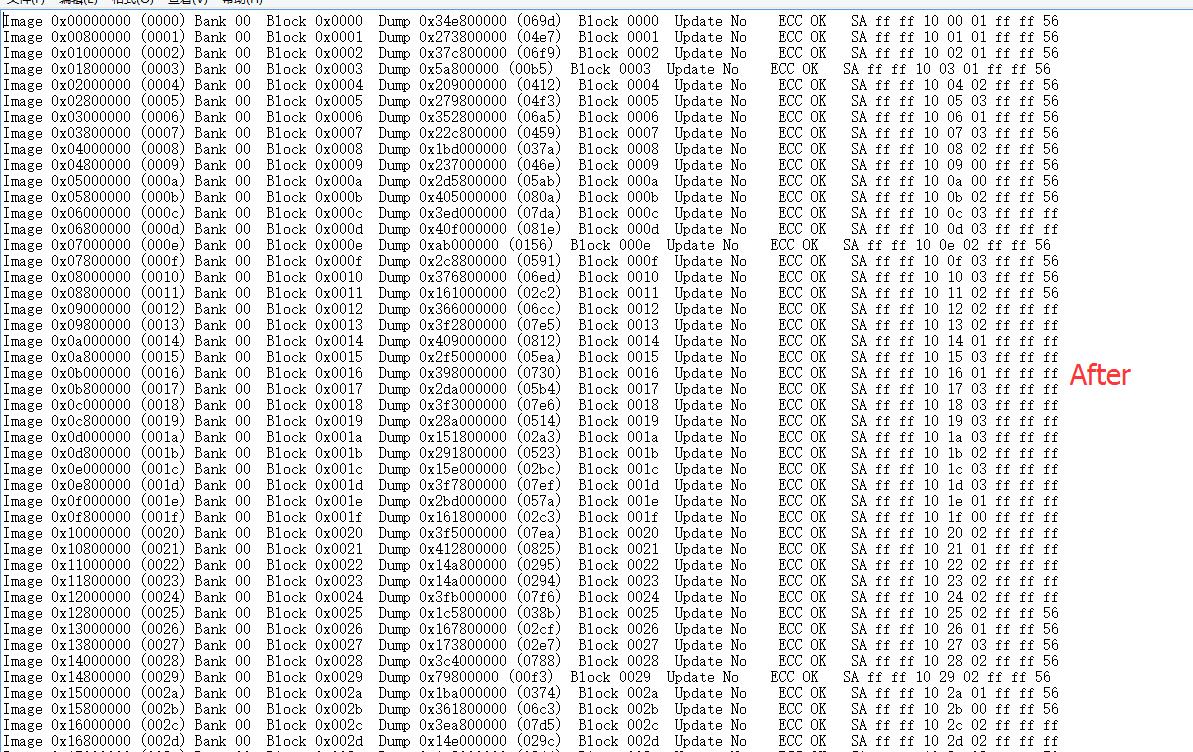

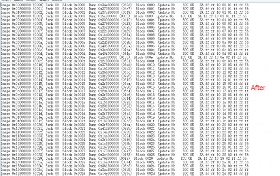

Some times NAND FLASH reader config if wrong , like this case .
I up some chips config you can testing.

Block not found is because the NAND controller either didn't write that block to NAND or the block assembler can't locate that block (eg: sometimes update blocks use a different XOR than committed blocks ie: Phison)).
Using a different NAND CFG shouldn't affect Block Not Found unless the block count on TLC NAND is wrong but that's rarely the case.
