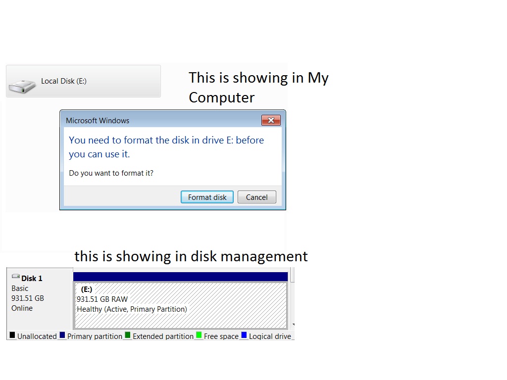

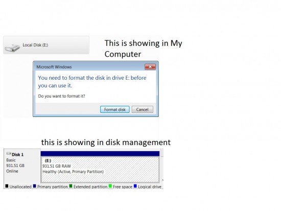

I have more than 700GB data on my flash drive and suddenly it's showing as and asking for format please support and suggest me. Thanks in advance

Hi, you should make a image of that flash drive and scan that with i.e Get Data Back or R-Studio.
You can do a image with Winhex or other imaging tool.

I get really worried when I see 1TB flash drive. In my experience I see very few people buy flash drives larger than 64GB UNLESS it is cheap from ebay.
Has your drive always transferred data on AND OFF the drive properly, and is there any chance it is a fake?
I have bought 32GB from ebay, and you can copy 29GB just fine, but you cannot get the data off - mainly because there is actually only an 8GB Memory chip in it and firmware on the flash drive lies to you.
Is it actually a flash drive or a USB 1TB external drive?
you might try running the free Partition Find and Mount, search for a partition, and if/when found - copy all files to a new drive.
Imaging is really the best option if possible, and doing data recovery on the image. Just depends on your circumstances and either how much your skillset carries you, or how well you would be able to follow along with help from the forum without messing the drive up.
If it is really important, then a DR place might not be too costly, and more chance of recovery

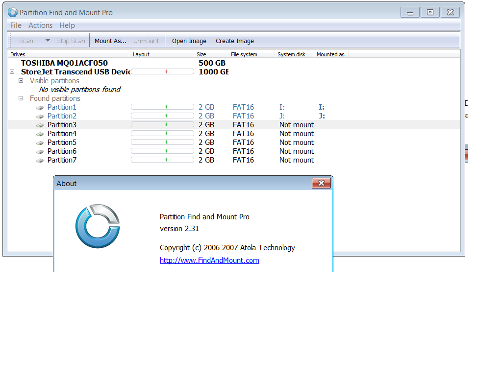

Dear HaQue,

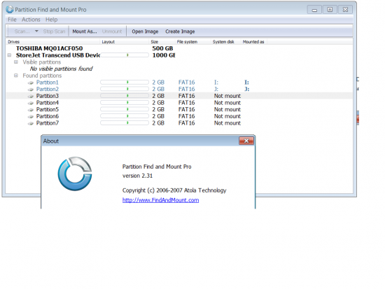

I have tried your recommended partion software and firstly i tried by "Fast scan" but it did not find any partition then i did "Full Scan" option and sleep. Now at morning i see resulting 7 partitions found 2G@FAT16. I checked by mounting 2 partitions but these are empty. I used 2.31 version. Please further suggest me what to do.Thank

I would image the whole disk (not partitions) and make sure the image is saved on another larger than 1TB drive of course. You can use PFAM to image. Then use data recovery software to recover files. R-Studio or GetDataBack.
The FAT16 partitions could be things like floppy images contained in files or other parts of internal files, and probably no use to you.

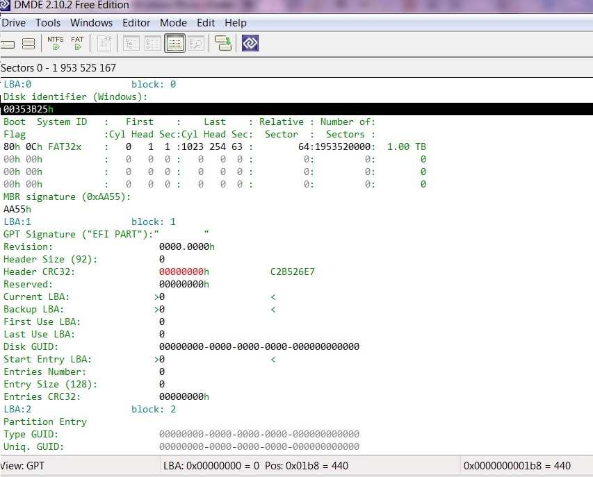

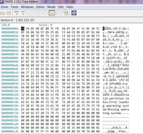

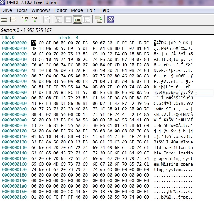

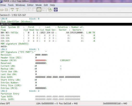

@fzabkar, i have tried both software's (dmde and and Hard Disk Sentinel) the Hard Disk Sentinel results are attached in rar. Please further suggest. Thanks

What do you see in sector 64?
What does DMDE's Partitions window find?
BTW, I notice a remnant of a GPT partition structure, albeit an empty one, in sector 1.
