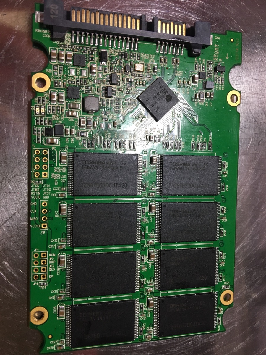

Hello!
Please, Show me on the pcb what points for safe mode? look photo

 Post subject: Re: SM2246XT
PostPosted: June 1st, 2017, 17:04
Posts: 17234
Here is a DIY development kit (US$22). Perhaps you could ask the seller for firmware and hardware development tools or documentation?
PostPosted: June 2nd, 2017, 14:30
Posts: 17234
You have shown us the JTAG port and a serial communications port. :?

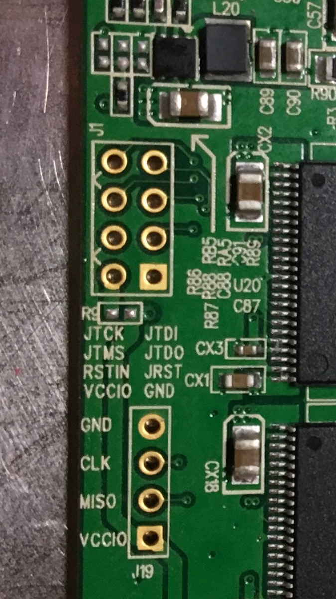

PostPosted: June 2nd, 2017, 16:01
Posts: 1060
img pcb ssd.tiff
Нет ничего невозможного
PostPosted: June 2nd, 2017, 16:13
Posts: 17234
The development kit has similar test points (ROM, ISP, HWP). These kits are useless without docs or software tools. That's why I suggested that the seller may have documentation that could help you.
PostPosted: June 2nd, 2017, 17:55
Posts: 17234
FWIW, SanDisk's Z400S SSD has a JTAG edge connector (J1) plus a single pair of ROM pads. Perhaps the ROM pads are the answer?
PostPosted: June 6th, 2017, 9:21
Posts: 1060
http://pc.zoznam.sk/plextor-m6v-vs-sandisk-z400s-aky-vplyv-na-vykon-ssd-ma-dram-cache?page=2
Thanks all helps!!
Sorry, Did not enter safe mode.
PostPosted: June 6th, 2017, 10:14
Posts: 1060
YES!!
CORRECT!!
THANKS!

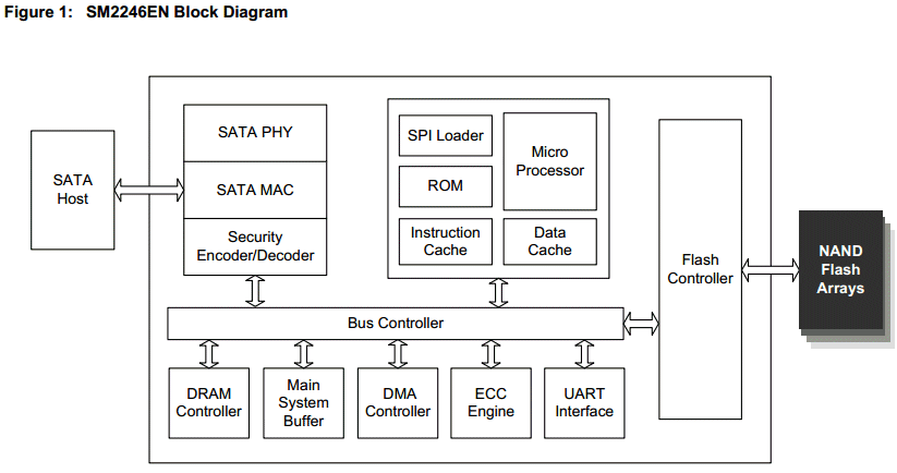

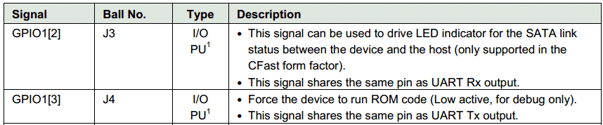

PostPosted: July 2nd, 2018, 17:45
Posts: 17234
SM2246EN_Datasheet_v03_20140117.rar
http://bbs.liangchanba.com/forum.php?mod=attachment&aid=MTI1OTZ8OGUzYjZlYzd8MTUzMDUxNTI4N3wwfDMxMTcx

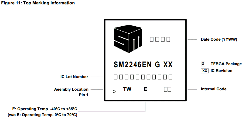

PostPosted: July 2nd, 2018, 18:14
Posts: 17234
Just FYI, Transcend's TS6510 controller is a rebranded SM2246XT (DRAM-less version of SM2246EN).
http://www.siliconmotion.com/A6.1.Detail_News.php?sn=184
The SM2246EN is an ultra high-performance and low power SATA 6Gb/s SSD controller supporting 1y/1z nm MLC NAND from all major NAND suppliers. ... The SM2246XT is a DRAM-less SATA 6Gb/s SSD controller ...
