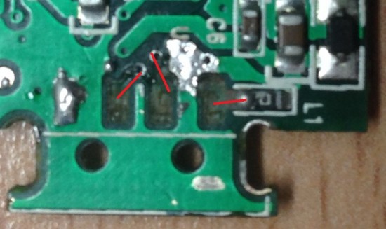

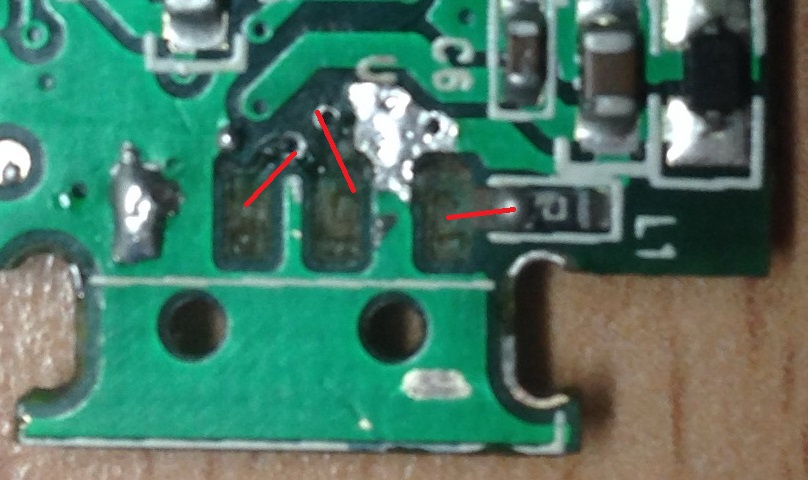

 Post subject: USB PCB pads ripped off, where can I make contact to (image)
PostPosted: June 15th, 2017, 10:06
Joined: March 6th, 2017, 15:27
Posts: 55
this PCB is missing 3 pads, where could I solder to instead ?
Any suggestions welcome
 Post subject: Re: USB PCB pads ripped off, where can I make contact to (im
PostPosted: June 15th, 2017, 11:46
Posts: 4010
think it is going to be like this. soldering to via's is better under stereo microscope.
PostPosted: June 15th, 2017, 12:50
If you can't get the solder to stick well to those divots that were pointed out already you can probably trace out where they pop out on the other side.
PostPosted: June 15th, 2017, 13:37
Posts: 55
thanks for your replies.
I scratched off the green stuff to reveal those tiny contacts, I tinned them and the wires and just about managed to get solid contacts onto them. I soldered the +5v onto the edge of the fuse and the ground onto the remaining pad. plugged it into an old XP dog and windows recognised it + the brand but thats all :(
on the back of the PCB, where the contacts are in the pic, is a big chip covering everything so I cant trace anything.
Almost got it, close but no cigar :?
PostPosted: June 15th, 2017, 14:06
If you can't get it and need a "chip off" then gimme a shout! :-)
PostPosted: June 15th, 2017, 15:23
No need for chip off in this case, it can easily be soldered.
Try using solid wires such as those in CAT5e cable. Dip the wires in flux, then tin them with a soldering iron and some 60/40 solder. Solder them first onto the USB port, plug that into an extension cable, then solder the wires to the board (that way you don't have to move it and have them pop off), and finally plug the extension cable into the computer. I do this all the time.
PostPosted: June 15th, 2017, 15:41
Posts: 17327
Doesn't this mean that the OP's soldering is OK and that the controller is not brain dead?
Furthermore, if there was a problem with the firmware, wouldn't the device ID as a generic USBest drive rather than the "brand"?
BTW, the PCB markings would suggest that the controller is a UT163-L4.
UT163 Enhanced USB2.0 Flash Drive Controller:
http://opendevices.ru/wp-content/upload ... _UT163.pdf
PostPosted: June 15th, 2017, 18:26
Posts: 4010
try using dmde to make an image of the device, then use software to recover from the image.
ignore all windows msg and just open dmde and see if the device shows in there. if you get I/O errors, your soldering may be ok, but other problems exist.
PostPosted: June 16th, 2017, 20:19
Posts: 4010
had a few lately with even less damage than that where soldering header back on didnt work. Remember most usb drives are 4 layers, and doesnt take much to damage something somewhere. also each component value is fairly critical, so a resistor or cap not at spec can also stop it working.
often the force required to rip the head off will lift one or more vbga pads, and that is pretty hard to diagnose. reflowing for the average joe isnt easy, likely to have a sea of caps and resistors floating off the board.
a decent DR Tool supported device can be solved in an hour, so while chip off might seem dramatic and less elegant, if you can do it, it is sometimes the easiest and quickest way.
if it recognised the brand, it should mean soldering to those points is ok, but some circuitry between controller or nand isnt kosher, or firmware issue or nand corruption.
