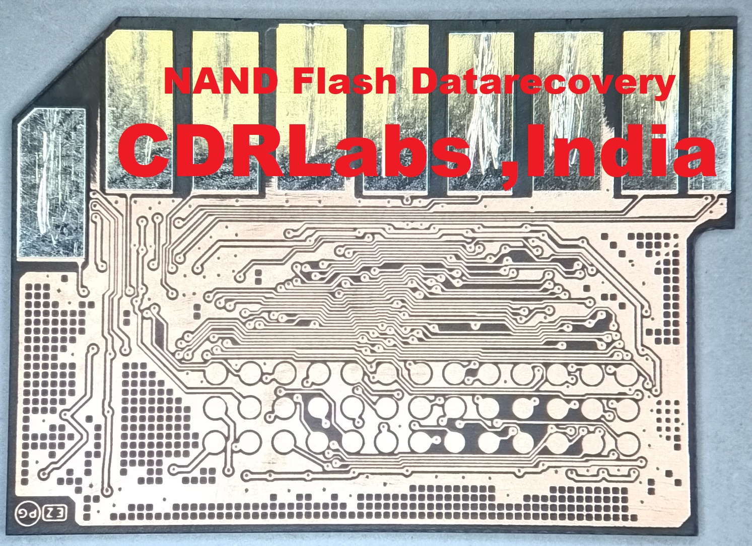

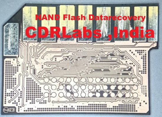

Hello Gurus ,
I Got a Sony 64GB SD Card " Monolith " . I Wired CH0 Up With PC3K Flash + Spider Adapter And See Two Crystals And Was Able To Read The Same Properly , If i Wire The PC3K Flash adapter to channel no 1 I can only read 1 crystal . Can you tell me if my wiring is wrong or the crystal is dead ? . And If i did not wire it properly how could it still identify Itself And Show Me Data Of 1st Crystal ;-( .I Spend a Lot Of Time On This Case Today ) . Which Signal Identify Second Crystal ,These are the Signals i wired
Data Signals - > D0,D1,D2,D3,D4,D5,D6,D7
Signal -> CE0 , RB , ALE ,CE1 , CLE , WE And RE " Is My CE1 Signal Not Working ;-(
GND/VCC - > Used From Main SD Card Pads Only
Device Is PS8210 And NAND Is 0x983A9493 76510000 " Dual Channel With 2 Crystals Each "
