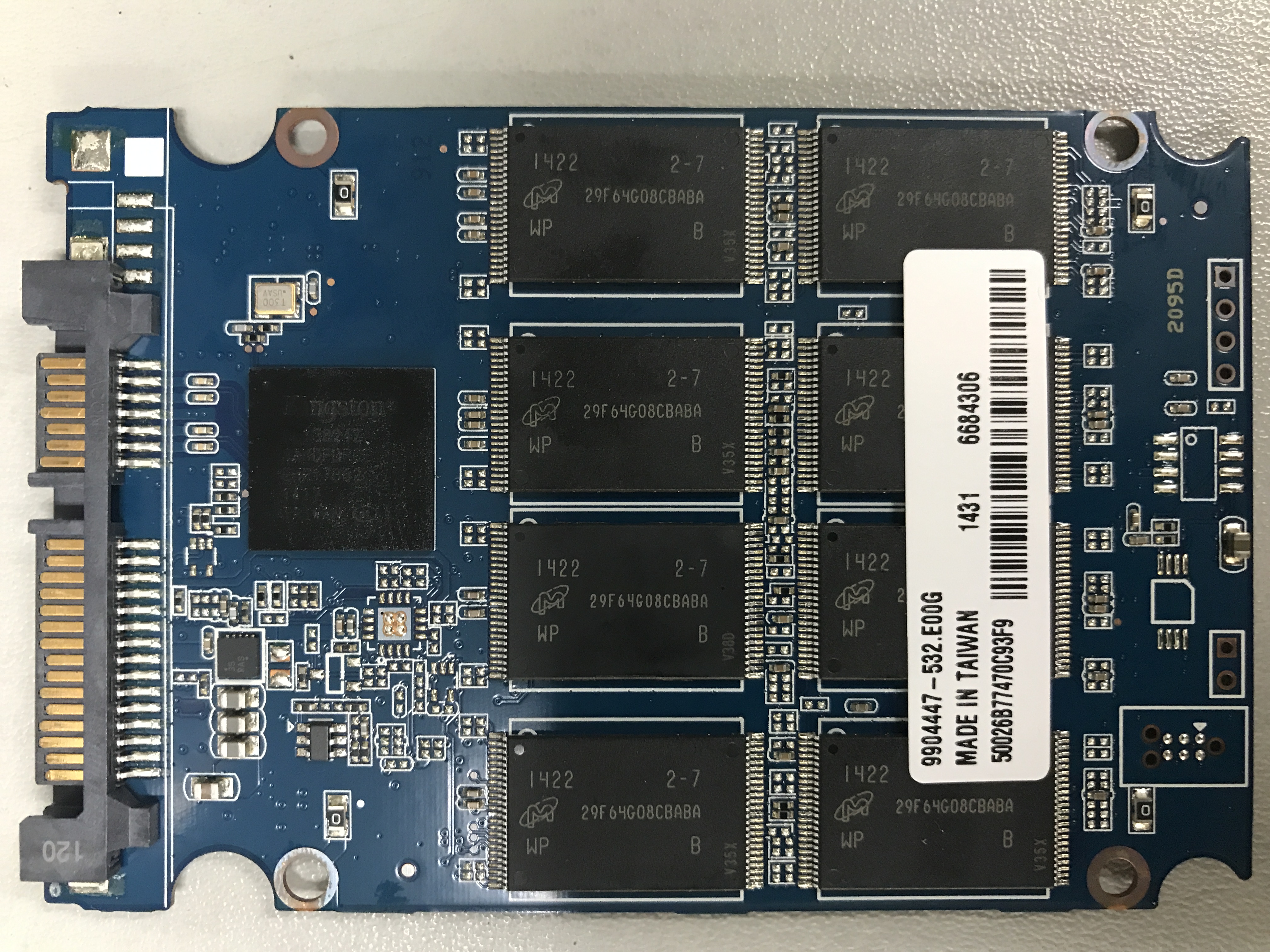

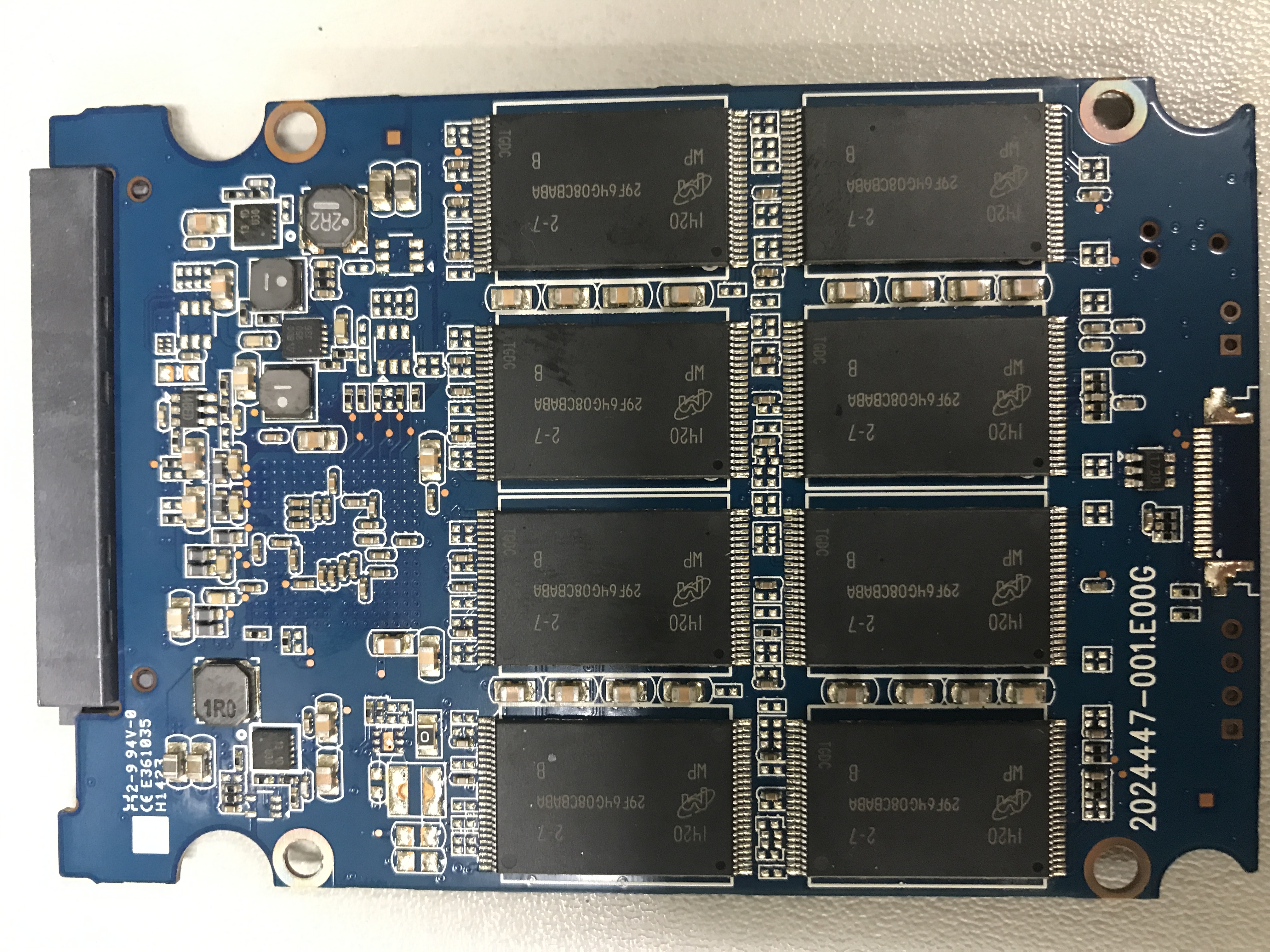

Kingston SSDnow 300 no Power at all, anyone worked on this problem before?
It seems it uses electronic fuse/protection?
Thank you

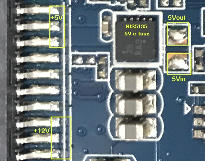

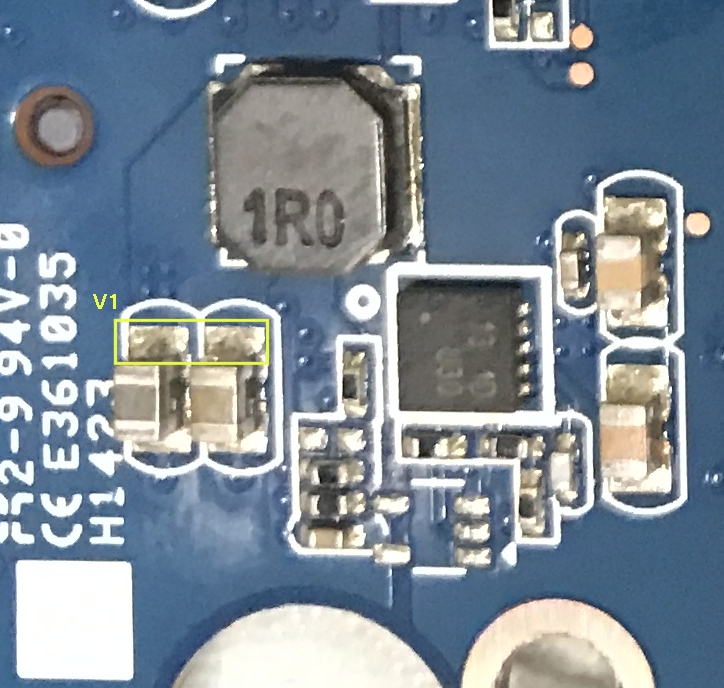

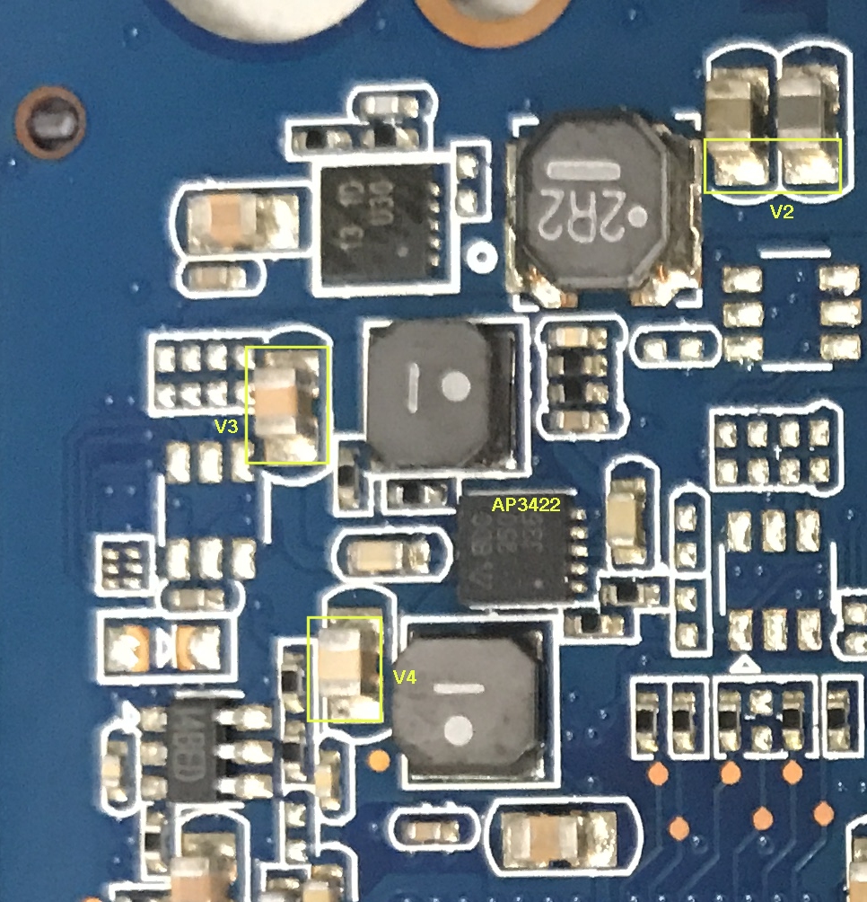

I would measure +5Vout, and V1 - V4.
The two ICs marked "13 1D U30" are equivalent to an APW8804.
The "|4BED" 6-pin IC is an MP6400DJ-01.
PCB protection devices - Electronic Fuse:
http://www.hddoracle.com/viewtopic.php?f=100&p=8872
NIS5135, ON Semiconductor, 3.6A 5V Resettable Electronic Fuse, marking 35:
https://www.onsemi.com/pub/Collateral/NIS5135-D.PDF
AP3422, BCD Semiconductor, Dual 1.1MHz, 800mA Synchronous DC-DC Buck Converter, 2.5V - 5.5V in, marking BDC, DFN-3×3-10:
http://www.bdtic.com/datasheet/diodes/AP3422.pdf
APW8804, Anpec, synchronous buck converter with high and low side MOSFETs, 3A, 2.6V - 6V in:
http://www.wpgholdings.com/uploads/bu/bu_3/20140917_Memory/APW8804a4.pdf
http://www.anpec.com.tw/ashx_prod_file.ashx?prod_id=687&file_path=20131024191901739.pdf&original_name=APW8804.pdf

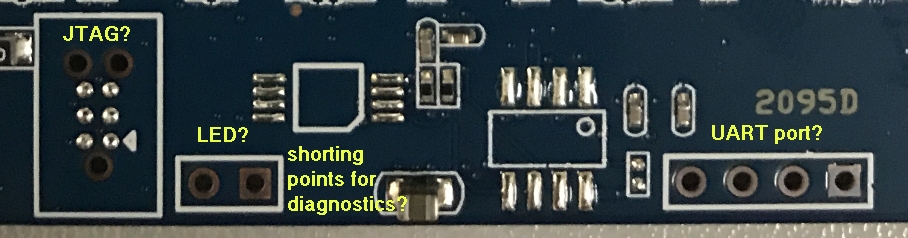

Here is my guess as to the function of the rear connectors:
Assuming the supplies test OK, I would first determine the ground pins. The UART port probably has a supply pin (+3.3V ?) in addition to RxD, TxD and ground.
I suspect that one of the two shorting (?) pins is grounded while the other could be connected to an R/B* pin of the NAND array, or perhaps to the controller via a dedicated pin.
